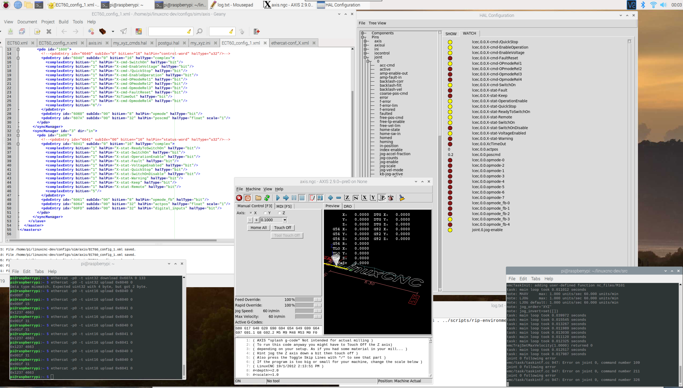

01 Jun 2020 15:58 #169715 by theshade
Dear Chimeno,
I am making good progress but the motor still does not move.
when I start linuxcnc the motor does get power and is locked into position.. it is very hard to move it by hand...
I read position from encoder it is 0.
the motor is in CSP mode 0x8
When I download a new position to 0x607A manually the motor does not move.
Same when I try to move the motor using the linuxcnc interface.
I can see the cursor moving on the 3d screen but the motor is always at 0
When I start linuxcnc and get in OP dmesg
reads this:

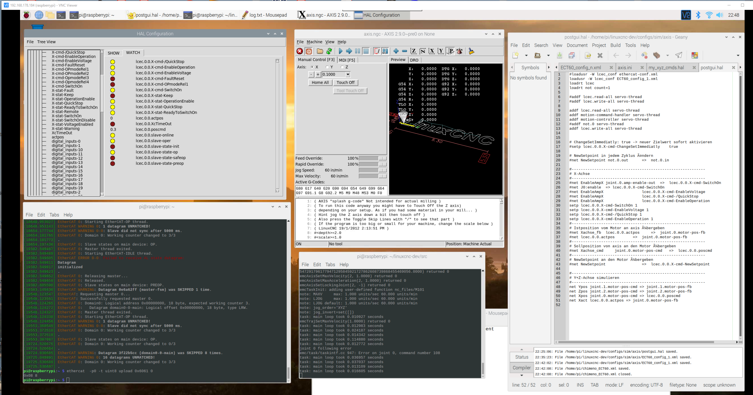

finally linuxcnc (2.9) wasn't happy with the hal command you gave me:
the hal wanted a command so I made a net..
from last message:
"Now we connect the signals ...
lcec.0.poscmd -> joint.0.motor-pos-cmd
lcec.0.actpos <- joint.0.motor-pos-fb"
so I modified to this:
net Ypos joint.1.motor-pos-cmd => joint.1.motor-pos-fb
net Zpos joint.2.motor-pos-cmd => joint.2.motor-pos-fb
net Xpos joint.0.motor-pos-cmd => lcec.0.0.poscmd
net Xact lcec.0.0.actpos => joint.0.motor-pos-fb
is it correct (what you meant?) or am I reversed with my arrows?
now it seems that when I start linuxcnc the motor turns on but when I try to move it
I get this
joint 0 following error
emc/task/taskintf.cc 947: Error on joint 0, command number 474
Also when I try to apply some force to the motor left or right from the stuck position, I see the encoder does work though..
So somehow it is not closing the loop on the position... do I need to set a speed for the CSP mode?
I thought updating position is enough.

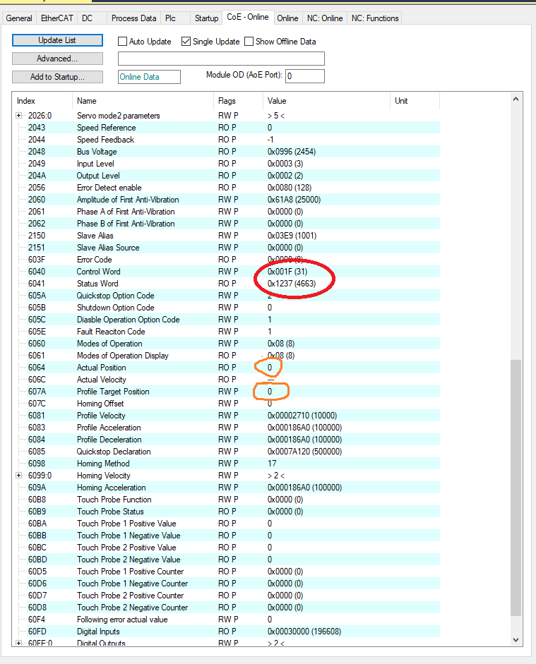

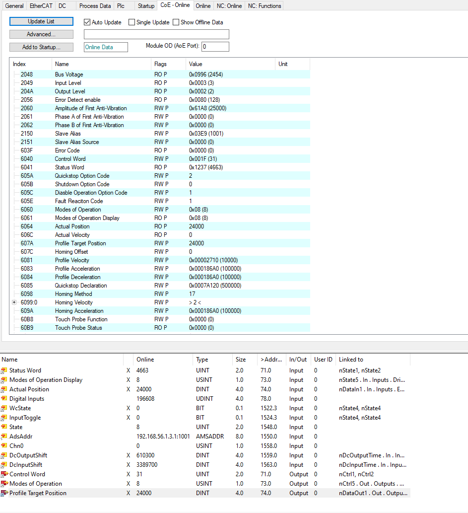

02 Jun 2020 17:32 - 03 Jun 2020 12:44 #169875 by theshade

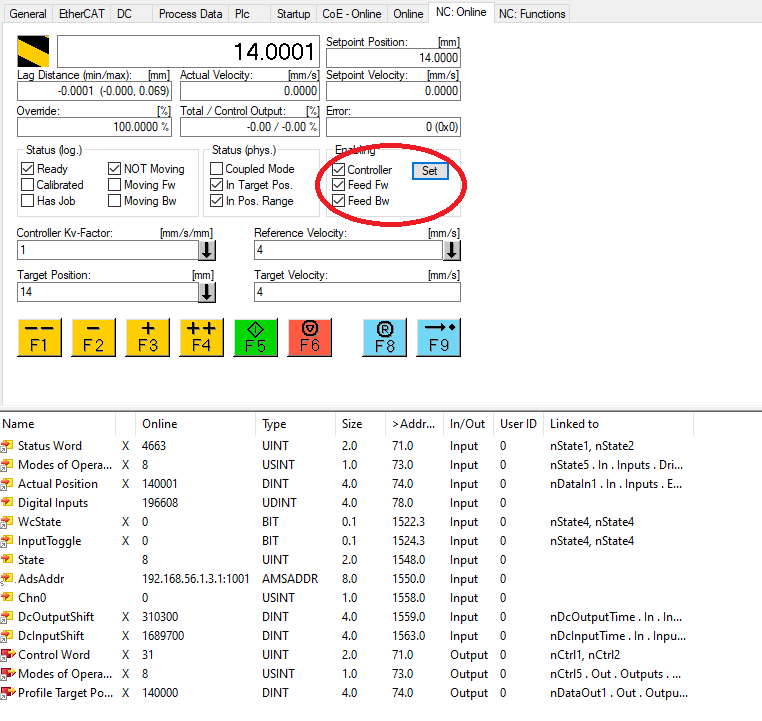

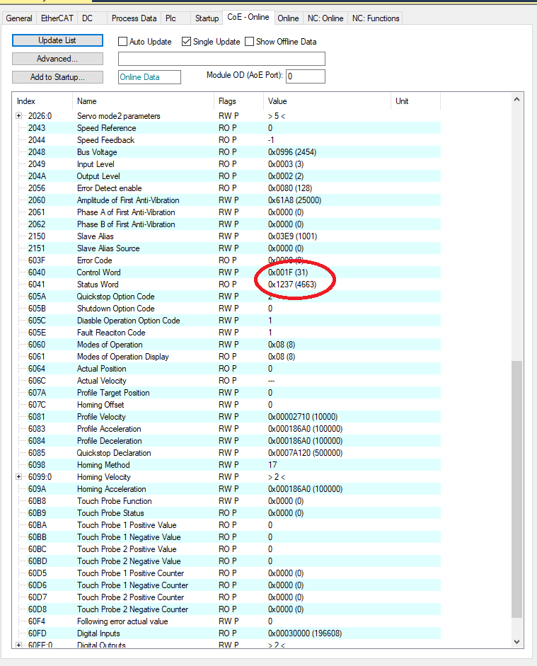

Yes the motor works fine in twincat3 when I use the "NC" controller in online mode it rotates, I can choose speed and everything is working great.
The values in 0x6040 and 0x6041 in TWINCAT are 0x1F and 0x1237 (see screenshot) when the NC controller is started
I do not understand why though it is not just 0x0F because in CSP the 0x10 bit is is not required according to manual

pi@raspberrypi:~ $ ethercat -p0 -t uint16 upload 0x6040 0
0x001f 31
pi@raspberrypi:~ $ ethercat -p0 -t uint16 upload 0x6041 0
0x1237 4663
pi@raspberrypi:~ $
Also it seems to me that all status including /Quickstop are good according to my current understanding of things:
I have tried setting 0x6040 from 0x06 to 0x0f and also from 0x06 to 0x1f multiple times. Because I think that in PP mode it is required to be switched for each new position.. but in CSP I believe it should stay at 1... (at least that is what I observe when it works in twincat)

03 Jun 2020 14:24 - 03 Jun 2020 14:52 #169980 by chimeno
Hi @theshade
If it is surely a small detail that does not leave you, meanwhile you can try another configuration mode, for example speed,
You can test the SYNC unit cycle at 1000us in TWINCAT and define the SYNC0 x 1 = 1000 us ?? if it works you can try this configuration.
<dcConf assignActivate="300" sync0Cycle="*1" sync0Shift="0"/>
In the screenshot that you show me these records are zero? why?

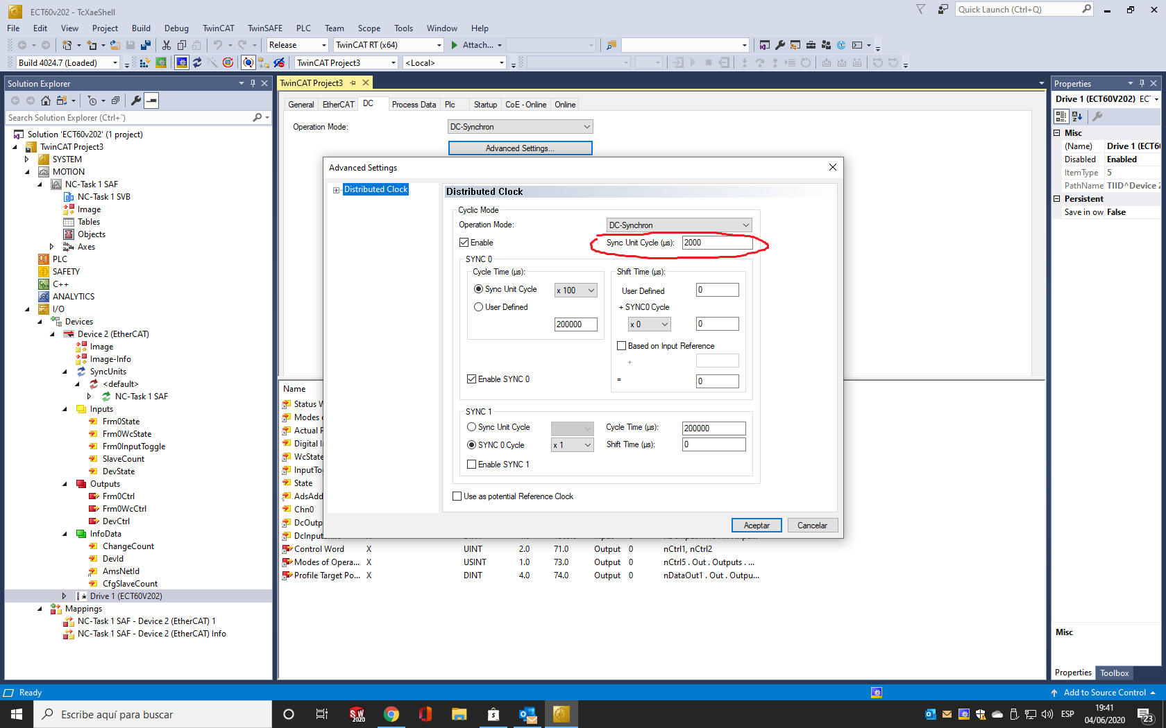

03 Jun 2020 16:29 #170015 by theshade
Dear Chimeno,
I tried the new dcConf you suggested but it doesn't seem to work
also when I try to edit the sync unit cycle to 2000us, but the field in the window would not let me change the value.
I suppose I would need to change it in the SDO somehow and save the value in the firmware of the driver?

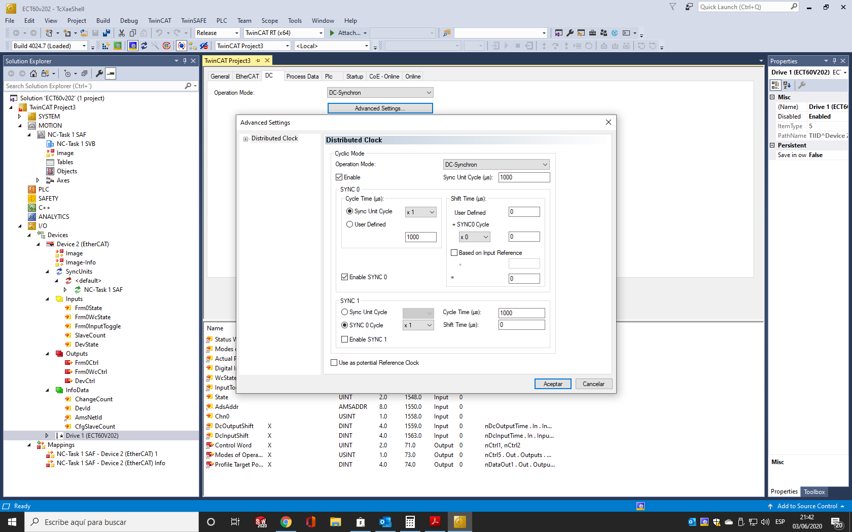

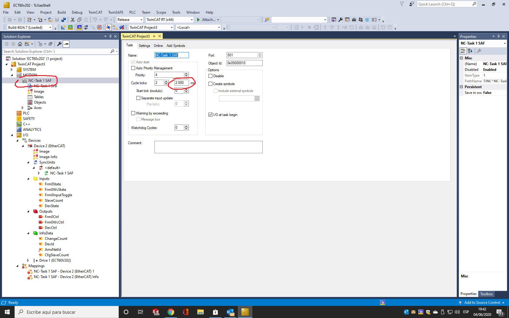

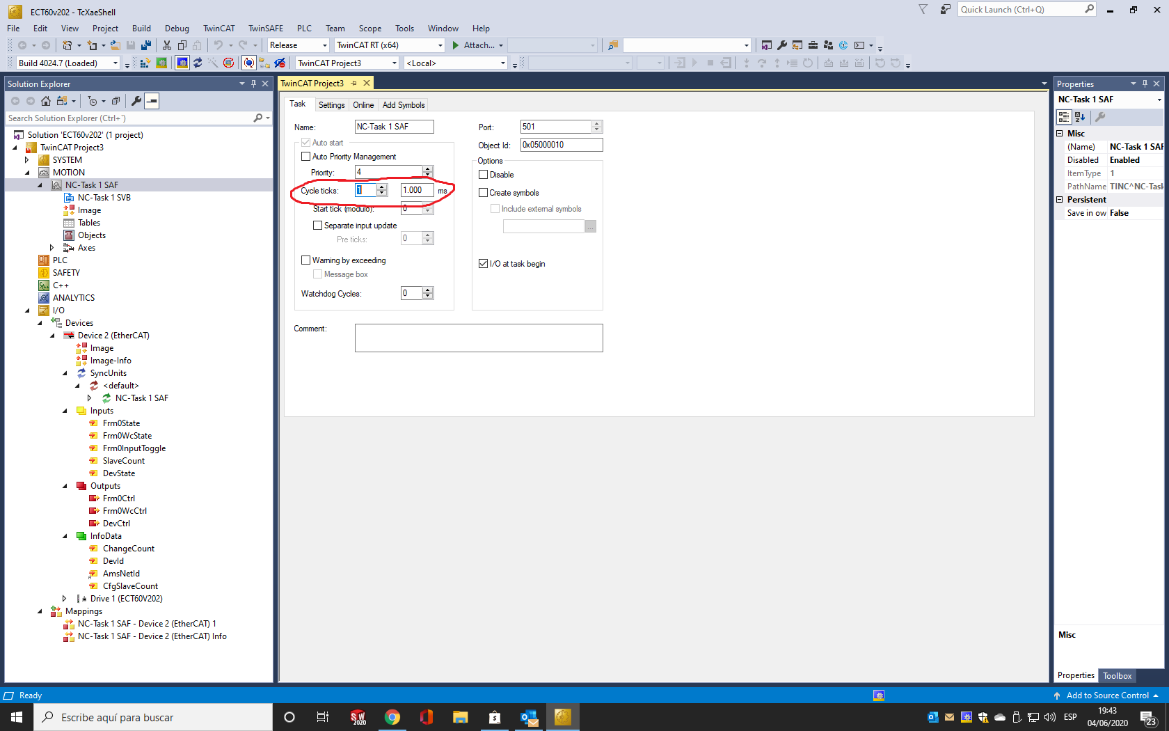

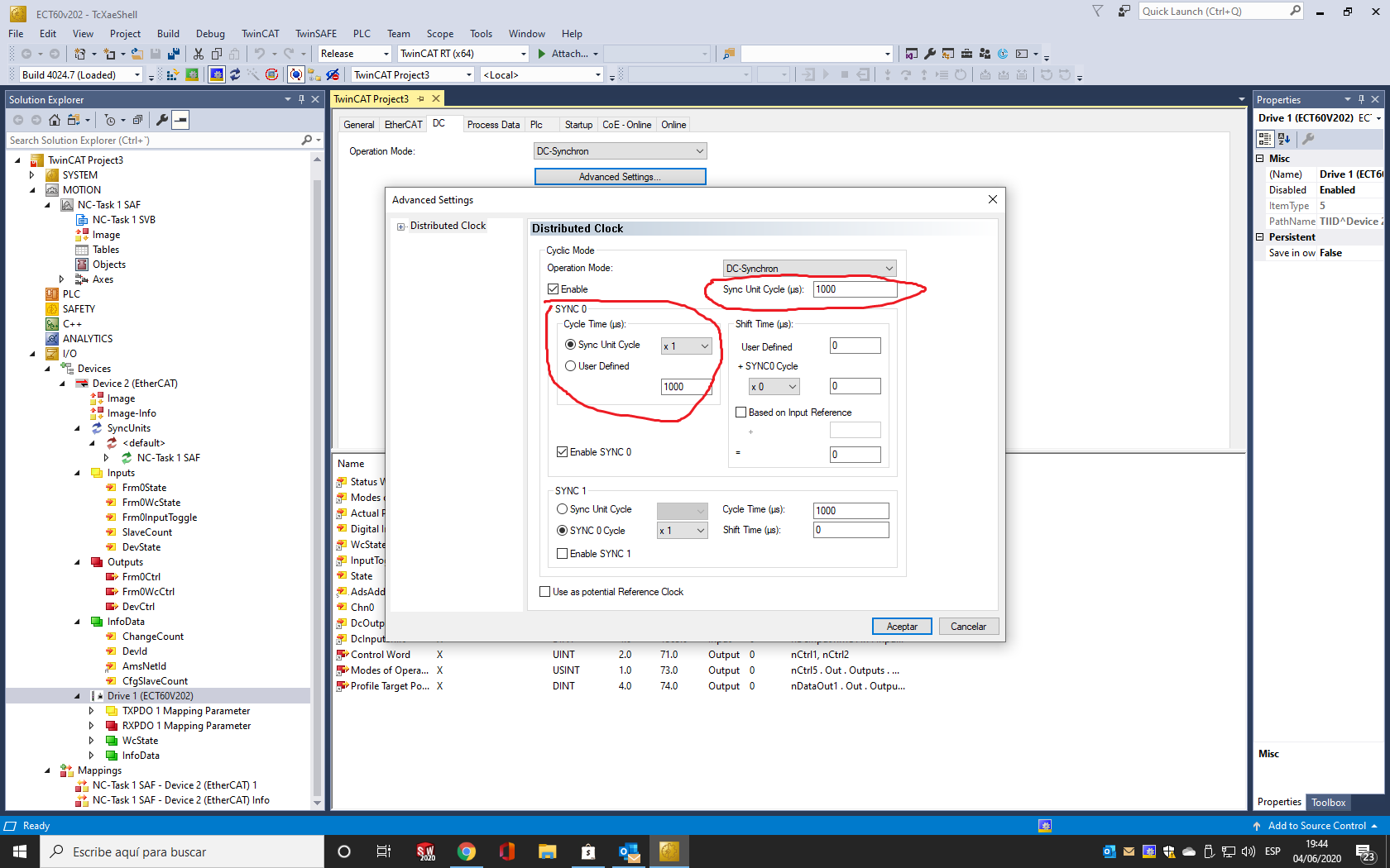

04 Jun 2020 13:03 #170112 by chimeno
Hi @theshade,
Here I explain how to change it through images that is much more intuitive
First I show you the DC tab where you have 2000us
now you have to go to the MOTION tab where we have the first TASK to 2000us
now we change it to 1000us
Now we go back to the DC tab of your device and automatically we have the value 1000us, now you just have to change the value of the SYNC0 in this case we multiply it x1 and reconfigure
You can also change the value and the different SYNC modes directly on the device, in the COE tab I cannot tell you where because I do not have the device and it does not allow me to see all the records although it is surely in 1C32 and 1C33, you also have to think that whenever the device is configured in linux, you usually have to do it before the device goes into OP mode and only send and receive data through PDOs.
I feel that I cannot be of more help,
Reguard
Chimeno
04 Jun 2020 15:05 - 04 Jun 2020 15:17 #170123 by theshade
Dear Chimeno,
Thank you so much...
I was able to change to 1ms and it works nice in twincat...
Also in twincat I have to enable controller+ feed FW + feed BW to make the motor move.
there is no such thing in linuxcnc?
I don't think there is more you can do indeed whithout a driver and hardware
And I don't really know how to thank you for all that... If you would ever come to Switzerland, I would be happy to offer you a good restaurant. Alternatively, if you need or would like something from here that I could ship, please let me know.
And of course, if I ever manage to make it work, I'll make sure to document the thing fully so newcomer (like me) with similar hardware can benefit of all this somehow.
