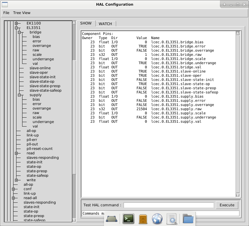

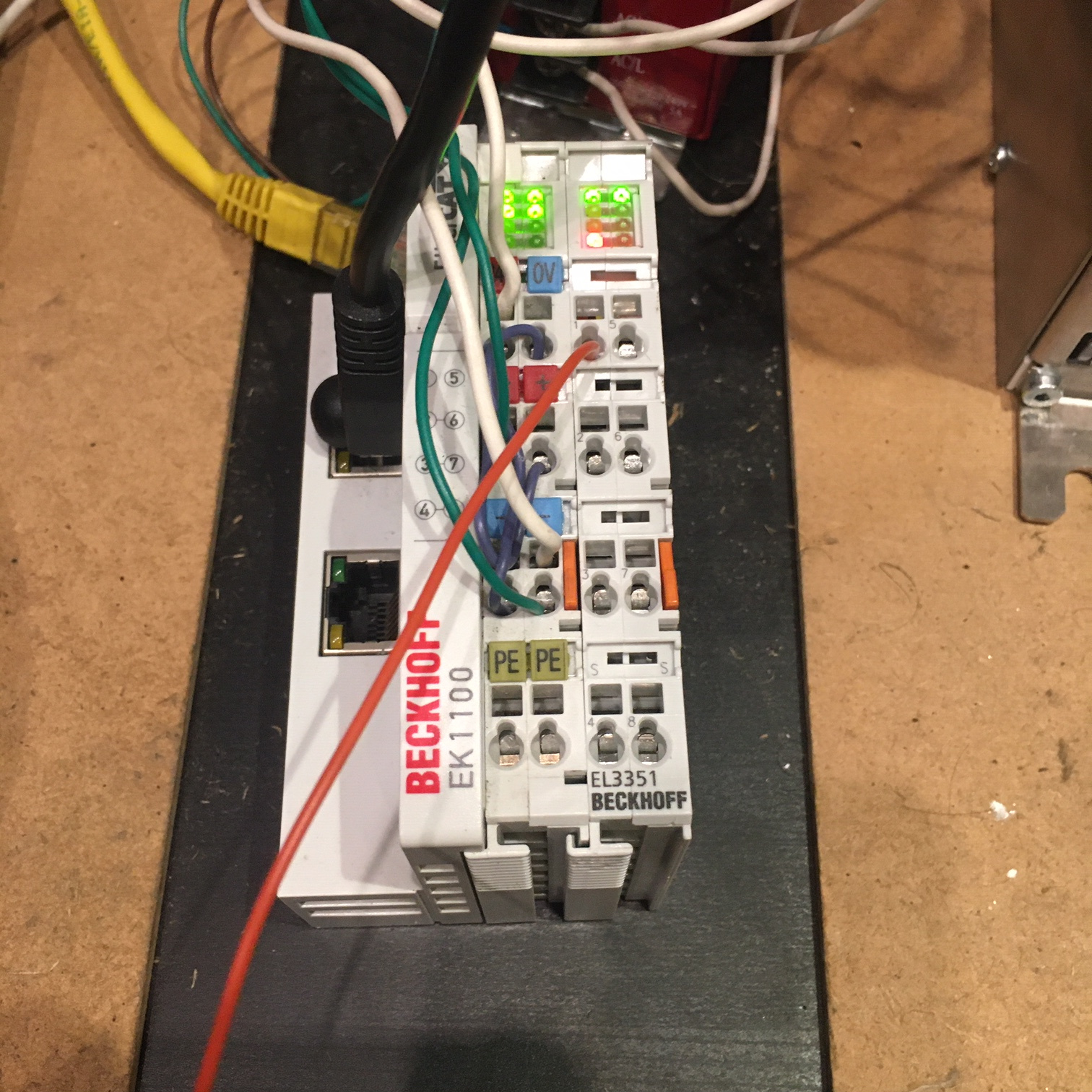

14 Oct 2020 15:16 - 14 Oct 2020 22:54 #186123 by chimeno
hi guys i just added the EL3351 module, as always the basics to make it work,
for you players!
Greeting
Chimeno
Last edit: 14 Oct 2020 22:54 by chimeno. Reason: Edit: Linuxcnc-EL3351
The following user(s) said Thank You: tommylight, besriworld, Nico2017, Grotius, CORBETT
