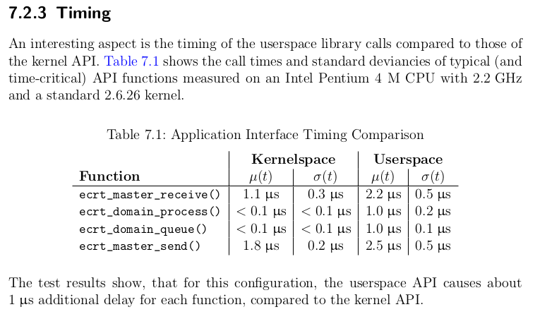

www.etherlab.org/download/ethercat/ethercat-1.5.2.pdf say on page 23:
It is not possible to use [the generic driver] in-kernel realtime extensions like RTAI with the generic driver, because the network stack code uses dynamic memory allocations and other things, that could cause the system to freeze in realtime context.
Do I need a 'real' driver to be able to run a axis in real time? How much slower is the generic driver?

07 Nov 2020 16:18 #188622 by Grotius
Replied by Grotius on topic Ethercat HAL driver
I remember a document where the timing details where provided.
You see, it's almost equal between userspace and kernelspace.
It's true you can not mix rtai (.ko) with the generic (.so) driver.
I think it's 2-5 nanosec slower if you take the 4 ecrt steps together.
