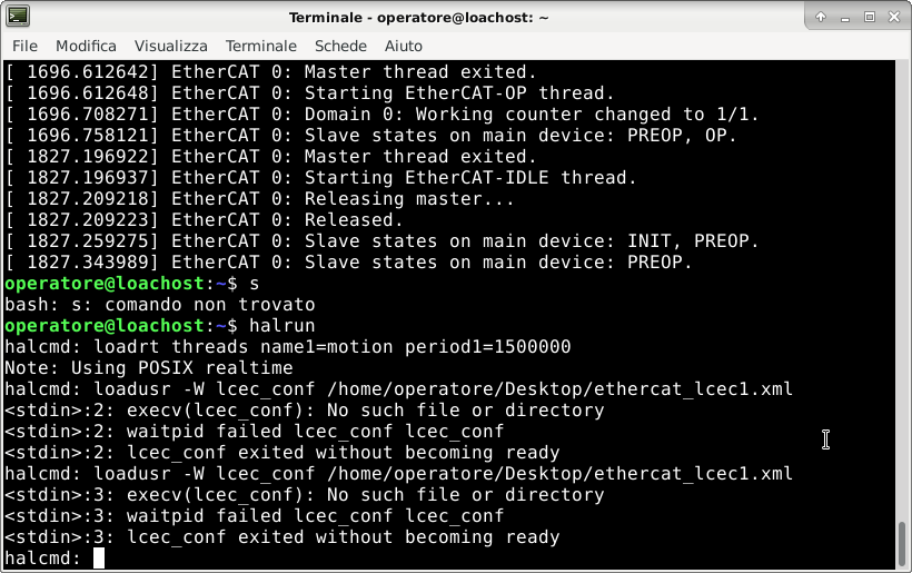

why in the terminal when I start halrun and load lcec it goes into error?
you have a link or file on how to write the xml file?

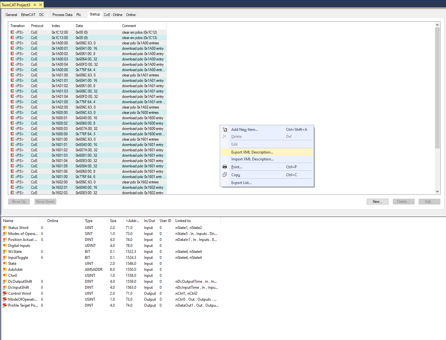

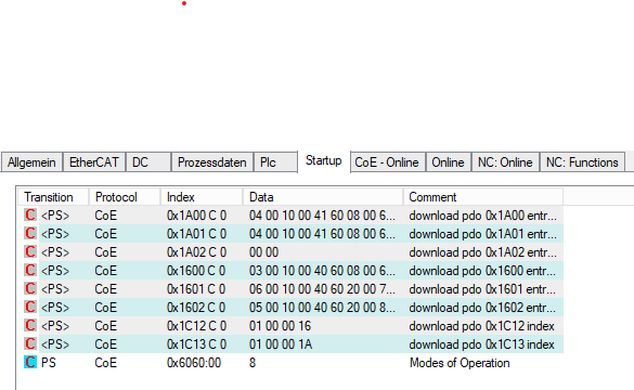

10 Dec 2020 12:11 - 10 Dec 2020 12:13 #191595 by jc2ktr
Dear @Chimeno,
I am still a little lost I think. I received the drives this morning and loaded the ECT60 description file in TWINCAT and I have managed to move the motors using the NC so this is good.
And I have a working config and pdo in twincat. It curently uses CSP (cyclic dynamic position mode). I tried to change to PP but it doesn't work when I do....
Now when I export the "startup" which is much more full of data...
it saves a very generic file with almost no info:
test.xml
File Attachment:
File Name: test.xml
File Size:0 KB
So I don't yet understand what I should export in xml from twincat..
Also I don't know how to export pdo's there is no export to xml in this window...
Sorry I can't understand what I need to do to export the two xml files from twincat...
I guess one is for PDOs and one for startup config.
1. Do I need to write the files by hand because export from twincat doesn't seem to work? Did you write the example files you sent me manually?
2. or how did you export them from twincat? Maybe I missunderstood and twincat is only for experimenting on the settings.
Thank you again so much in advance and sorry for being slow to understand.

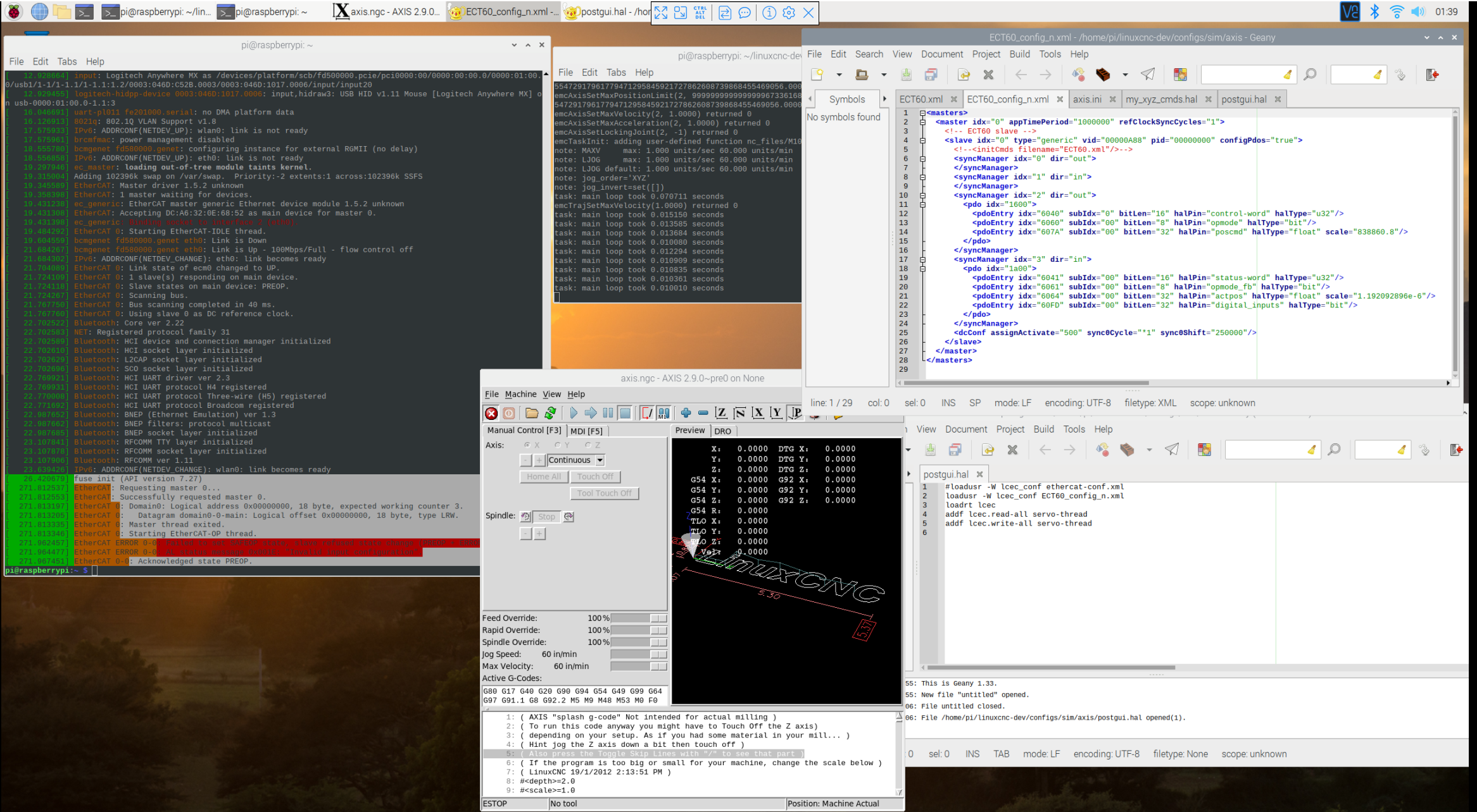

So I edited manually the .xml from my current understanding:
I only added the PDO with SM2 and SM3... I don't know really know if the others pdo idx are useful, nor the reason they exist in twincat.
So I loaded this xml in linuxcnc and after a few trials I still do get errors which are probably due to the fact that I don't really know what to put in the DC sync config and ref clock sync cycles...

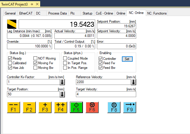

In twincat it seems to work at 2000us...

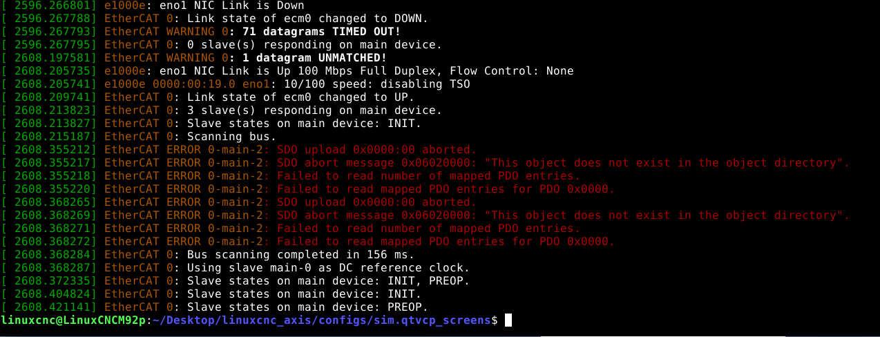

[ 2350.778194] EtherCAT WARNING: Datagram e64197b9 (master-fsm) was SKIPPED 1 time.
[ 2385.334576] EtherCAT: Requesting master 0...
[ 2385.334592] EtherCAT: Successfully requested master 0.
[ 2385.335248] EtherCAT 0: Domain0: Logical address 0x00000000, 18 byte, expected working counter 3.
[ 2385.335256] EtherCAT 0: Datagram domain0-0-main: Logical offset 0x00000000, 18 byte, type LRW.
[ 2385.335411] EtherCAT 0: Master thread exited.
[ 2385.335422] EtherCAT 0: Starting EtherCAT-OP thread.
[ 2385.335562] EtherCAT WARNING 0: 1 datagram UNMATCHED!
[ 2385.494210] EtherCAT ERROR 0-0: Failed to set SAFEOP state, slave refused state change (PREOP + ERROR).
[ 2385.496263] EtherCAT ERROR 0-0: AL status message 0x001E: "Invalid input configuration".
[ 2385.500254] EtherCAT 0-0: Acknowledged state PREOP.

In TwinCAT 3 i am able to move the drive in the NC:TASK but i don´t get it to work with LinuxCNC.

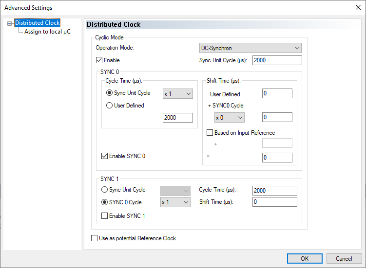

in TWINCAT3 you have enabled the "distributed clock"
in your .xml file you don't have the line
<dcConf assignActivate="300" sync0Cycle="*1" sync0Shift="0"

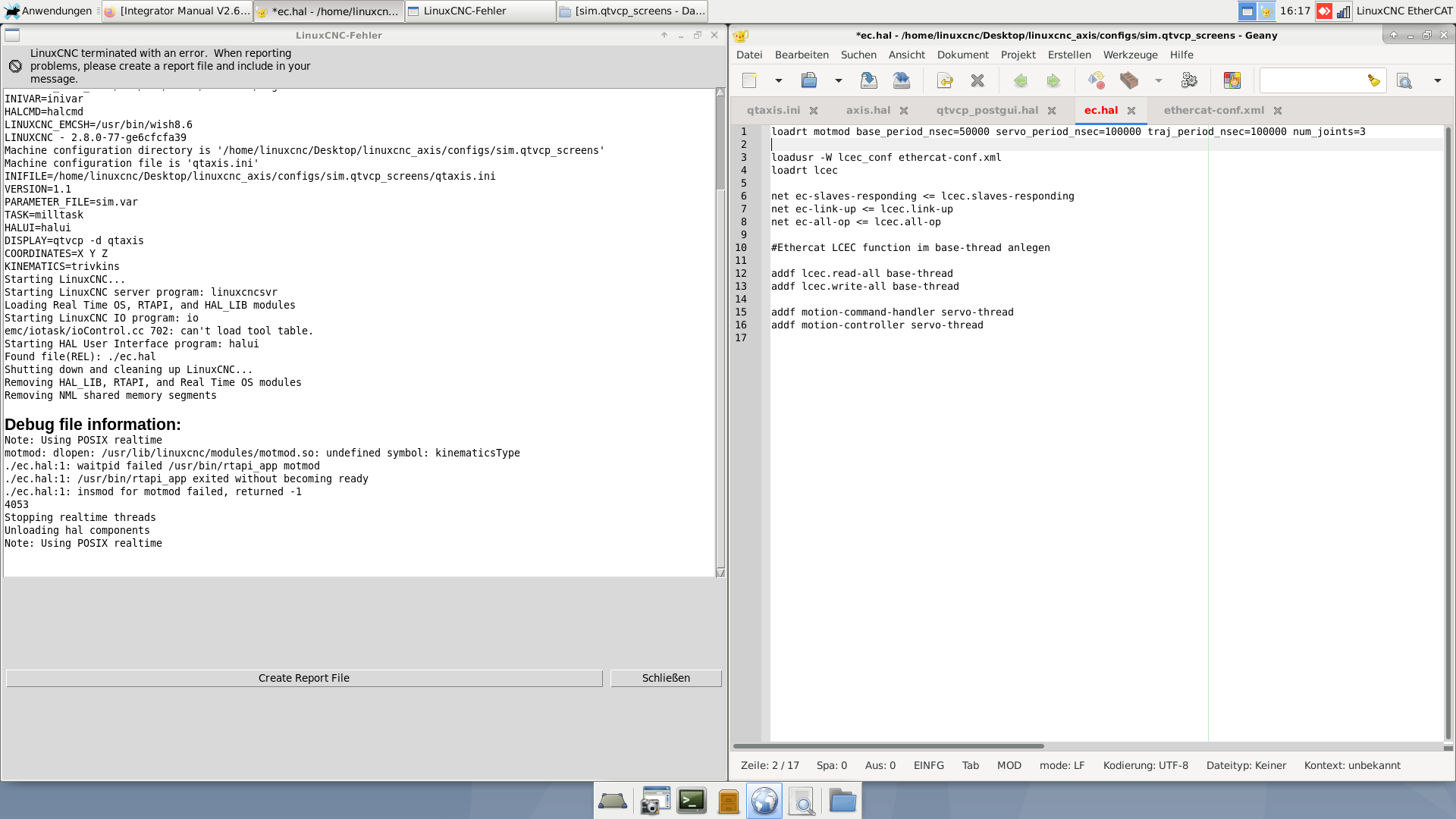

I edited the hal files to my needs, but i can't Start it it gives me following error on Startup.

after i did a dmesg i got this, see attached image(s)

1- error motmod: dlopen: /usr/lib/linuxcnc/modules/motmod.so: undefined symbol: kinematicsType
something seems to be wrongly compiled, you still have to compile linuxcnc again without ethercat configuration, if linuxcnc starts correctly, go to step 2

#1 the motmod.so error was my faul, i missed to write the: loadrt [KINS]KINEMATICS entry in my .hal file :S :whistle:

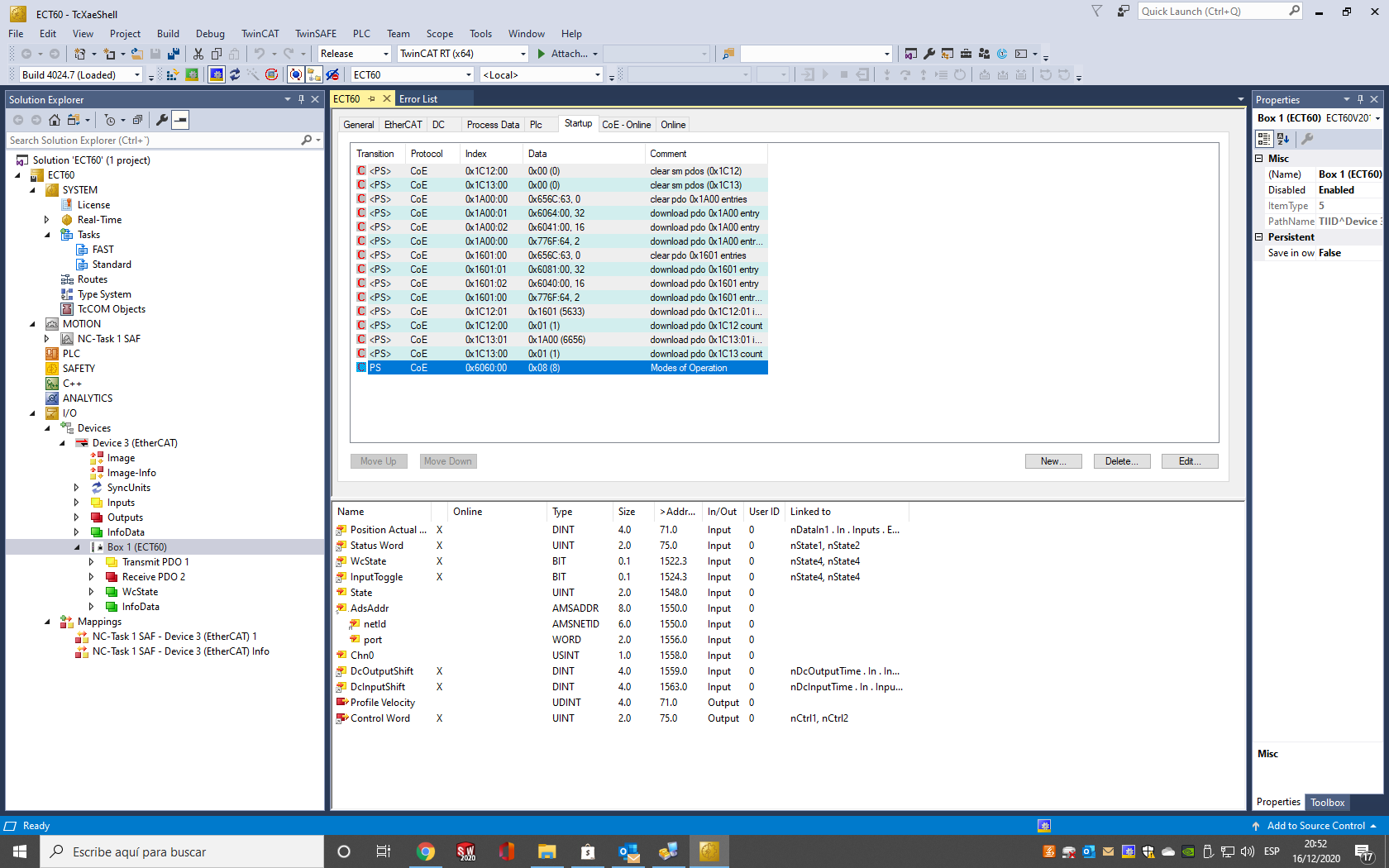

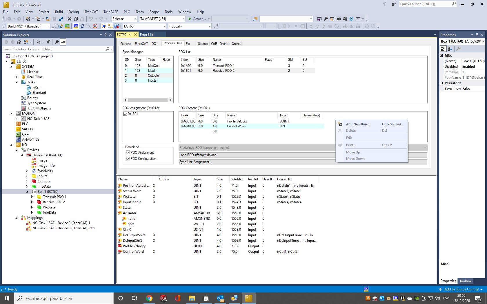

16 Dec 2020 13:53 #192173 by chimeno
Hello @jc2ktr,

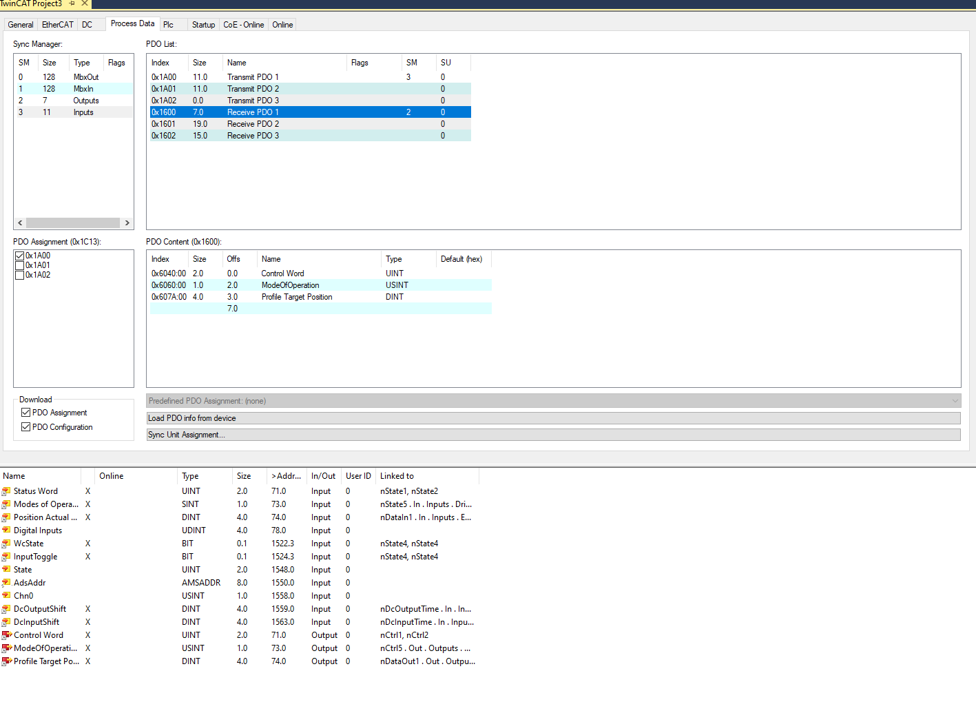

Well, the first thing is to reconfigure the driver in TWINCAT3, that it works in OP and you can move the engines, I attach the program in TWINCAT3 with the modified PDOs according to linuxcnc-ethercat, now you will have to configure the rest yourself, compare and see if you help.
I attach an image of where to change the PDOs, if you change the operating mode you will also have to change them.
I attach an image of where you have the configuration in blue, it is configured in mode 8, (position) you will have to read the manual to see the different modes to see which one interests you the most

Hello @jc2ktr,
Greeting
Chimeno
Hello @ Chimeno,
i´ve tried today to get my Drive in OP-State under Linux without Succes :(
I opend your TwinCAT Project and tried to Compare it with mine, which i will add to my Post also.
What i don´t understand at the moment is, do i have to add every single PDO entry to the PDO Content list in TwinCAT which i want to use under LinuxCNC? For Example the ControlWord includes more than one entries. Do i have to add every single one to the list?
The at the moment Preferred mode is #8 The CSP-Mode. At the moment it is more important that the configuration works somehow.
In the long term i will then See if its suitable.
