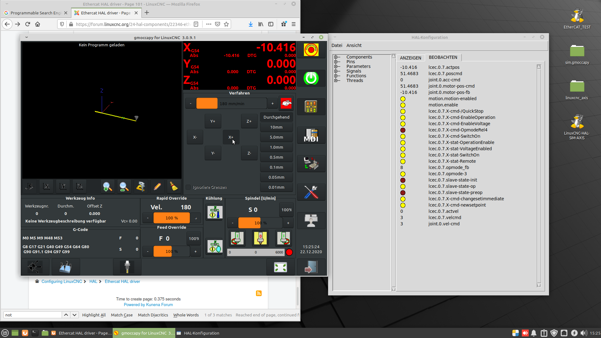

21 Dec 2020 14:56 - 22 Dec 2020 08:33 #192702
by jc2ktr
Thanks a lot @Chimeno,
i will try it tomorrow, because my LinuxCNC EtherCAT testbench is in my Office/Workshop
12/22/2020 another day, i changed the signals as above but, problem is still the same, the drive is enabled, and in OP mode but my drive moves not. even if a target position and velocity signal is send to the Drive, i changed my XML further like the one from @MRBaird, when i jog the Axis the commands are sent but no movement occurs. i added a Image where the halshow is online.

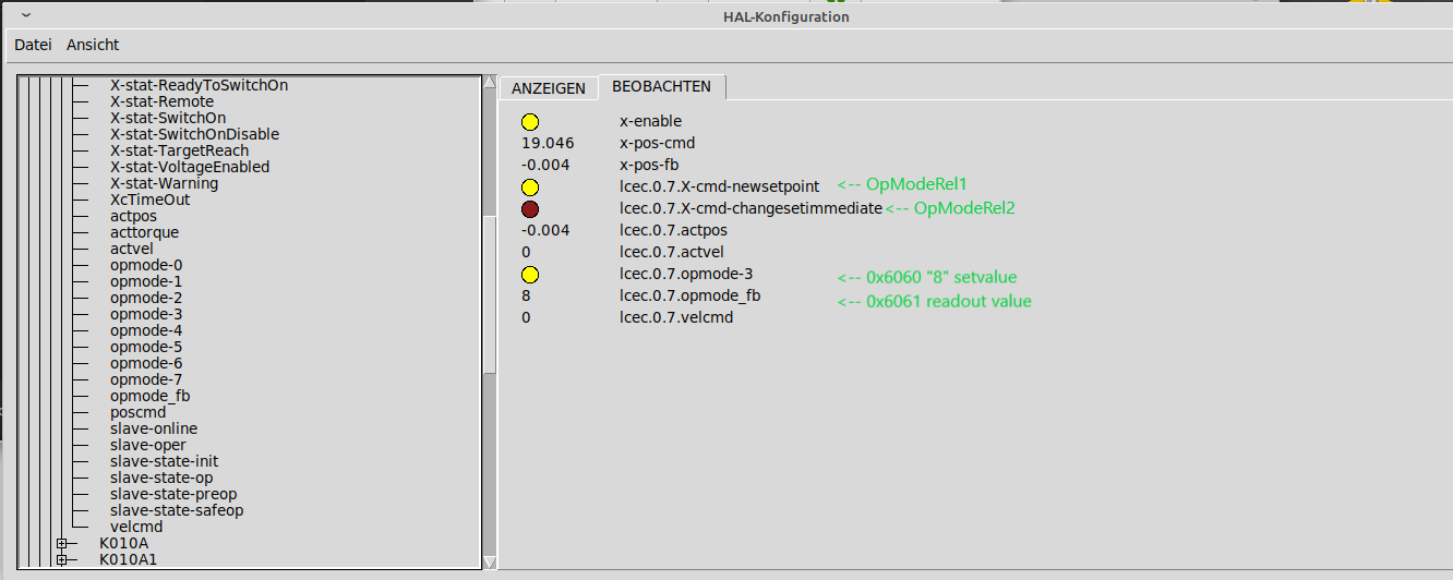

23 Dec 2020 14:11 - 23 Dec 2020 14:36 #193014
by jc2ktr
The lcec.0.7.opmode 8 is set in the custom_postgui.hal under only under another name setp lcec.0.7.opmode-3 true
its defined in the ethercat.xml <pdoEntry idx="6060" subIdx="00" bitLen="8" halPin="opmode" halType="bit"/>
the other one i must have missed in my config, though i dont really know what it does at the moment.
addition
the setp lcec.0.7.X-cmd-OPmodeRel1 1 < i have renamed it as i added some changes from MRBaird
addition 2
is it possible that the drive does not move because the joint.0.acc-cmd does not change its state it remains allways 0 when i jog the axis
