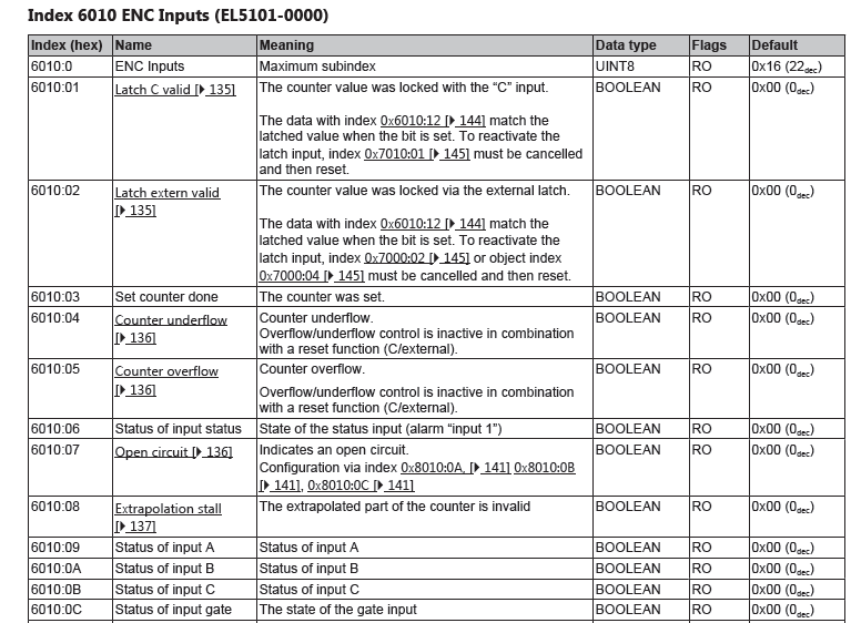

Way back in April 2020 there was some discussion about the EL5101 incremental encoder. I have finally got around to hooking mine up and I am happy to say that it worked perfectly out of the box. However, I am running the encoder on the spindle of the lathe and I need to be able to monitor the index pulse in order for linuxcnc to synchronise motion while threading.
According to the manual (pg 144) the status of A,B and C inputs can be monitored via 0x6010:09, 0x6010:0A, and 0 x 6010:0B . Is it possible to add these pdo's either by twincat or by modifying the el5101 source file?

The EL5101 driver created by linuxcnc-ethercat does not work with the pulse signals A, B, C directly from the device but a counter is created by software, I think you also have an index pin, I attach a register that creates the driver EL5101
hal_bit_t *ena_latch_c;
hal_bit_t *ena_latch_ext_pos;
hal_bit_t *ena_latch_ext_neg;
hal_bit_t *reset;
hal_bit_t *inext;
hal_bit_t *overflow;
hal_bit_t *underflow;
hal_bit_t *latch_c_valid;
hal_bit_t *latch_ext_valid;
hal_bit_t *set_raw_count;
hal_s32_t *set_raw_count_val;
hal_s32_t *raw_count;
hal_s32_t *raw_latch;
hal_u32_t *raw_frequency;
hal_u32_t *raw_period;
hal_u32_t *raw_window;
hal_s32_t *count;
hal_float_t *pos_scale;
hal_float_t *pos;
hal_float_t *period;
hal_float_t *frequency;

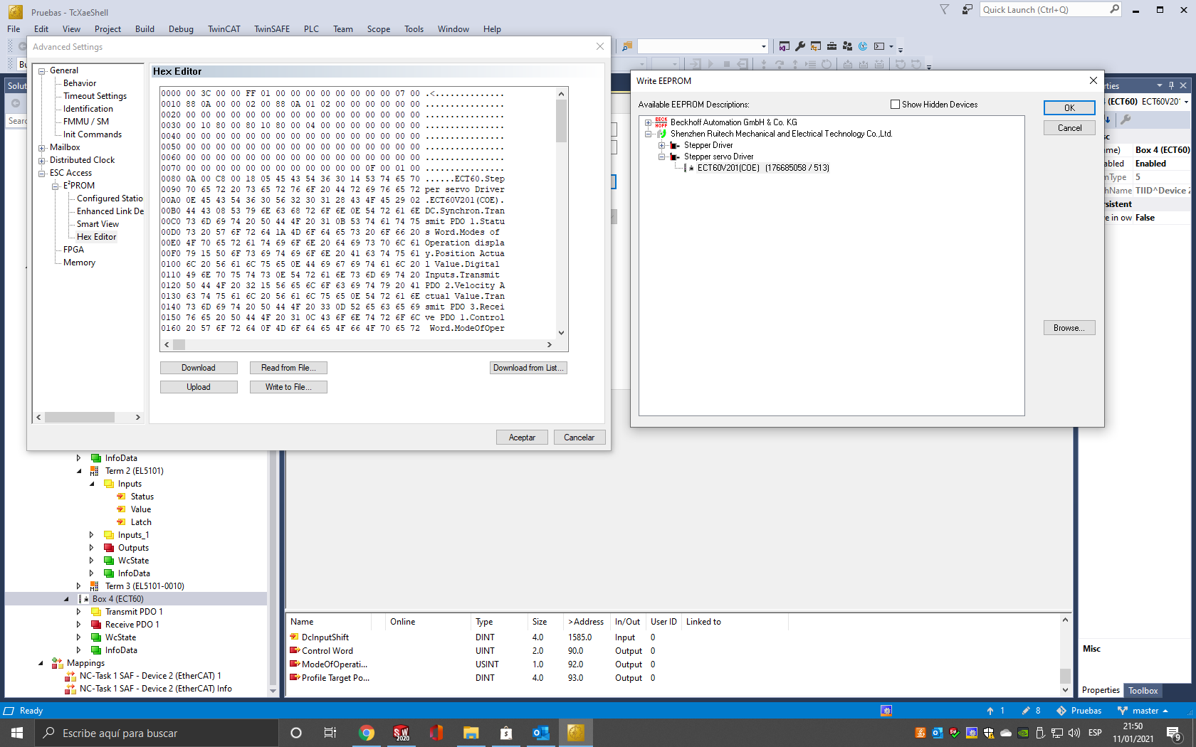

Hello @bkt
If you have problems with the device signals or missing registration, you can ask the manufacturer for an update and then record a new firmware using TWINCAT3, I hope it works for you soon

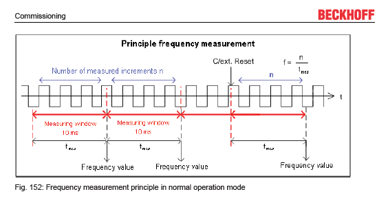

Yes, the encoder is updated at a much faster rate internally. By scaling the frequency appropriately, velocity in rpm or rev/s can be calculated quite easily...or at least close enough for the spindle. I was all messed up in the scaling :silly:
This satisfies the first requirement for coordinated motion,
net spindle-velocity encoder.3.velocity => spindle.0.speed-in
linuxcnc.org/docs/2.8/html/examples/spin..._synchronized_motion .
Chimeno, you are a very skilled wizard that knows what he is doing, I do not. So at this point, I am not sure if I am willing to risk bricking the terminal by rewriting the eprom. I'm going to see if I can figure out how to satisfy
I think I was wrong in my last post, the EEPROM topic is for the user @bkt, you don't have to reprogram the eeprom for that.
