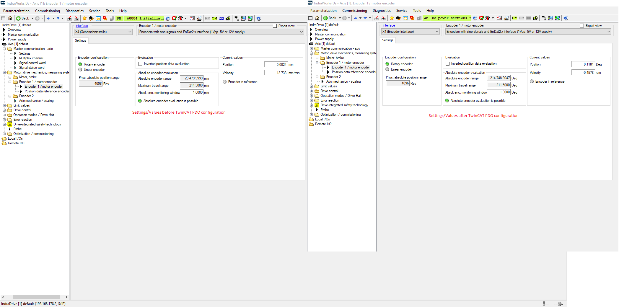

Hi folks,
#does someone have the original Bosch-Rexroth XML Description for TwinCAT? The one i can download from the Rexroth page does #not support the firmware of my drive. The drive is FW version 18V34 and the downloadable XML is for 20V26.
#Unfortunatley Rexroth does not have an Donwload Archive on their Website.
#And my Servomotor is not supportet by the new Firmware version.
I think you would have to send an email to the Bosch company to see if they can send you the file.
Greeting Chimeno

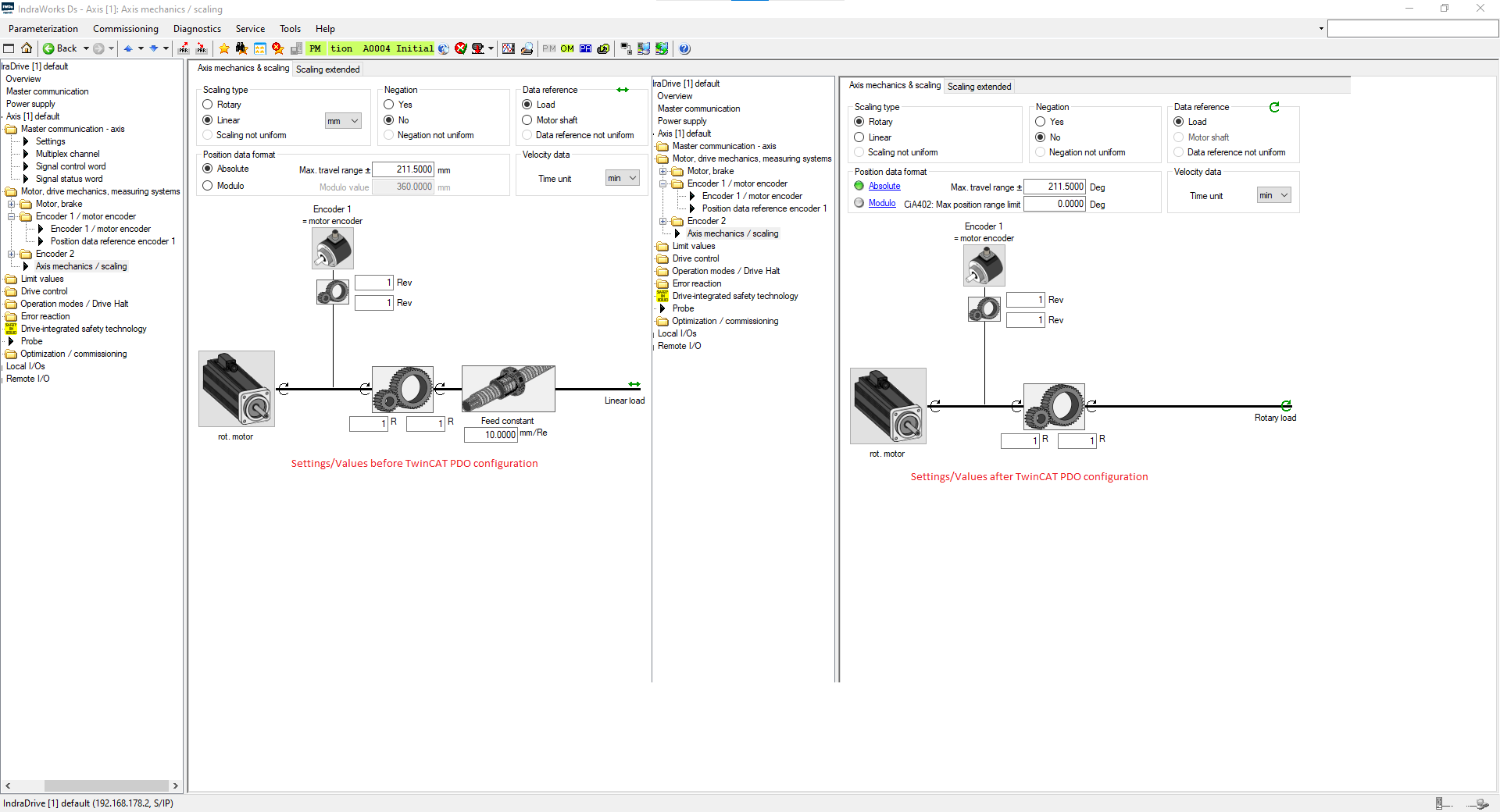

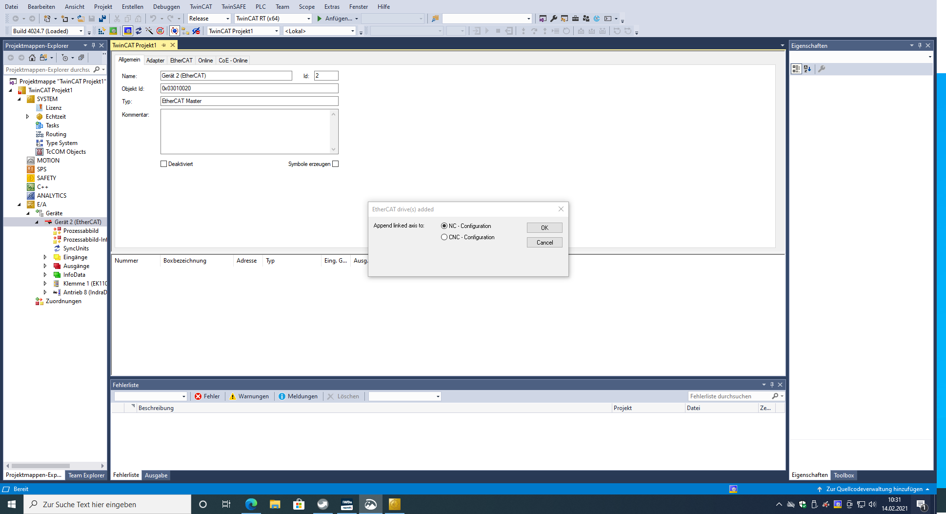

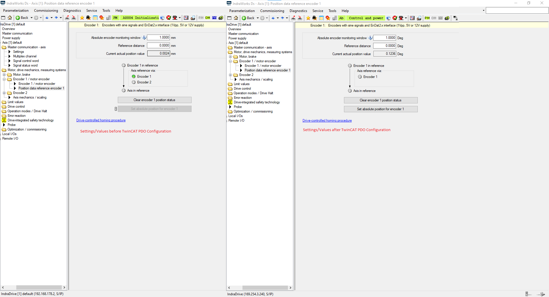

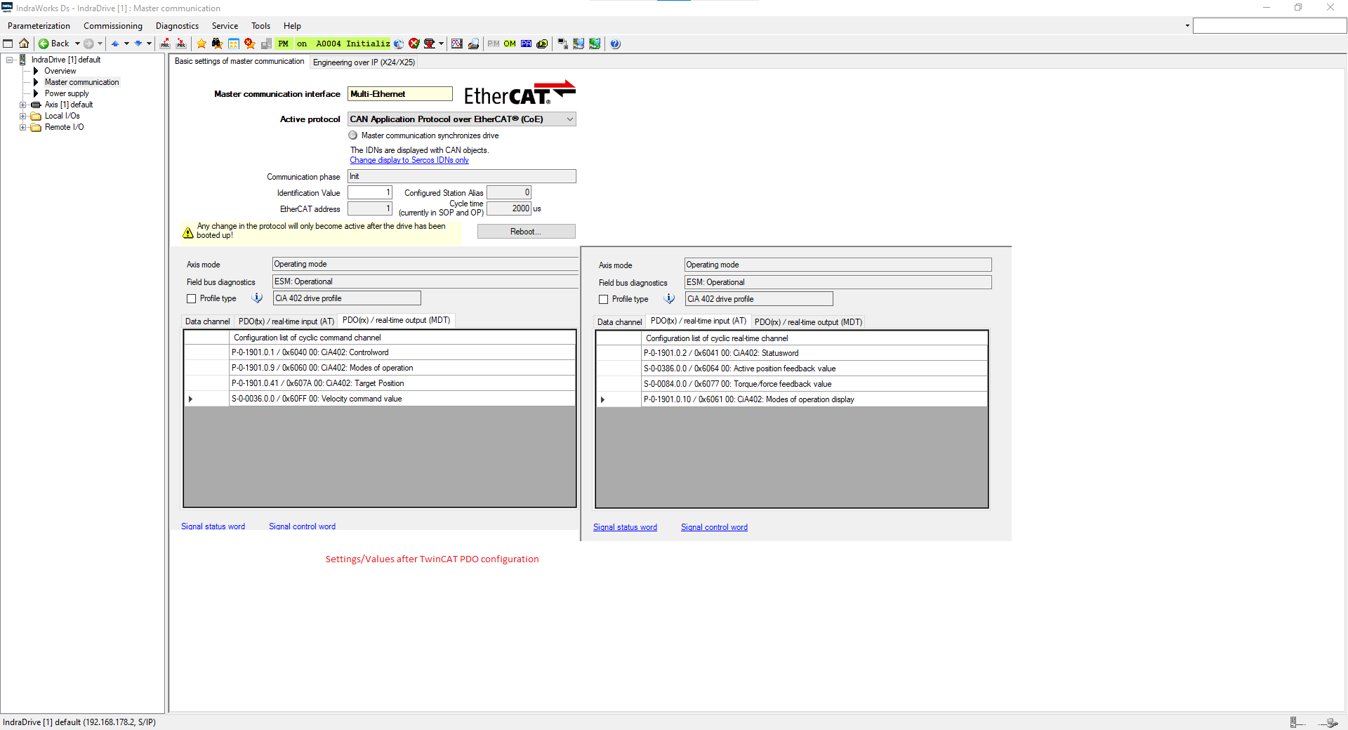

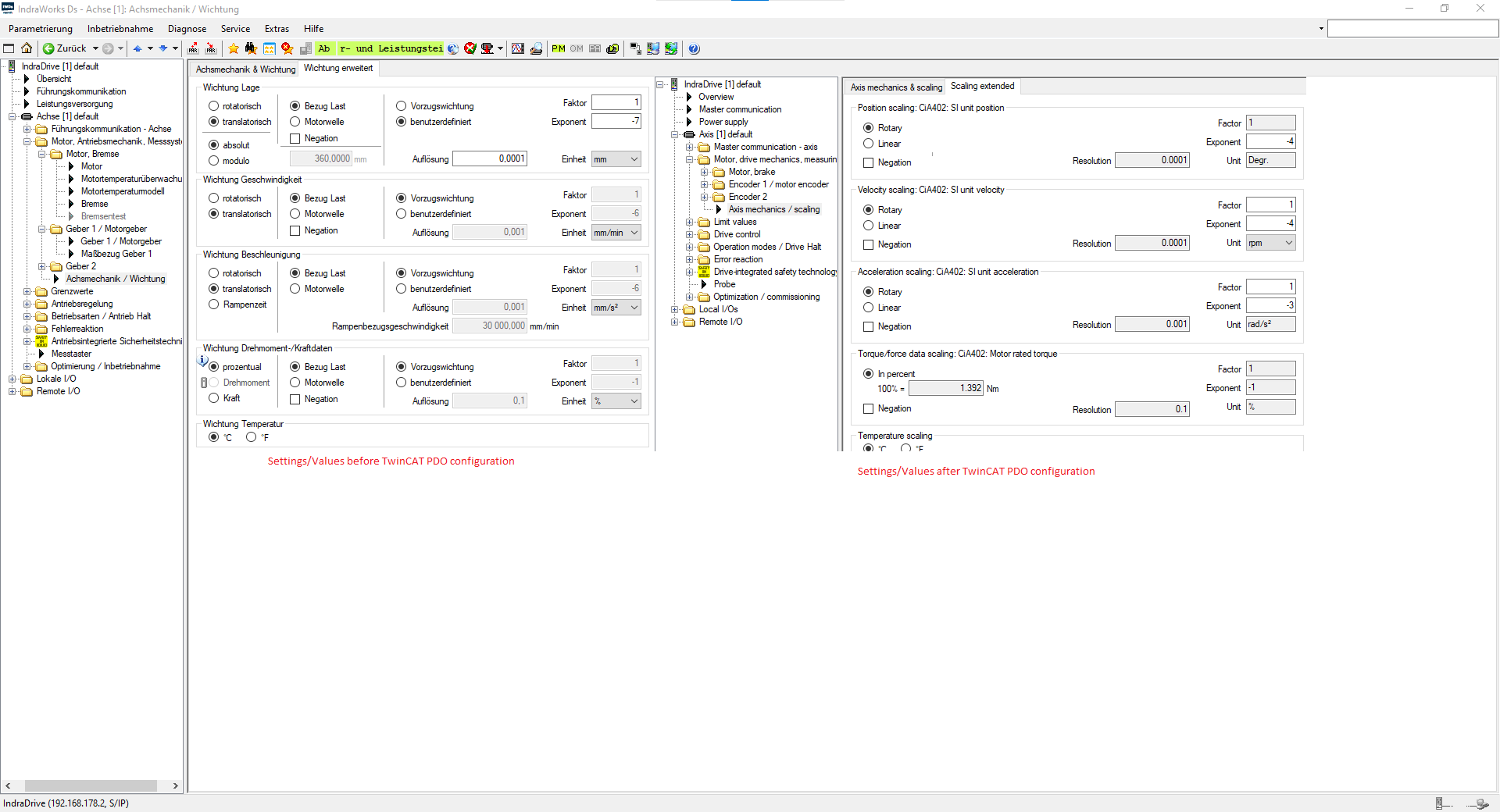

I´ve got my Drive up and running under LinuxCNC, with the Firmware 20V26 and the Rexroth XML for COE which is delivered with the Indraworks DS Software from Rexroth.
But when i setup the drive with indraworks DS to my needed Scaling and Mechanical setting, and then let TwinCAT configure the Drive that LinuxCNC is able to "control" the drive. all of my previous Parameters will be overridden.
I will add some Images which should provide some of my issues.
When i try to change the Settings after TwinCAT reconfigured them the Indraworks software generates various Error messages which i can´t resolve with my momentary knowledge.
The following user(s) said Thank You: Nico2017
14 Feb 2021 10:26 - 14 Feb 2021 10:26 #198812 by db1981
Replied by db1981 on topic Ethercat HAL driver
Hello,
the drives get its SDO Parameters at the startup from the Ethercat master, so if this is a drive in which you can't permanently save the initcmds, you will start with an empty drive config.
if you don't tell twincat the values of the idn's, it will change the drives config.
Why do you need twincat to make the drive controlable with linuxcnc?
Last edit: 14 Feb 2021 10:26 by db1981.
