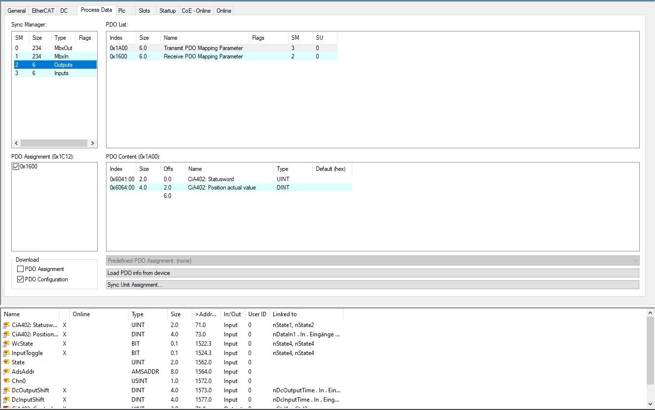

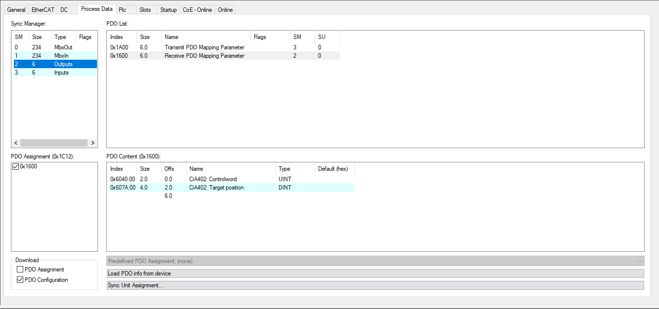

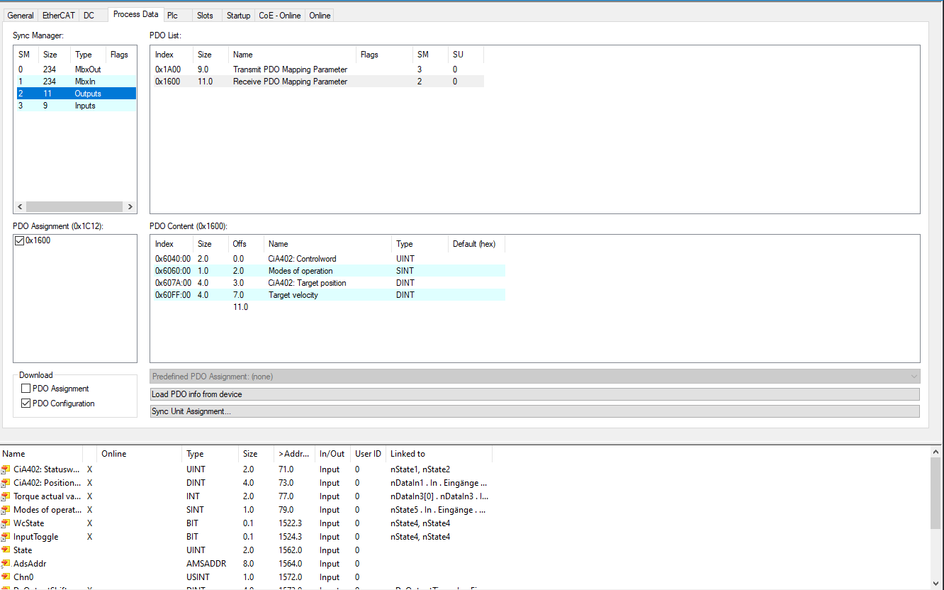

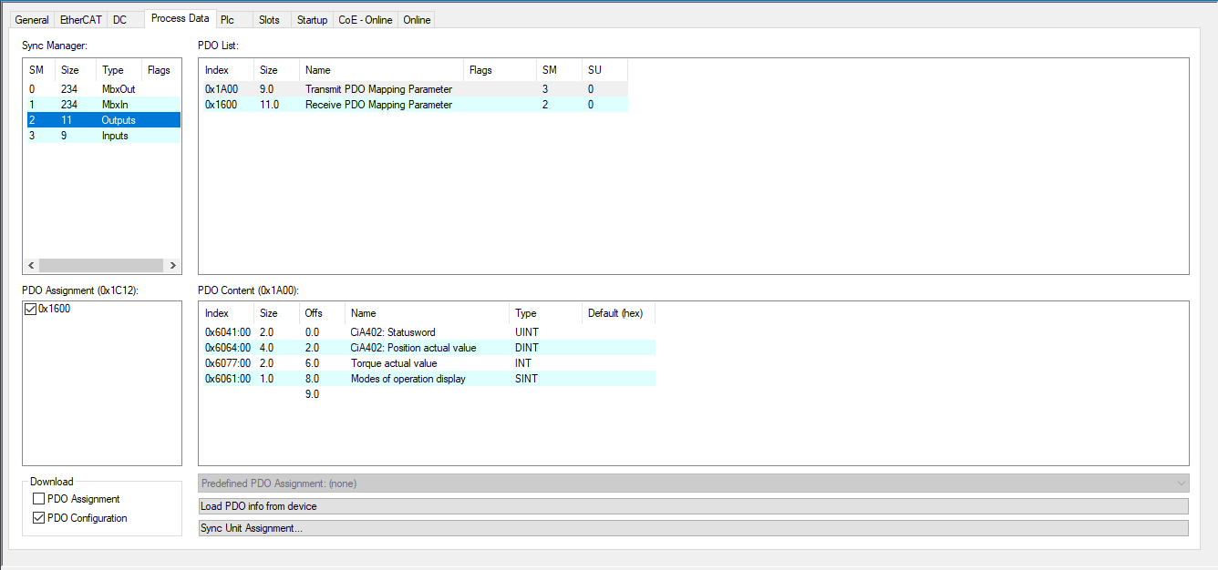

15 Feb 2021 12:54 - 15 Feb 2021 12:56 #198958
by jc2ktr
After Changing the MasterCommunication to Ethercat there are 2 pairs of PDO´s preconfigured, this is preconfigured from IndraworksDS.
see Attachments
I reconfigured the PDO´s to get more options like this:
Replied by jc2ktr on topic Ethercat HAL driver
ok, don't try this will not work. Twincat sets an EoE Gateway for the ethernet communication through ethercat.
Please explain your step -Configure PDOs , are there no pdo's listet after the box scan?
see Attachments
Last edit: 15 Feb 2021 12:56 by jc2ktr. Reason: Edit
