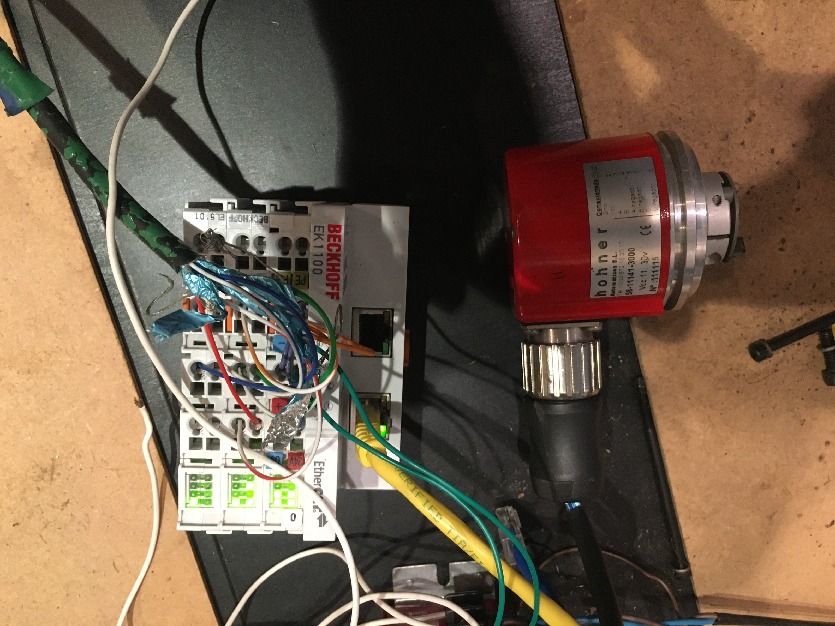

18 Jan 2021 20:43 - 18 Jan 2021 20:44 #195828 by chimeno
Replied by chimeno on topic Ethercat HAL driver
Hello @sqmathlete,
I have gotten the EL5101 with a HONNER 58-11141-3000 encoder, in case you need any help.
Greeting
Chimeno

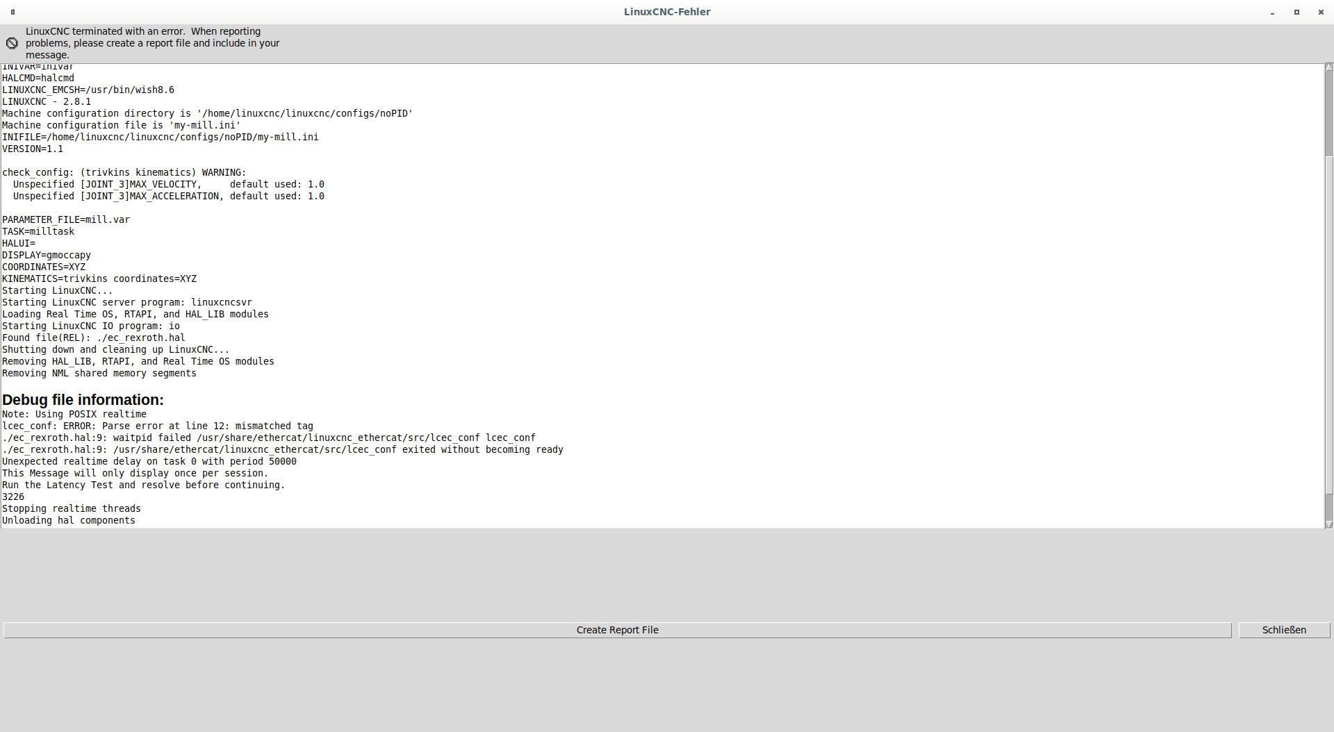

21 Jan 2021 10:37 - 23 Jan 2021 09:49 #196072 by jc2ktr
Replied by jc2ktr on topic Ethercat HAL driver
Addition 01/23/2021
I got my Servodrive up and Running and found an old description file for my firmware version.
The configuration then was relative easy. But now i stuck at running LinuxCNC with my XML file.
It stucks at line 12 with a Parse error but i can't solve it.
Hope anyone can take a short look over my File.
Greetings Sven
File Attachment:
File Name: ethercat_rexroth.xml
File Size:2 KB
Hi folks,
#does someone have the original Bosch-Rexroth XML Description for TwinCAT? The one i can download from the Rexroth page does #not support the firmware of my drive. The drive is FW version 18V34 and the downloadable XML is for 20V26.
#Unfortunatley Rexroth does not have an Donwload Archive on their Website.
#And my Servomotor is not supportet by the new Firmware version.
Last edit: 23 Jan 2021 09:49 by jc2ktr. Reason: edit

04 Feb 2021 19:51 #197672 by chimeno
Hello @jc2ktr
not if you have already solved it, but the error is in line 11 and 13
I attach the example
Error
<syncManager idx="0" dir="out"/>
</syncManager>
<syncManager idx="1" dir="in"/>
</syncManager>
Solution
<syncManager idx="0" dir="out">
</syncManager>
<syncManager idx="1" dir="in">
</syncManager>
