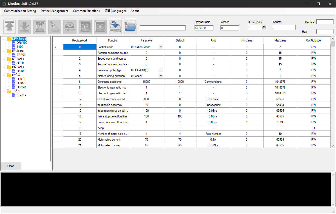

03 Jan 2021 12:37 - 03 Jan 2021 12:47 #193971
by jc2ktr
Hello @Chimeno,
i tried to setup/configure my driver with the program, but it seems that my driver is not compatible with it. I always got error messages.
And in the Selection window my driver was not listed, even when i tried to load the .xml file which i got with my driver.
even when i try to scale my signals in these lines:
it does not change the moved distance... when jog 10mm the axis moves 25
i will write a email to rtelligent about my scaling issue, and wait what they have to say.
Maybe it´s a stupid simple solution

Replied by jc2ktr on topic Ethercat HAL driver
Hello @jc2ktr
-Have you used the manufacturer's program to find the appropriate values?
* you need to configure the engine parameters, I assume you are using an ECT60
When configuring in position mode, linux no longer has control over the diver, it only sends position and reads position, you have to apply the scale here
<pdoEntry idx="607A" subIdx="00" bitLen="32" halPin="poscmd" halType="float" scale="1000"/><pdoEntry idx="6064" subIdx="00" bitLen="32" halPin="actpos" halType="float" scale=".001"/>

03 Jan 2021 12:55 #193973
by chimeno
Replied by chimeno on topic Ethercat HAL driver
Hello @jc2ktr
If it may be a good idea to send an email if they can help you,
can you check this if the scale changes?
Greeting

03 Jan 2021 13:14 #193975
by jc2ktr
@Chimeno
i tested the 0x2020 parameter about a day ago, i´ve set it to 666 pulses per revolution the value was 4000 pulses per revolution my Ballscrew/KR33 Axis has a pitch of 6mm per revolution 4000/6=666.6666666666667
after setting this the motor wasnt able to run anymore under linuxcnc, it stalled momentarily, and made squeeking/scratching noises as i commanded him to move. so i set them back to 4000 cpr.

06 Jan 2021 13:38 #194268
by MRBaird
Replied by MRBaird on topic Ethercat HAL driver
Well I finally got my ECT-60 scaled. I am using 5mm pitch leadscrew so 300RPM = 1500mm/M. After rereading the manual i noticed that Target Velocity and Target Position are in pulses!!! LinuxCNC uses machine units. So at 4000 pulses per revaluation from the manual I get 800 pulses for 1mm. I don't know why 4000 pulses because the motor description say 1000 count encoder. my guess is microstepping in the drive.
