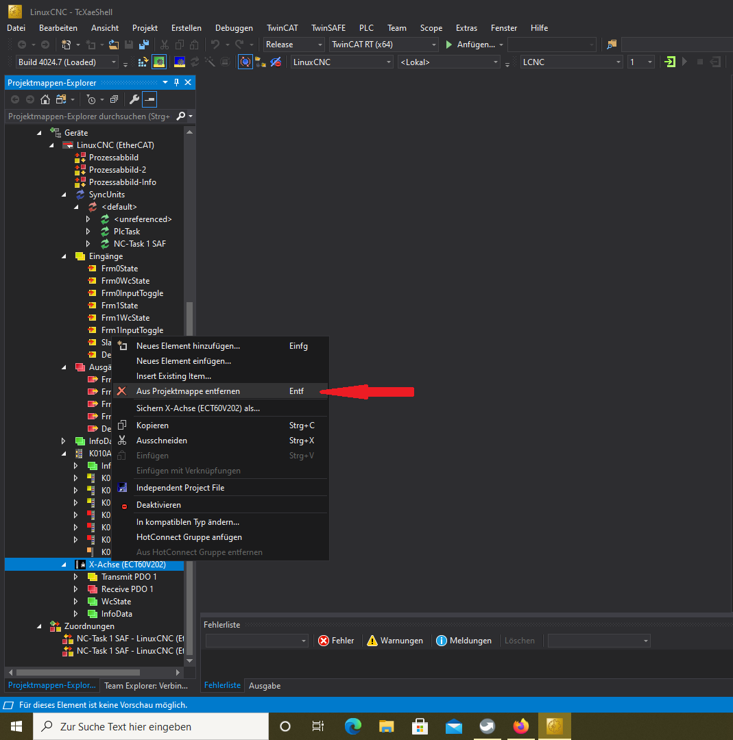

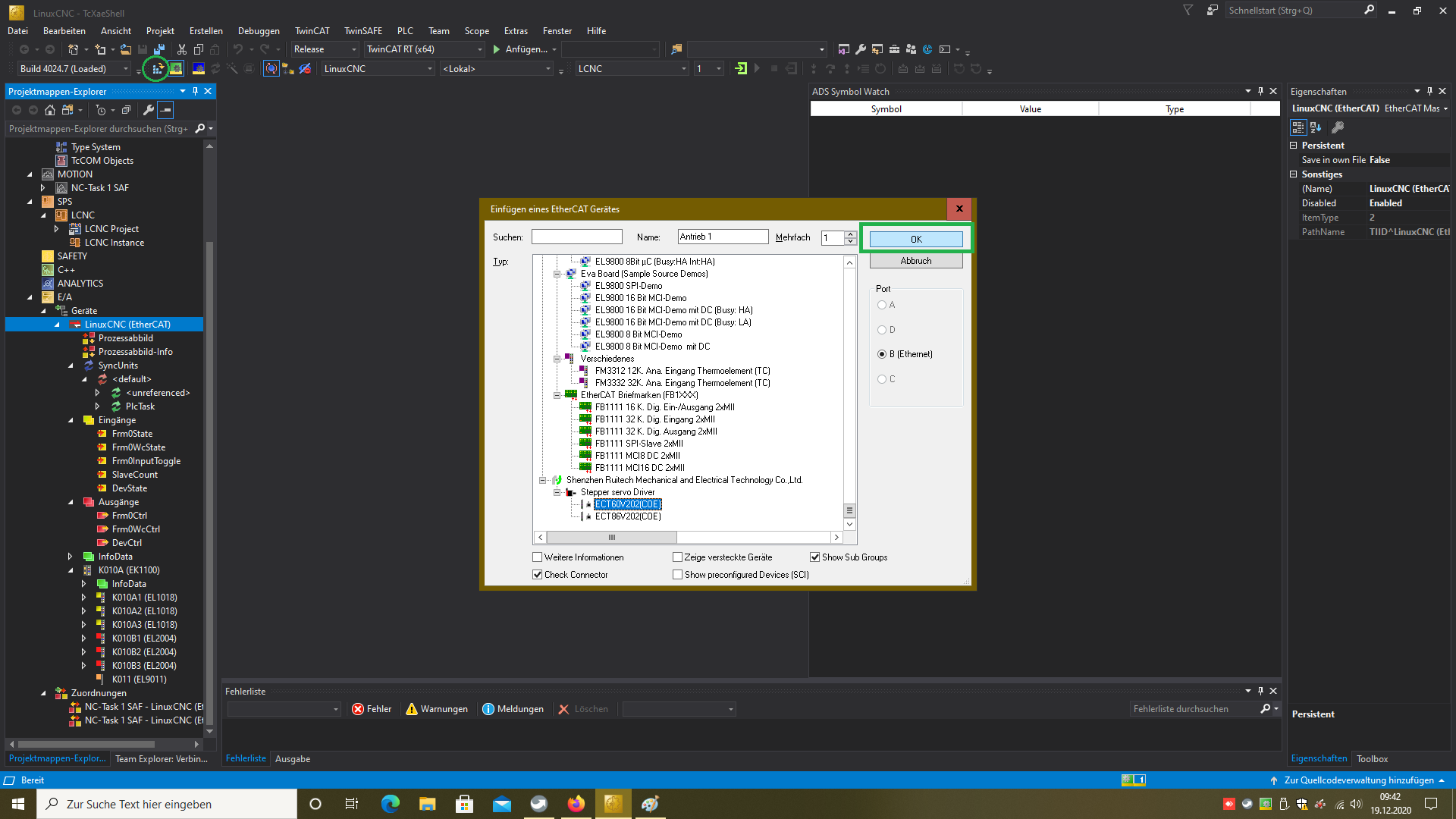

19 Dec 2020 09:52 #192442 by jc2ktr
Hello @jc2ktr
it is best to leave the EC60 device by default, one way to do it is with TWINCAT3, add a new device (don't read it) just register again the default form that comes with TWINCAT3, it should work again and take it to OP then you can use the file of the user @MRBaird that uses the generic form
Greeting
Chimeno
Hello @Chimeno,
I tried to remove the device and add a new device, hope i´ve done it the right way, made Screenshots of how i´ve done it.
The question is, should i activate the Configuration in TwinCAT or is it enough to add it.
Thanks for your patience with me :)
19 Dec 2020 10:29 #192444 by chimeno
Hello @jc2ktr
If you have to configure the device and activate it, you should have it in NC mode, the device has to go to OP and be able to move the motor.

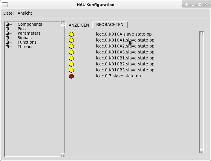

19 Dec 2020 16:05 #192463 by jc2ktr
Hello @jc2ktr
Don't worry, I'm like you too, and at the beginning everything costs a lot to understand and work.
Hi @Chimeno,
i am back under LinuxCNC, most of my EC-Slaves are OP only my ECT-Drive still don't do anything.
Started LinuxCNC and enabled the Machine, after that i've done a dmesg see attachment.
After starting the Ethercat bus it tells me following:
[ 1502.144042] EtherCAT ERROR 0-main-7: Failed to set SAFEOP state, slave refused state change (PREOP + ERROR).
[ 1502.148059] EtherCAT ERROR 0-main-7: AL status message 0x0036: "DC Sync0 Cycle Time".
and later then
[ 1741.894170] EtherCAT ERROR 0-main-7: Failed to set SAFEOP state, slave refused state change (PREOP + ERROR).
[ 1741.898181] EtherCAT 0: Slave states on main device: PREOP, OP + ERROR.
[ 1741.898183] EtherCAT ERROR 0-main-7: AL status message 0x0036: "DC Sync0 Cycle Time".
[ 1741.906199] EtherCAT 0-main-7: Acknowledged state PREOP.
don't know at the moment what this messages try to tell me :(

Hi @Chimeno,
thanks for your help, that did it, i got all the slaves OP. Can enable the drive and readout the actpos.
But when i try to jog de Axis does not move. Somewhere i missed something to connect in my HAL file.
