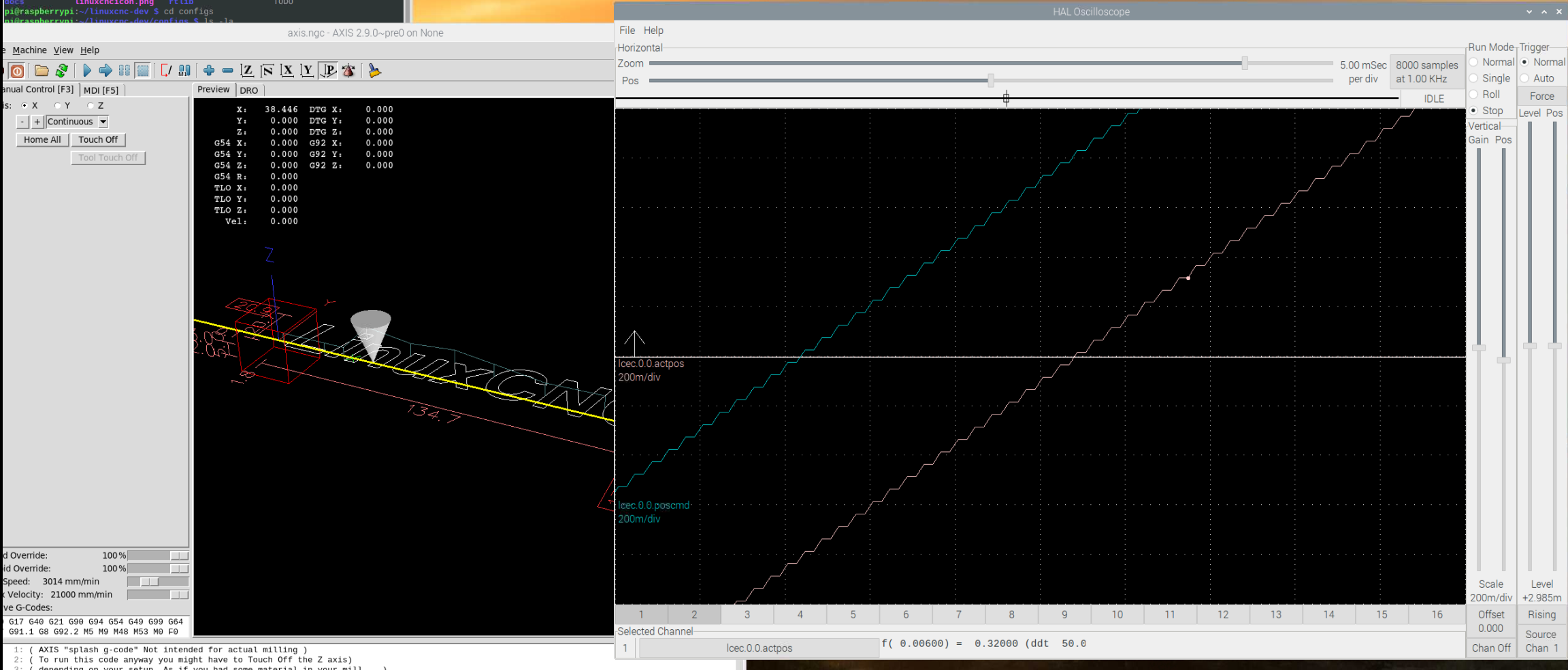

Hello, I think I just made some progress,
actualy my xml had this:
<syncManager idx="2" dir="out">
<pdo idx="1600">
<!--<pdoEntry idx="6040" subIdx="0" bitLen="16" halPin="control-word" halType="u32"/>-->
<pdoEntry idx="6040" subIdx="0" bitLen="16" halType="complex">
<complexEntry bitLen="1" halPin="X-cmd-SwitchOn" halType="bit"/>
<complexEntry bitLen="1" halPin="X-cmd-EnableVoltage" halType="bit"/>
<complexEntry bitLen="1" halPin="X-cmd-/QuickStop" halType="bit"/>
<complexEntry bitLen="1" halPin="X-cmd-EnableOperation" halType="bit"/>
<complexEntry bitLen="1" halPin="X-cmd-OPmodeRel1" halType="bit"/>
<complexEntry bitLen="1" halPin="X-cmd-OPmodeRel2" halType="bit"/>
<complexEntry bitLen="1" halPin="X-cmd-OpmodeRel3" halType="bit"/>
<complexEntry bitLen="1" halPin="X-cmd-FaultReset" halType="bit"/>
<complexEntry bitLen="1" halPin="XcTimeOut" halType="bit"/>
<complexEntry bitLen="1" halPin="X-cmd-OpmodeRel4" halType="bit"/>
<complexEntry bitLen="6"/>
</pdoEntry>
<pdoEntry idx="6060" subIdx="00" bitLen="8" halPin="opmode" halType="bit"/>
<pdoEntry idx="607A" subIdx="00" bitLen="32" halPin="poscmd" halType="float" scale="1"/>
</pdo>
</syncManager>
so I checked and indeed 0x6061 was always reading 0x08
because that is what is saved in the drive from before I enable and OP the drive.
but in OP 0x6060 is reading 0x00...
because I didn't do anything special in linuxcnc the halconfig related to 0x6060 stayed at 0x00
so what I did is add this to postgui.hal:
setp lcec.0.0.opmode-3 true
which actually writes the 3rd bit in 0x6060 and now when I read registers with
ethercat -p0 upload 0x6060 0
I get 0x08
and same for 0x6061
finally after looking for something logical and mucho tweaking: I changed the scales to 1000 and 0.0001:

AND NOW I CAN JOG!!!!! 1 axis... now I have a whole cnc to build but it seems so easy in comparison
THANK YOU CHIMENO I owe you one...

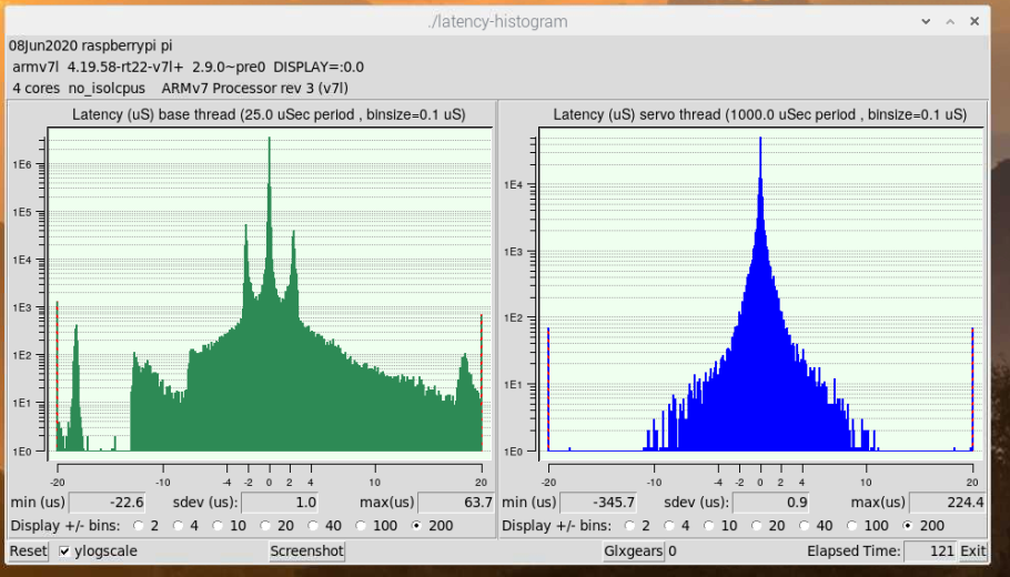

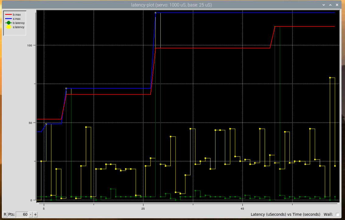

Since Friday I am playing with a raspberry 4 with preempt RT controlling a close loop x axis stepper motor through an ECT60 ethercat drive.
I decided to spend some time configuring and adjusting the scale so that the mm scale on screen would match the screw in my gantry which seems like a good idea.
Also I was curious to see what speed I could achieve in displacement (no load or screw yet)
Well it so happens that I found the max speed to be about 3500 mm/minute. Higher than that and the motor would stop complaining about an error on the Joint . I understand that this is due to delta between the cmd position and the actual position returned by the motor.
I do believe this "max" speed to be adequate for my application and I am fairly happy with it, stil I would like to know what position lag this implies and if building the CNC based on this hardware is realistic or if I need to tweek it..
Also I believe it is linuxcnc that raises the alarm before the closed loop in the driver complains (is that desired behaviour at least it doesn't seem that I have to clear the driver error)?
Also what I a don't know yet is if the position lag or error is acceptable and since I believe my loop ethercat loop is 1ms I wanted to know if that was the cause of the whole lag.
So I fired the latency test histogram and plots as well as plotted actual position and cmd position in HAL scope (which I am not sure to fully master yet btw) to see how things fitted together.
the latency seems to be generally under the 1ms and I believe that although I use the "generic" driver it is not a bottle neck...???
But on the halscope,
I observed a 15 ms delay in time for the actual position to reach the cmd position at full speed of about 3000 mm/min = 50mm/s
on the graph the position lag is just under 1 halscope unit... which I suppose is mm
Doing some simple math 1 ms at that speed is a move of 50 um and 15 ms corresponds to 750 um which is about right.
So my question would be ... is that expected normal behavior for a closed loop stepper drive and motor?
Ethercat doesn't seem to be the bottle neck here (1 ms vs 15 ms) and I suppose the lag must thus be from the PID regulator in the driver.
And can linuxcnc successfully work with such a lag?
I suppose that I will never mill at that speed (probably only up to one third of that 1m/min) but that would already represent 250um lag... so is it acceptable?
Sorry if those general considerations are expected knowledge, but I don't know what is the correct strategy to reduce this error.
I believe this is usually solved using feedforward in a PID loop. So I found at least 2 registers in the driver which might be of interest:
Object dictionary Name Property Type Range The default value Note
0x2023:04 PosLoop_Kvff R/W/S UINT 0 to100 30 Speed compensation
and this one
0x2009 Filter Time R/W/S UINT 0~25600 6400 us
ECT60 has a built-in moving average filter. This object is used to set the time of moving average
filter. The greater the filtering time, the smoother the start and stop of the motor, but the greater
the response lag of the motor.
Lag time = filter time
There is also 0x2025 "speed filter" with some frequency parameters and also there is servo mode 2 parameter set (Kp,Ki,Kv1,Kv2,Kvf) to play with at 0x2026 to use for vector control algorithm
So what is a good strategy or guide to set up those parameters?
update: so I played a bit with parameter 0x2009 trying to half the time constant and indeed it does reduce the the lag between actpos and poscmd... but at the cost of the drive being "sometimes" unstable when I move the jog back and forth. It makes noises and strange steps .. I can feel it's not "happy"...
photos.app.goo.gl/PoLrSQ2Csg674BmY6

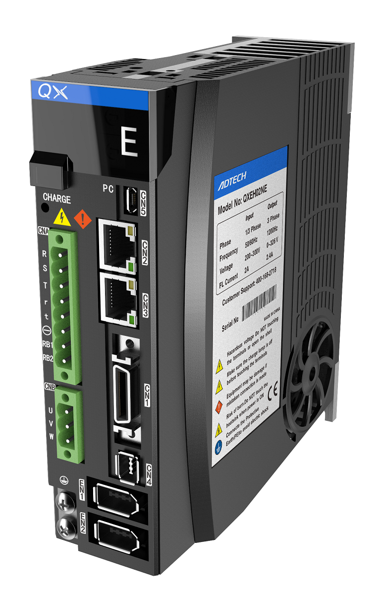

Hello, everyone . I bought EtherCAT servo drivers brand Adatech model QXEH10NE
Manual : drive.google.com/file/d/14cinYiQ4-0qYuw5...Znf/view?usp=sharing
Does anyone have experience with these drivers and LinuxCNC?
