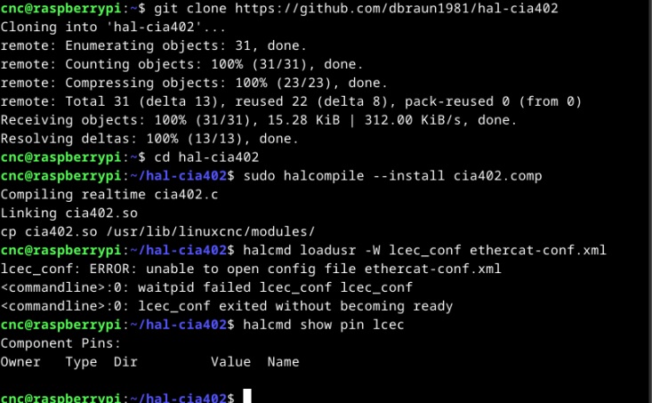

- Khan
- Posts: 6
23 Feb 2025 00:51 - 23 Feb 2025 04:41 #322329
by Khan
Replied by Khan on topic Ethercat installation from repositories - how to step by step
Hello,
i followed the instructions, and successfully installed everything, what are the next steps to get the system up and running i am using L7 Ethercat leadshine servos, i have no idea how to setup cia402, this is my first time dealing with linux, need help
Last edit: 23 Feb 2025 04:41 by Khan.

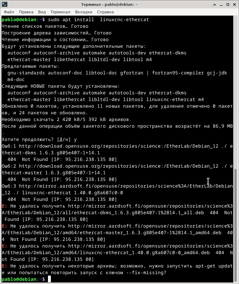

- PabloSancez
- Posts: 4
- Thank you received: 4
01 Mar 2025 17:40 #322947
by PabloSancez
Replied by PabloSancez on topic Ethercat installation from repositories - how to step by step
- Posts: 12156
- Thank you received: 4149
01 Mar 2025 17:58 #322951
Replied by rodw on topic Ethercat installation from repositories - how to step by step
Their key changed a while ago. You should not get this with 2.9.4
Otherwise there is a script on another sticky threads to fix this.
- PabloSancez
- Posts: 4
01 Mar 2025 19:37 #322957
by PabloSancez
I get it in version 2.9.4.
everything worked during the day, broke in the evening.
how can I fix this?
where to find "sticky threads"
how can I fix this?
- Posts: 12156
01 Mar 2025 22:42 #322968
try: sudo apt update and try again
It just worked for me. do you have internet access?
the script is here but you should not need it
forum.linuxcnc.org/ethercat/53785-instal...thercat-repositories
