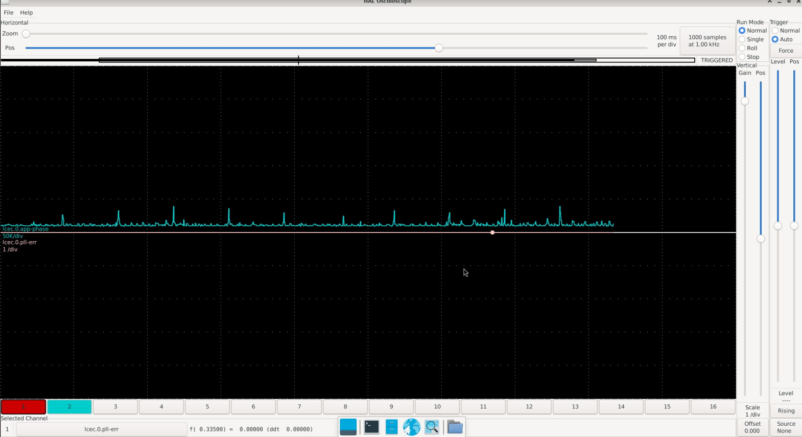

@TAKUYA
I see that you did not set pdo 1600 for your X drive was this on purpose?
I don't think the EK1100 needs the dconf line at all, but that should not effect, your DC seems ok, can you open the halscope, plot pll_err and app_phase? also servo-thread
also Sync0Shift should be half or 30% your cycle time, not 0
Last edit: 14 Mar 2026 07:46 by grandixximo.

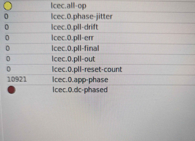

14 Mar 2026 09:48 - 14 Mar 2026 09:50 #344258 by TAKUYA
Replied by TAKUYA on topic Ethercat random jitter fix
So ive tried the new repo code and it still hasnt enabled dc-phase or shown any value for PLL-ERR or PLL-out except 0.
Im not sure if i plotted it correctly because i couldnt find the servo thread in halscope (is it servothread.time? ). However, please see attached image for pll-err and app-phase like requested.
Sync0Shfit was changed to 300000 aswell like you suggested
Last edit: 14 Mar 2026 09:50 by TAKUYA.

14 Mar 2026 20:15 - 14 Mar 2026 20:53 #344286 by grandixximo
Replied by grandixximo on topic Ethercat random jitter fix
@TAKUYA
@Atsu
please check the value of the parameters lcec.0.pll-step
You can do so with this command
halcmd show param lcec.0.pll-step
This parameter will be set at 1000 automatically if you have RTAPI_TASK_PLL_SUPPORT
also I have updated again the repo
if you could be so kind as to download, build and test again, thank you
github.com/grandixximo/linuxcnc-ethercat
Last edit: 14 Mar 2026 20:53 by grandixximo.
