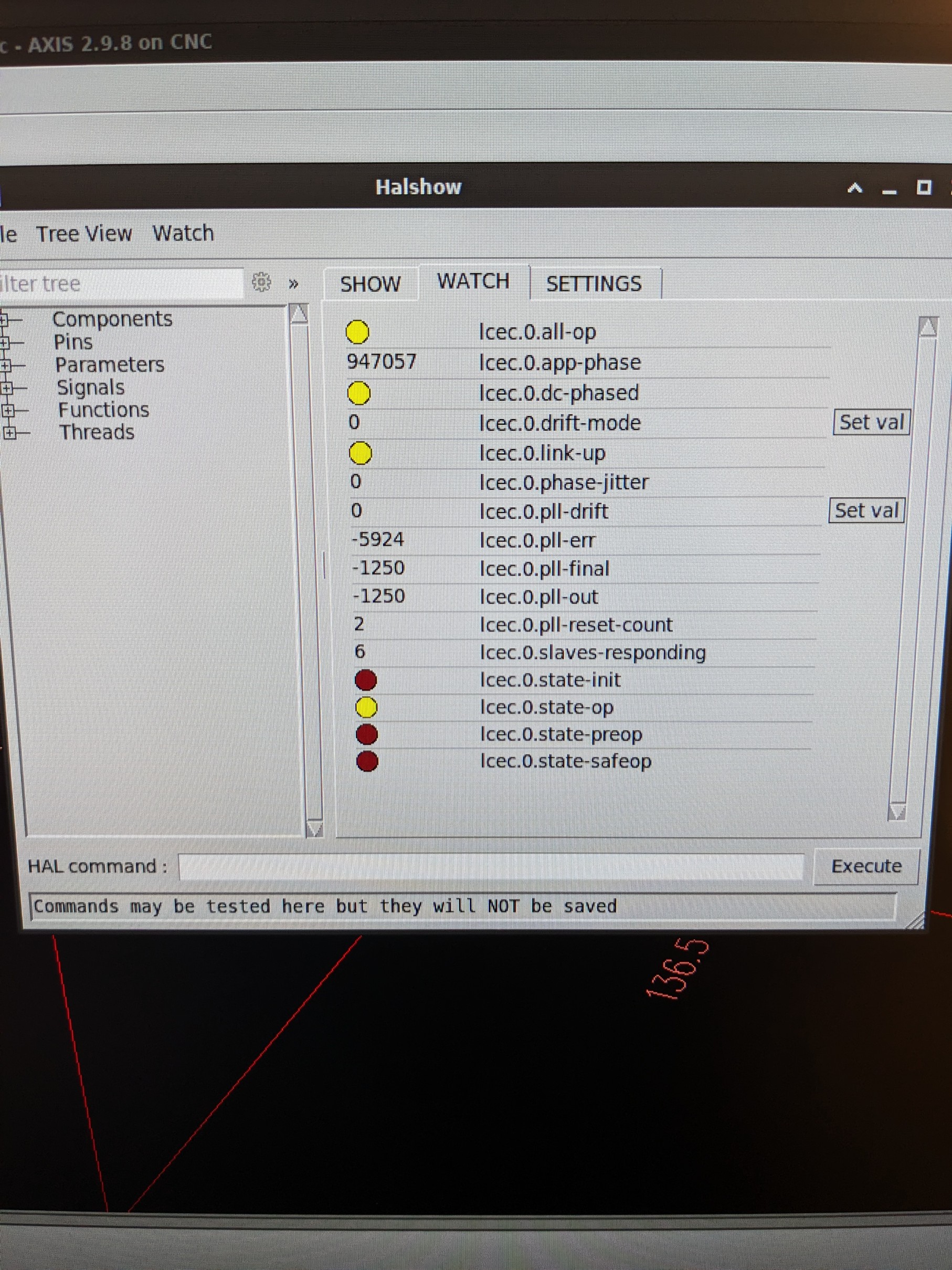

15 Mar 2026 12:11 #344320
by Atsu
Thank you! I pulled the latest changes and can confirm that it is now working. The dc-phased pin turns true, and I can see the pll- pins getting values other than zero. I did couple restarts and so far there is no grinding noise. I will continue testing to see if its gone for good.
Replied by Atsu on topic Ethercat random jitter fix
@TAKUYA
@Atsu
please check the value of the parameters lcec.0.pll-step
You can do so with this command
halcmd show param lcec.0.pll-step
This parameter will be set at 1000 automatically if you have RTAPI_TASK_PLL_SUPPORT
also I have updated again the repo
if you could be so kind as to download, build and test again, thank you
github.com/grandixximo/linuxcnc-ethercat

@andrax
Sittner's repository does not support
syncToRefClock
If you want to test Sascha Ittner's code with pll
Set
refClockSyncCycles="-1"
My code is a different repo
Sasha's code is missing some drivers, he has done a huge rework, he also removed the grind, but used another method, I am still undecided on how to merge his code properly.
