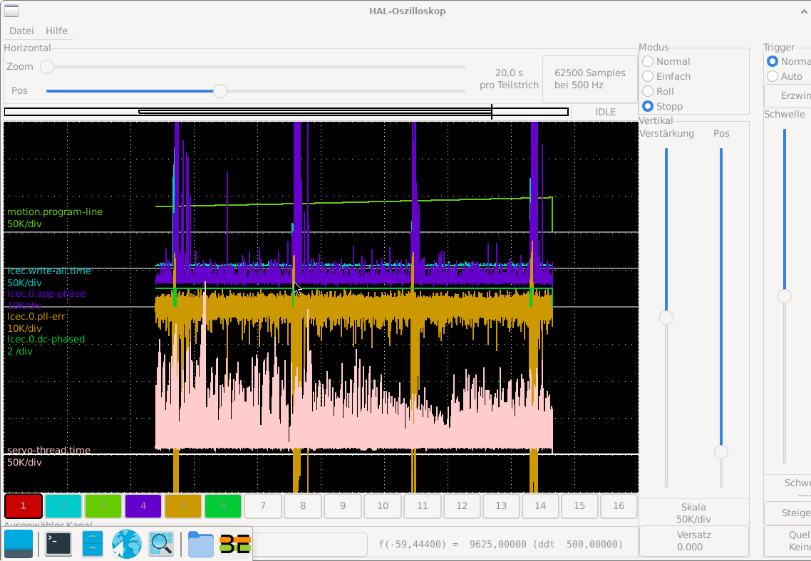

Please share zipped configuration folder, or whatever you are willing to share to shed light on the issue.

This is more likely due to a Linux service firing regularly rather than being ethercat related.
What Operating system and kernel version.
What steps have you taken to tune your kernel?

02 Sep 2026 14:56 - 02 Sep 2026 15:05 #349221
by ruediger123
Replied by ruediger123 on topic Ethercat random jitter fix
Hallo rodw,
the board is an Orange Pi 5 Plus without Wi-Fi.
kernel: Linux orangepi5-plus 6.12.0-rc7-edge-rockchip-rk3588 #5 SMP PREEMPT_RT
ethercat: IgH EtherCAT master 1.6.9 1.6.9-93-g4f9aa6f3
LINUXCNC - 2.10.0~pre1servo controller: 3 x Bosch-Rexroth HCS01.1EW0009-A-02-B-ET-CE-CE-L3
<master idx="0" appTimePeriod="1000000" syncToRefClock="true">
The setting results in the described error.
<master idx="0" appTimePeriod="1000000" syncToRefClock="false">
<master idx="0" appTimePeriod="1000000" refClockSyncCycles="1">
With these settings, the function works as intended.
Gruß
Rüdiger
Gruß
Rüdiger

07 Sep 2026 08:17 #349415
by grandixximo
Replied by grandixximo on topic Ethercat random jitter fix
You did not give linuxcnc-ethercat version
github.com/linuxcnc-ethercat/ethercat/releases
github.com/linuxcnc-ethercat/linuxcnc-ethercat/releases
I made arm64 debs as well...
syncToRefClock="false" without a refClockSyncCycles means free mode, don't use with axis.
syncToRefClock is going away because it is confusing, use refClockSyncCycles=-1 if you want to test having the pi sync to the clock on the drives, in your case it does not seem to work, should be same as syncToRefClock="true" but test with latest version.
refClockSyncCycles="1" if your latency is decent is a good choice.

10 Sep 2026 07:38 #349542
by ruediger123
Hallo,
the linuxcnc-ethercat version is : linuxcnc-ethercat (1.42.2-1)
Gruß
Rüdiger

14 Sep 2026 00:25 #349621
by grandixximo
1.44.0 is the latest version, also ethercat don't get from IGH, please uninstall IGH ethercat, and install the one from here instead
your devices will OP much quicker.

14 Sep 2026 01:54 #349624
lcec.activate
Replied by rodw on topic Ethercat random jitter fix
also note this new version needs an additional command in hal1.44.0 is the latest version, also ethercat don't get from IGH, please uninstall IGH ethercat, and install the one from here instead
lcec.activate
