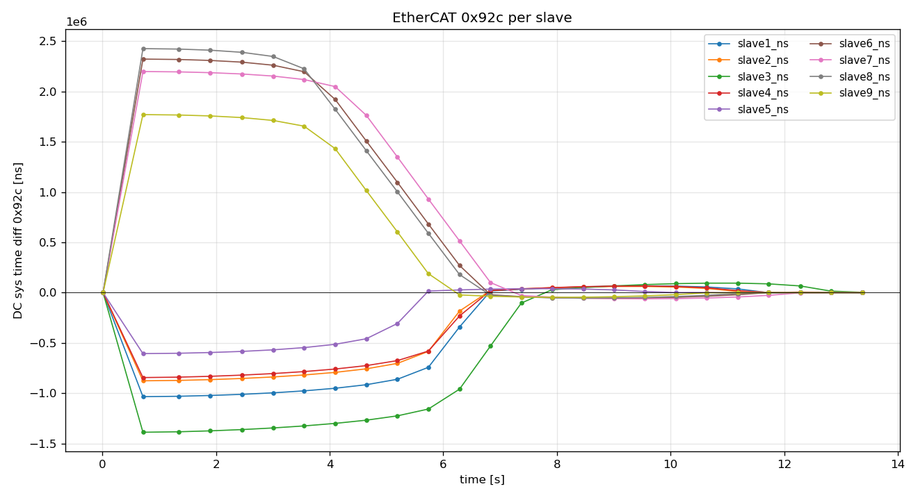

20 Apr 2026 05:26 - 20 Apr 2026 06:01 #345751 by grandixximo
Replied by grandixximo on topic Ethercat random jitter fix
Hi Hakan,
Thanks for the trace, it pointed straight at the bug. I reproduced your observation on my hardware and the root cause is exactly the "bad initial reference time" you flagged, but only in M2R mode. R2M is unaffected because it only writes the ref clock (sync_reference_clock_to) and never reads it back.
I added a small debug capture inside the dcsync callbacks (same columns as yours: cycle, pll-err, ref_time_lo, app_time) and logged the first 10 cycles. Before the fix on M2R:
# cycle pll_err ref_time_lo app_time_ns      app_time_lo
0 0        1875535147 829958931561087328 1037861216
1 0        1037346343 829958931562087328 1038861216
2 -385754  1038312400 829958935857087328 1038893920
3 -382546  1039366179 829958935858087328 1039893920
Between cycles 1 and 2, app_time_ns jumps by 4,295,000,000 ns (4.3sec). Same shape as your lcec.write-all trace.

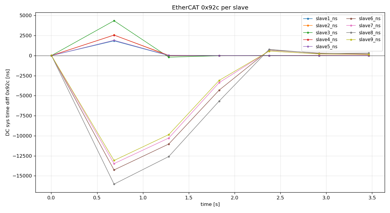

Fix is in v1.41.0-pre2. A ref_seeded flag discards the first nonzero read; the second nonzero read seeds the unwrap state without wrap detection; steady-state wrap detect takes over from cycle 2 onward.
After the fix on the same hardware:
0 0        3928128362 829970359148090426 4011856954
1 0        4043140737 829970359149090426 4012856954
2 -192285  4044085554 829970359181090426 4044856954
3 -187787  4045074812 829970359182090426 4045856954
No phantom 4.3sec. The cycle 1 to 2 delta is now 32 ms (32 periods), which is the real initial phase error between the slave's rebased SystemTime and our app_time at startup, snapped to whole periods by resnap. PI absorbs the ~190 us sub-period residual over the settle time. pll_reset_count stays at 0 because the first resnap fires with dc_diff_ns == 0 and skips the counter increment.

But be warned even with this fix the OP time in my case remain about the same, the hardware has to do OP to run in DC, and it does take time, I agree with Rob's assessment, having the first device on the network be a good DC device is a must if you want good DC, I could try to debug what is the problem with papagno's first device, and I am also trying to get Ethercat to fix the function where we will be allowed to move the DC reference to arbitrary devices in the network, at the moment this function is present in the API but does NOT work.
This is simply restart after few minutes LinuxCNC was closed (servos had time to drift apart)
12s OP
Then quickly close and open again (servos had NO time to drift apart)
