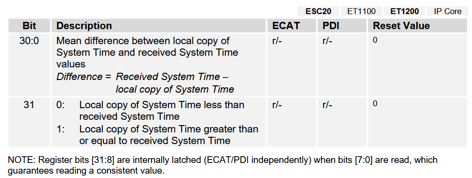

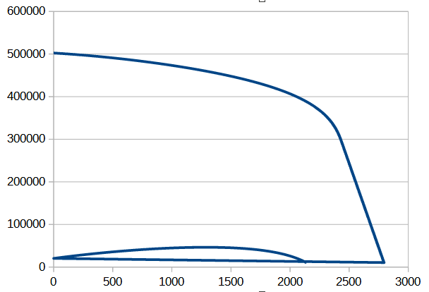

- Hakan
- Posts: 1317
- Thank you received: 454
18 Apr 2026 05:56 - 18 Apr 2026 06:17 #345677
by Hakan
Replied by Hakan on topic Ethercat random jitter fix
The code that handles the initial synchronization in the EtherCAT master is 16 years old, except for a variable name change 8 years ago
gitlab.com/etherlab.org/ethercat/-/blame...e=heads&page=2#L1480
There are people with this "Did not sync after 5000 ms." problem but no real solution found.
I am sure the x092c register shows the symptoms of the problem.
System Time Difference
This have me believing that either
- the slaves' clocks are drifting badly,
- the initial time the slaves get from lcec is not a good choice,
- or both.
Watching the 0x92c register during start, I see often, not always, start at 1000000 ns which is 1 ms.
This is with 1 ms linuxcnc servo loop time. When I go down to 0.5 ms servo loop time, 0x92c often starts at 500000 ns,
so there is a possible a correlation.
This initial 1 or 0.5 ms value in 0x92c happens when I start linuxcnc directly and when I let it sit over night.
This points to that it isn't a slave clock issue, but rather the initial time from lcec that is the problem.
Edit: The startup time for my lcec rt_app_main isn't that bad, its 0.85-0.9 secs. Forgot a test-second I had.
Edit 2: Here is a graph if how slave 1 and slave 2 reduce their time differences. This is from journalctl, 05 ms servo loop time.
