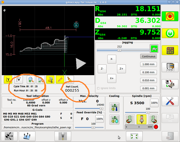

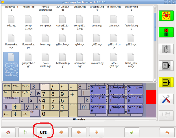

10 Jan 2015 03:28 #54840 by ditechcnc
Replied by ditechcnc on topic Gmoccapy - A new screen for linuxcnc
Please add these option in lathe screen
and USB option in both screen
11 Jan 2015 04:23 #54864 by newbynobi
Replied by newbynobi on topic Gmoccapy - A new screen for linuxcnc
@ditechcnc
have you changed already some code? Or are the images only fake?
All you like, is possible with gmoccapy, just using custom glade panels, you can embed them in several places, so it is up to you to implement them.
and please publish the result, so others can use also the panels.
If you need help, we will be pleased to do so.
Norbert
