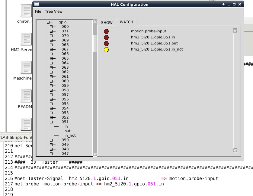

Please help me for uptate axis 2.5.4 to Gmoccapy
- Weiler810T

How to with a macro ?

WZsenor Macro have konflikt with Ncam
MANUAL Mode
Emit interp-run
1 2
MANUAL Mode
Emit interp-run
('MDI Mode', False)
emc/task/emctask.cc 397: interp_error: EOF in file:/home/chiron/linuxcnc/nc_files/ncam.ngc seeking o-word: o<wzsensor> from line: 0
(<__main__.gmoccapy object at 0x9abbe2c>, None, 'error')
Any Idea ?

Hallo Siegfried,
you are mixing several parts of Gcode, macros and of measurement up.
First:
get rid of
Just erase them! As this lines will mix up the toolchanger comp!
Second:
Why TOOL_CHANGE_POSITION and [Change_POSITION] ?
If you use both, why they do not have the same values?
You have commented out the MAXPROBE line, that is why gmoccapy complains about not finding a valid toolmeasurement config!
Third:
Your macro do include a M2 within the sub part, that is not allowed!
Change to be like this one
If you want to maintain some settings, and you do run that as MDI command, it might be better to surround the macro with % insteadt of using M2. See M2 ; M30 and surrounding %
You may want to use auto tool measurement together with a remapped M6 and call the subroutine from that remap procedure, but IMHO using a macro to measure just the mounted tool is much better in your case, as you have an auto tool changer.
Norbert

Macro have a bug
WZsensor
emc/task/emctask.cc 389: interp_error: EOF in file:/home/chiron/linuxcnc/configs/ChironFZ16/nc_files/ncam.ngc seeking o-word: o<wzsensor> from line: 0
any Idea ?
Kann man dieses Werzeugantasten Z mit einen Macro verbinden ?
best Regards Siggi

Hallo Siggi,
you are not allowed to use M30 and % at the same time!!!
change to be as follows and try!
Yes, you can use any subroutine as makro, see the manual for details.
Norbert
