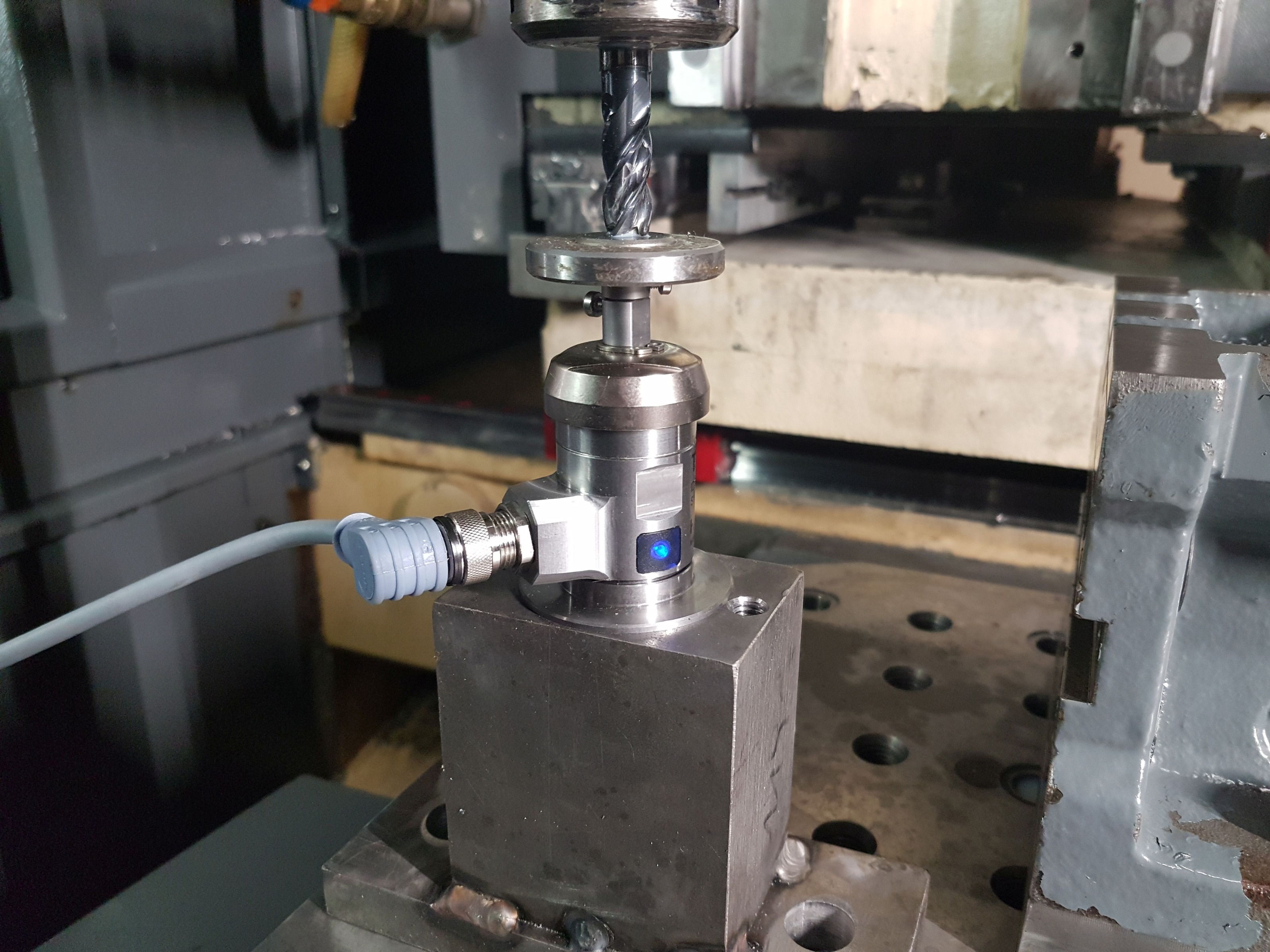

Hallo Norbert
Have a Proplem with the Macro, Macro works but the toolsenor not works
( wie kann ich denn Pin überprüfen ob er verbunden ist oder nicht ? Und warum zur Hölle muß die 1.te Zeile bei einen Macro frei bleiben, damit es funktioniert?)

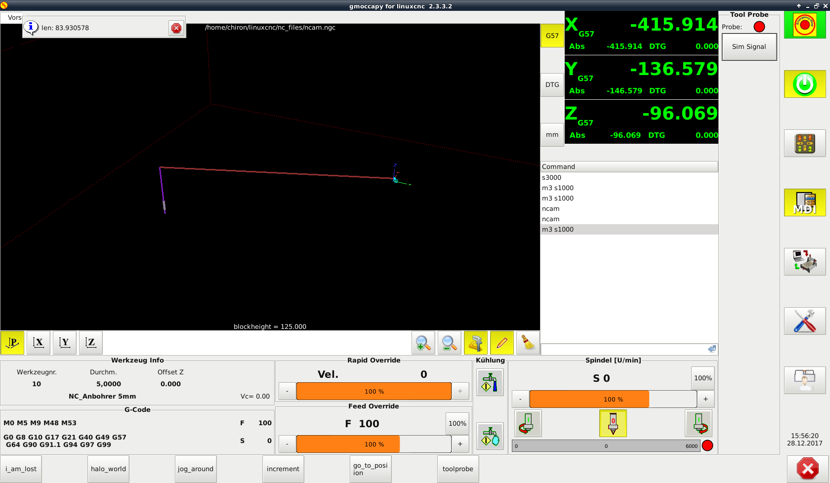

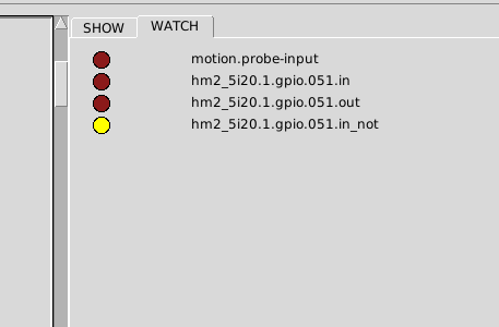

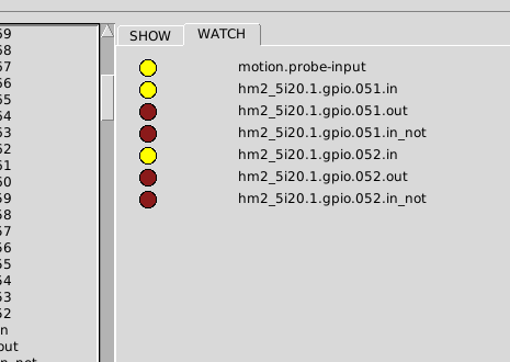

Sensor works, i switch NO to NC
I have a new Error, so what is that ?
emc/task/emctask.cc 389: interp_error: P value out of range with G10 L1

Hallo Siggi,
I can not understand, why the first line of your macro must be free, In my macros I do not have such problems.
The P error might be, because you use:
G10 L1 P#5400
Try to change to
G10 L1 P[#5400]
If you do not have a tool in your spindle, that value will be NULL, I do not know if that is allowed!
So better put a pseudo tool in your spindle.
Norbert

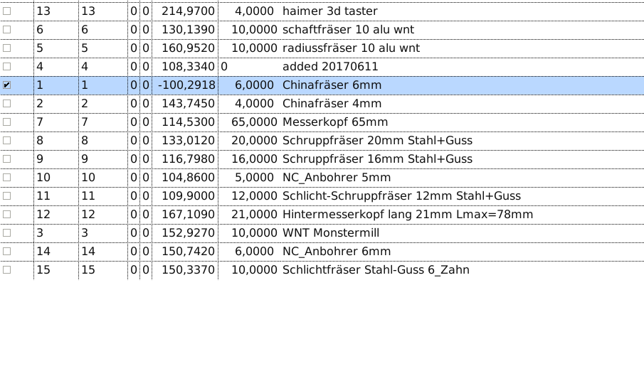

30 Dec 2017 00:34 #103838
by newbynobi
Replied by newbynobi on topic Please help me for uptate axis 2.5.4 to Gmoccapy
Mine are all negative, because my 3D- probe is longer than most of my tools?
Is that in your case also?
