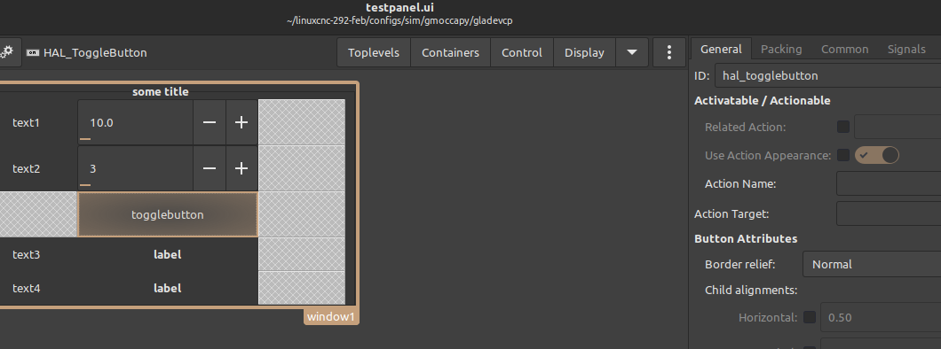

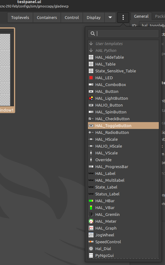

Replied by Aciera on topic İnstall glade
Shouldn't be much different from a hal_button,
open panel in glade add 'HAL_ToggleButton' and assign some ID (eg 'hal_togglebutton1') to it, save
Start config, open 'Halshow' and the pin should be visible as 'testpanel.hal_togglebutton1'

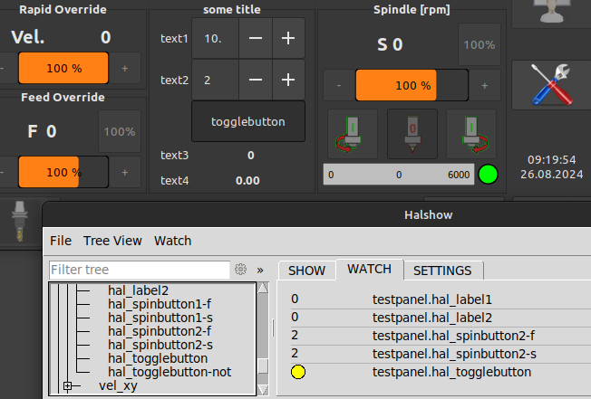

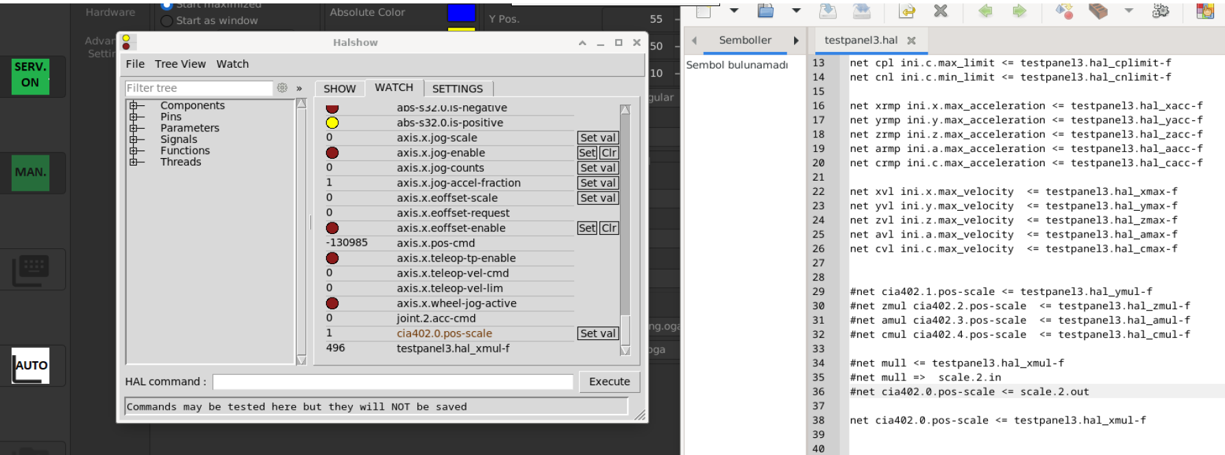

26 Aug 2024 07:13 - 26 Aug 2024 07:42 #308670
by Moutomation
Replied by Moutomation on topic İnstall glade
Normal buttons were created, but I copied these buttons from the 6 button examples. That's probably why it works. I think the reason why the toggle buttons are not visible is that I cannot add it to the configuration line you mentioned.
Secondly, I can change the ramps and limits from the gui, but no matter what I did, I could not change the calibration value.
There's probably something wrong somewhere
example:
testpanel3.hal:
net xvl ini.xmax_accelaration <= testpanel3.hal_xacc-f it's work
net xmul cia402.0.pos-scale <= testpanel3.hal_xmul-f it's doesn't work
net cia402.0.pos-scale <= testpanel3.hal_xmul-f it's doesn't work
setp cia402.0.pos-scale testpanel3.hal_xmul-f it's doesn't work
sets cia402.0.pos-scale testpanel3.hal_xmul-f it's doesn't work
example:
testpanel3.hal:

26 Aug 2024 07:44 #308673
by Moutomation
I made a mistake by adding gtktooglebutton instead of hal_toogle, thank you very much.

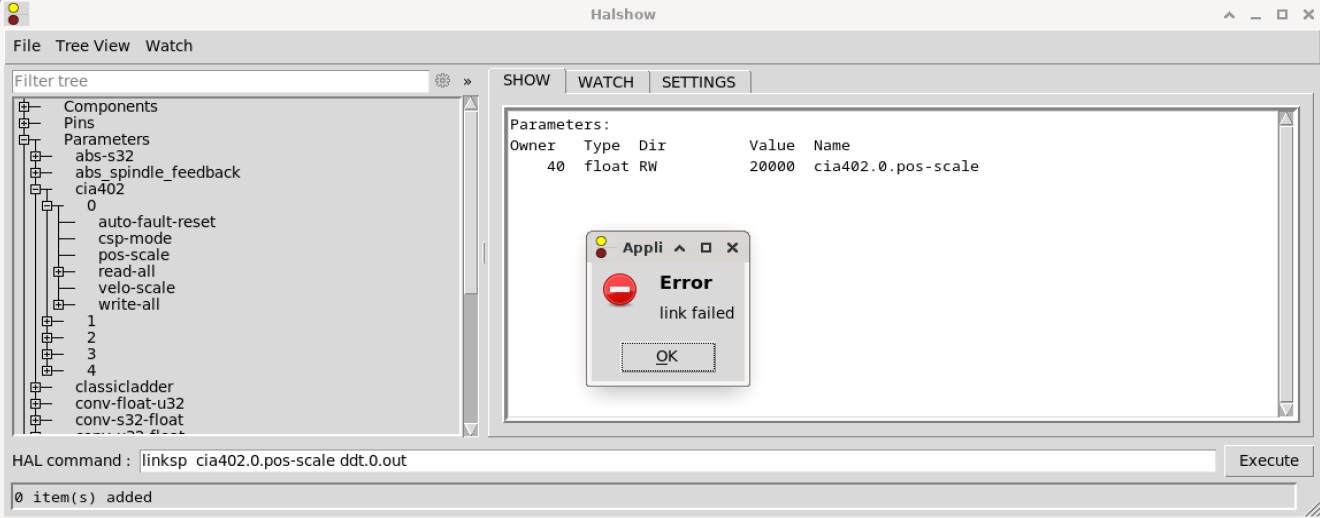

26 Aug 2024 10:58 - 26 Aug 2024 13:06 #308690
by Moutomation
It changes when I press the Set key, but I cannot connect it to a variable in the gui.
I think it is not possible to change this without going into the hal file. I tried every way I could think of but it didn't work.
I bound all other settings to variables. However, since this value is brown, I think the status file cannot be intervened. Does this color mean that this pin cannot be intervened?
Last edit: 26 Aug 2024 13:06 by Moutomation.
- Posts: 4819
- Thank you received: 2177
26 Aug 2024 14:35 #308708
Brown means that it is a hal parameter.
linuxcnc.org/docs/devel/html/hal/halshow.html

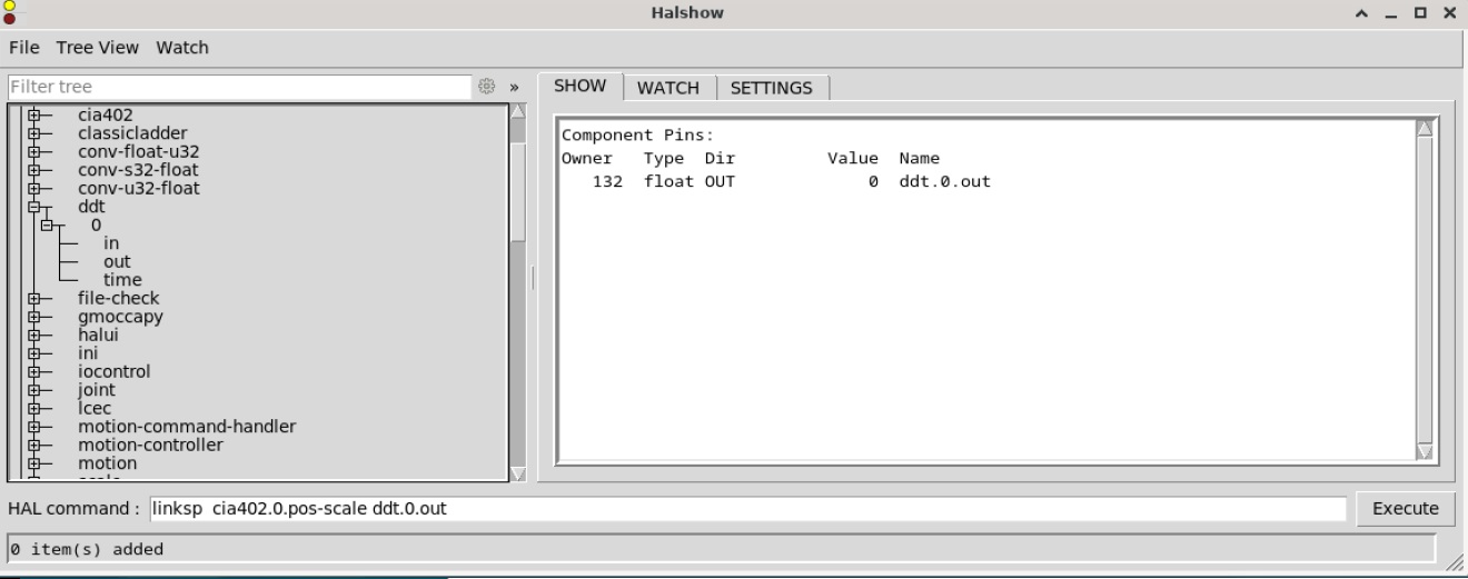

- Posts: 4819
26 Aug 2024 17:57 #308724
Since 'ci402.0.pos-scale' is a hal_parameter and not a hal_pin you cannot connect it to other hal_pins. You can only set them in using 'setp'.
As for 'ddt.0.out' that is an OUT hal_pin so it can only be connected to an IN hal_pin, so in your panel you can only connect it to something like a HAL_label to display the value.
linuxcnc.org/docs/devel/html/hal/intro.html
