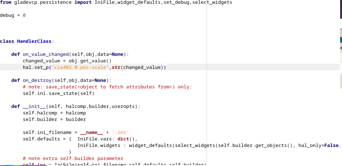

It is not possible to change a parameter in the hal file from the gui. Is it true?
Last edit: 26 Aug 2024 18:48 by Moutomation.
27 Aug 2024 06:05 #308766 by Aciera
Replied by Aciera on topic İnstall glade

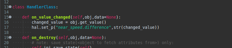

To set a parameter through the gui you can simply add a function to your handler.
1. add the function 'on_value_changed' to your panel handler script like this (you will need to change the parameter name form 'near_speed.difference' to whatever parameter you want to change):

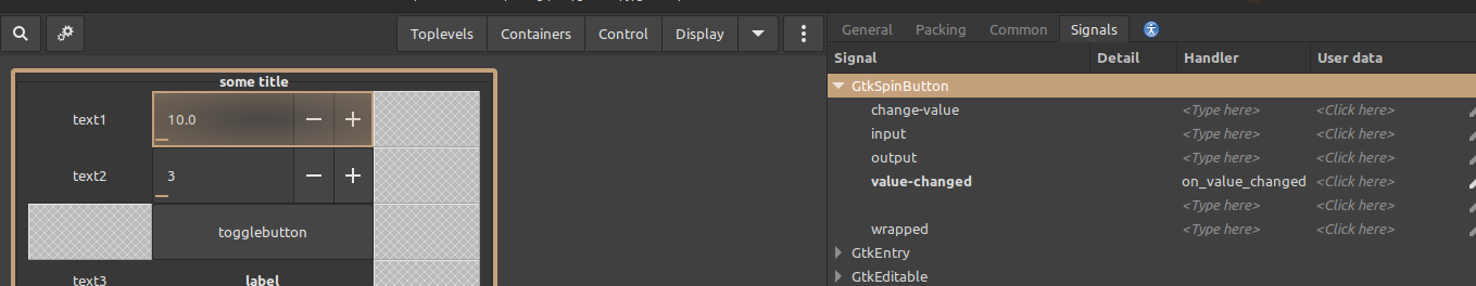

2. Open your panel in glade and add 'on_value_changed' as handler for the 'value_changed'  signal to your widget:

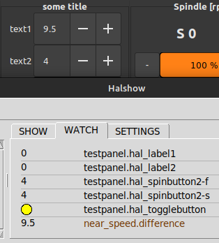

The parameter value should now change with the value of the panel widget:

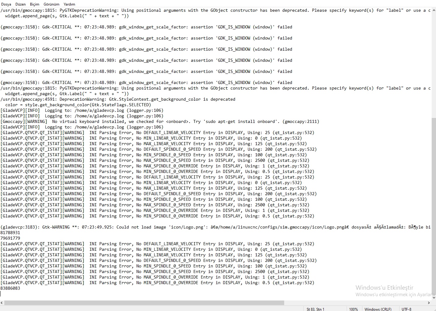

When I add this code gladevcp is not displayed in gmoccapy.
Start your config from a terminal and check the output for errors.

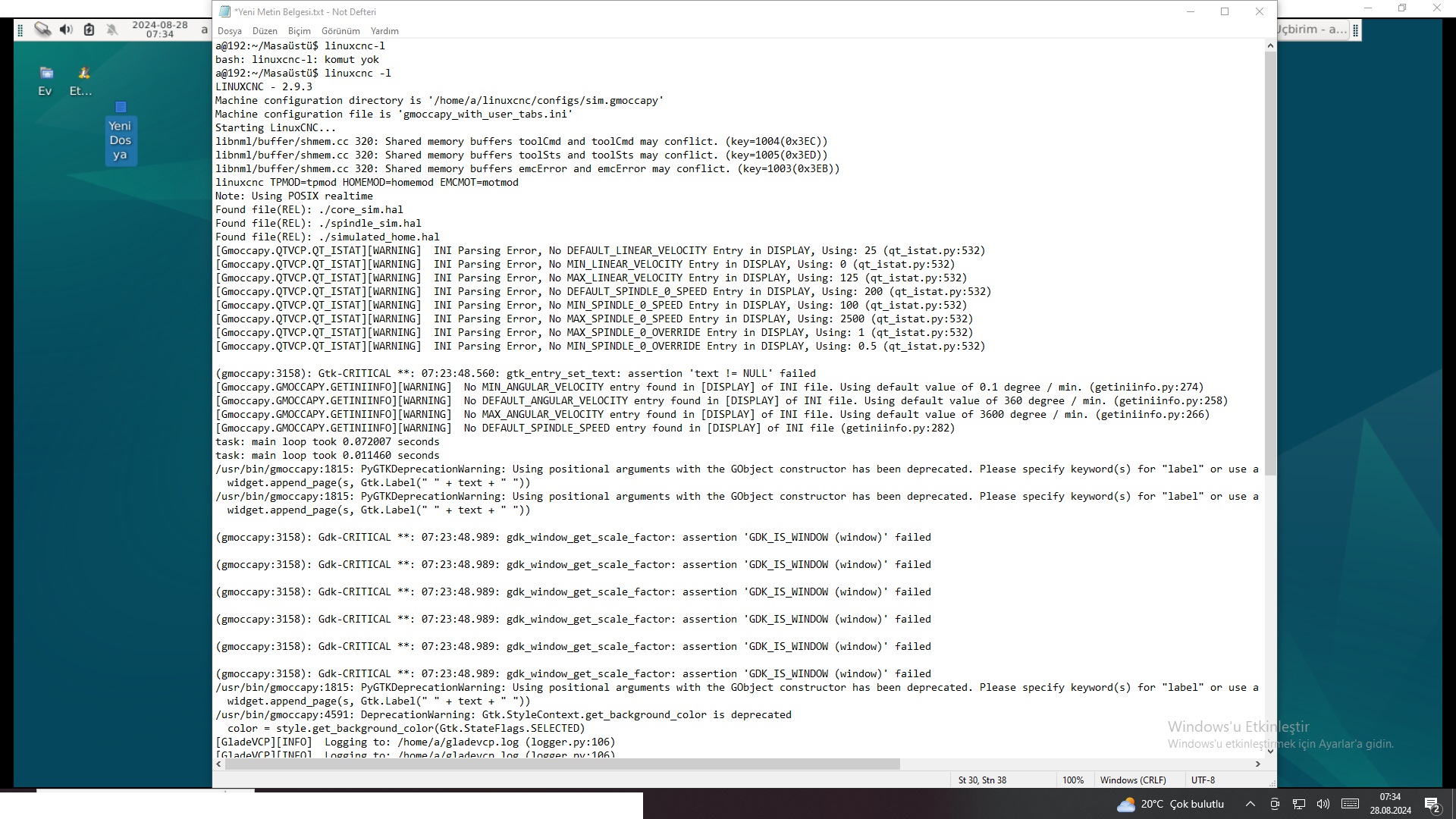

I created the above configuration just to see the embedded pages, but now I have deleted it and when I run the linuxcnc -l command, it says that it cannot find my actual configuration.
28 Aug 2024 04:51 - 28 Aug 2024 04:55 #308865 by Moutomation
Replied by Moutomation on topic İnstall glade
Since I deleted the configuration I do not use, it cannot find that configuration. How can I run the configuration I actually use with linuxcnc -l?
It's looking for sim.gmoccapy, my configuration name is bluecad
