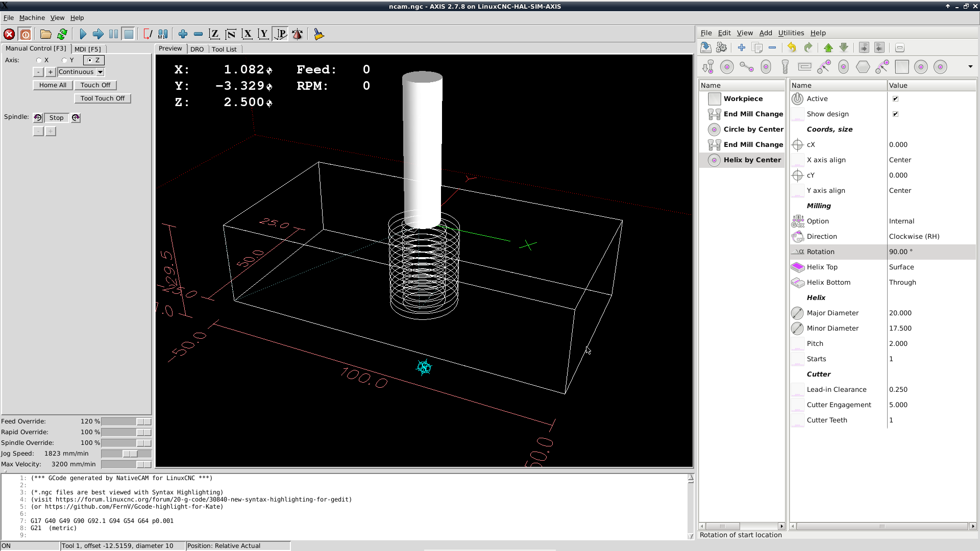

I've been using NativeCAM for a while now, and it's been very useful; the only thing it didn't offer that my old conversational control did was Helical moves, so I've written a quick sub for it - As usual with these things it's had little testing and probably too little sanity testing for its input - therefore use at your own risk! it's been fine for me, but YMMV!
(Strip the .txt from the cfg file and put the ngc in a folder LinuxCNC can see)
[Updated the ngc file - Realised I uploaded an older version with a few bugs]
[The running product]

Hi orpheus
Very well done, I will sure give it some serious tests if I can find the right cutter for it. And I will sure include it before long.
Best regards
Fern
Replied by FernV on topic NativeCAM is Features renamed
... I've written a quick sub for it - I've used it a few times today for some threadmilling I'd been putting off, and it's worked for both single-point and multi-toothed cutters. As usual with these things it's had little testing and probably too little sanity testing for its input - therefore use at your own risk! it's been fine for me, but YMMV!
Hi orpheus
Best regards
Fern

Hi orpheus,
You have done a fantastic job on this one and I am preparing to include it in the package.
Changes I will do
If you think of something else, let it be known
Best regards
Fern
p.s. : 'orpheus' or just Philip may be strange in the contributors list
... therefore use at your own risk! it's been fine for me, but YMMV!
Hi orpheus,
Changes I will do
- rename it 'Thread Milling' (I think it is the purpose, right?)
- give the option to select metric or imperial no matter the mill setup
- imperial will be TPI which is standard
- move the cutter params to 'Tool Change' and add usage for threading, this will prevent wrong usage of the cutter
- I do not think I will buy a cutter to try it, so users should be warned
Best regards
Fern

Replied by orpheus on topic NativeCAM is Features renamed
Hi Fern,
I can't think of anything else major. It is mostly what for threadmilling, so the name change should be fine. I'm glad you moved the cutting params, I had thought of doing that, but didn't want to mess too much with your underlying parts.
Thanks for seeing fit to include it in the package
As for my name, Mullen is my Surname.
Regards!
Regards!
