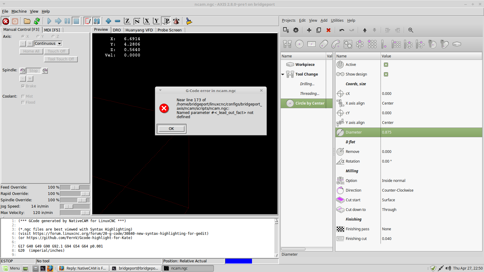

28 Apr 2017 03:54 #92244
by cncnoob1979
Replied by cncnoob1979 on topic NativeCAM is Features renamed
I have been trying to solve this on my own all night.. no avail
I just installed NCam latest and configured it embedded.
I am getting this error no matter what I do.. I'm sure its something that I am doing or not setting correctly. I'm using the latest git pull from FernV github with linuxcnc 2.8~.
The error Im getting is "Named parameter #<_lead_out_fact> not defined"
I have:
a workpiece
a change tool
and a circle of .875
The tool Im using is .5 endmill.
Nothing odd about what I'm doing. I have tried a clean install of linuxcnc and NCam. This fails on either axis or gmoccapy.
I have checked and rechecked my setup. Can anyone point me in the right direction?
INI attached below;
I have:
a workpiece
a change tool
INI attached below;
Warning: Spoiler!

hi cncnoob
i have the same error with my machine.
i fixed it with "adding a g-code "
line 1 = #<_lead_out_fact> = 0 (you must try what is the best lead out mode for the thing you milling at the moment)
you can see the different modes in the dro.
hope i can help a bit

- Posts: 21957
- Thank you received: 7478
28 Apr 2017 09:55 #92251
Replied by tommylight on topic NativeCAM is Features renamed
I have the similar problem on the LATHE part, it does not have an xml template so i just copied one that was close enough.
Basicaly that means that the named parameter is missing on the template.
Anyone got a working lathe template?
Mill and plasma work perfectly for me.

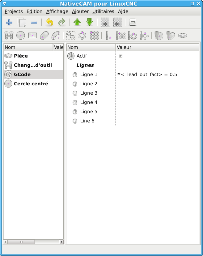

28 Apr 2017 13:41 #92271
by FernV
Sorry about this, I removed this parameter because it did not show very usefull but it seems the clean-up was not complete.
Use what was proposed by absolut15 for a quick fix :
Add gcode, line 1 = #<_lead_out_fact> = 0.5 (change the value at will)
GCode must be before your Circle
It is just a matter of a few days for a new major update, maybe this week-end
Fern
Replied by FernV on topic NativeCAM is Features renamed
Fern
