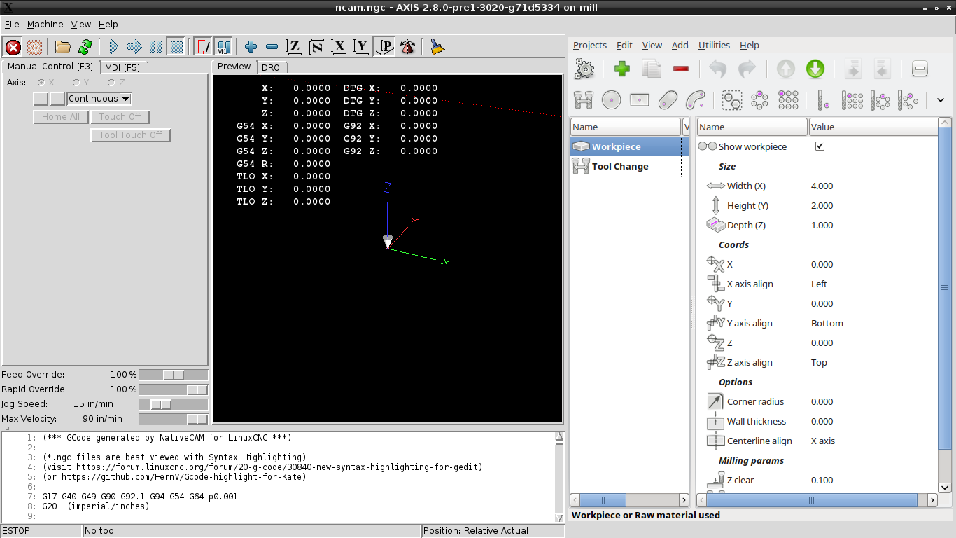

So being a glutton for punishment I put an install on my laptop which doesn't have parport but will do a demo for me.
I cloned the git and from that directory issued the "sudo ./nondeb_setup.py" command.
I still got an error message and lost hope for a brief moment.
cncuser@debian:~/.git/NativeCAM$ sudo ./nondeb_setup.py
[sudo] password for cncuser:
wait, processing...
"from ncam import NCam" already exists in /usr/lib/python2.7/dist-packages/gladevcp/hal_pythonplugin.py
created link to ncam.py in /usr/lib/python2.7/dist-packages/gladevcp
created link to pref_edit.py in /usr/lib/python2.7/dist-packages/gladevcp
File "./nondeb_setup.py", line 96, in <module>
os.symlink(os.path.join(os.getcwd(), 'locale/fr/LC_MESSAGES/nativecam.mo'), fr_mo)
OSError: [Errno 17] File exists
I then went to my cnc menu only to be surprised that I actually had the nativecam index there in front f my own eyes, "wonders will never cease".
Gingerly I ventured to click on the mill and couldn't believe mu very own when it burst into a full fledged screen of ncam.ngc
What now I ask myself???????
Will I be disappointed when I try this again on the real PC with working parport, I have to remind myself this is but a demo I am miraculously seeing here.

Clicked on ncam.py used in stand alone and lost the complete setup, back to square one with it.

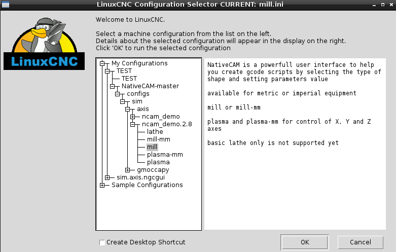

Didn't get back sooner, been out. I can't list what's in them as I deleted and started again.
Half way through it now, It shouldn't be hard to replicate if you wanted to, I think cncnoob might well be right.
I copied my config files into the ncam folder and ran it from there, it may be that when I went stand alone it made the .old folder and repeated when I tried to embed again.
It may not be that but I couldn't get it to embed again and it's quicker to reinstall than mess about.

What is quicker is to open your inifile and see all the lines after '# required NativeCAM item :'
You should have a line that reads : 'GLADEVCP = -U --catalog=mill ncam.ui'. Only the demos show 'ncam.ui' since it is copied in the demo directories
Anytime you use 'ncam -i your_inifile.ini' the full path to 'ncam.ui' is used to save redundancy, plus it will create a backup of your inifile and a new modified one, then create ncam sub-directories and necessary files and links.
This is the recommended way.
Fern
Replied by FernV on topic NativeCAM is Features renamed
... it's quicker to reinstall than mess about.
