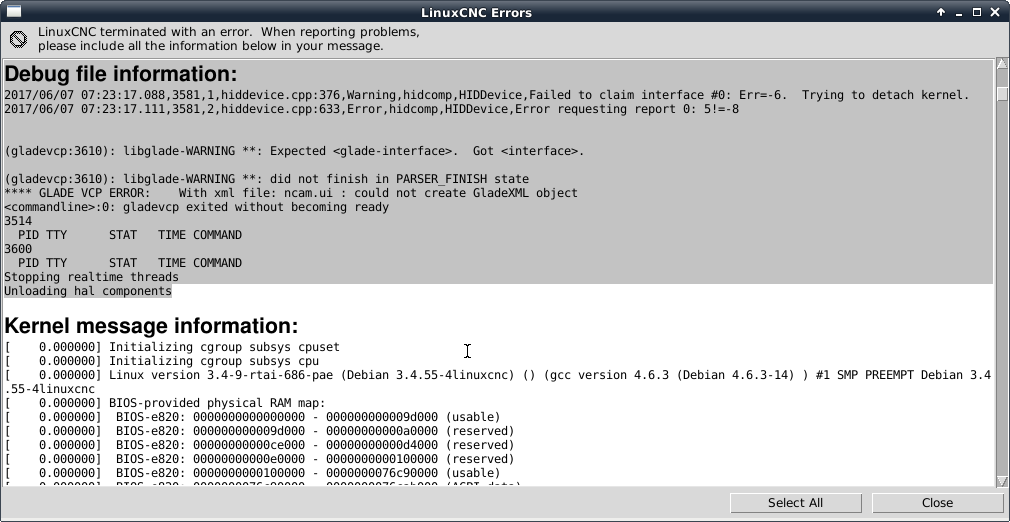

Hi, Fern.
I can't seem to get this to work. I started again and had AXIS running properly. Here's what I did next:
- Extract NativeCAM download to my home folder. This will install a folder NativeCAM-master.
- For some reason the unzip creates ~/NativeCAM-master/NativeCAM-master/. I moved the inner one up to ~/ to keep the file paths shorter.
- Go to ~/NativeCAM-master and double-click on ncam.py. It will install the NativeCAM application in standalone mode and open it up.
- Open a Terminal window.- Start AXIS pointing it to my ia-mill.ini.
LinuxCNC Errors (abbreviated)
Any ideas? This all seems a bit more difficult than it should be!

Kernel message information:Any ideas? This all seems a bit more difficult than it should be!

- FernV
- Posts: 457
- Thank you received: 124
28 May 2017 22:41 - 29 May 2017 03:55 #93764
by FernV
Instead open a terminal in ~
and use : git clone github.com/FernV/NativeCAM.git
Erase ~/NativeCAM-master and everything you created with those commands and follow the instructions.
All in a normal user terminal in your home directory
1- clone with : git clone github.com/FernV/NativeCAM.git
2- cd NativeCAM
3- ./ncam.py to make sure it runs stand alone and no package is missing, you can delete ~/nativecam directory later
4- close nativecam
I RECOMMEND THAT YOU NOW RUN : sudo ./nondeb_setup.py c
THEN ISSUE THIS COMMAND : sudo ./nondeb_setup.py
Try : linuxcnc /home/cnc1/NativeCAM/configs/sim/axis/ncam_demo/mill.ini
This will start linuxcnc with nativecam embedded
When satisfied, convert your inifile with this command from ~/NativeCAM directory :
./ncam.py -i /home/cnc1/linuxcnc/configs/ia-mill/ia-mill.ini
A backup ia-mill.ini.bak will be created.
Run linuxcnc normally using : linuxcnc /home/cnc1/linuxcnc/configs/ia-mill/ia-mill.ini
Fern

- Transistor
- Posts: 22
29 May 2017 21:34 #93820
by Transistor
Replied by Transistor on topic NativeCAM is Features renamed
Thank you very much for your help. I've followed your instructions exactly and am almost there.
This second-last starts AXIS with the NativeCAM panel.
cnc1@CNCPC:~/NativeCAM$ linuxcnc /home/cnc1/linuxcnc/configs/ia-mill/ia-mill.ini
This starts AXIS but without the NativeCAM panel.
Can you spot my error?
Thanks again.

- FernV
- Posts: 457
30 May 2017 04:33 #93826
by FernV
Replied by FernV on topic NativeCAM is Features renamed
From '/home/cnc1/linuxcnc/configs/ia-mill/ncam' delete 'cfg', 'graphics' and 'lib' subdirs/links
Sometimes it fails to delete old stuff, I have to find out why but the cause may be you started ./ncam.py with a 'sudo' command before.
Restart lcnc with : linuxcnc /home/cnc1/linuxcnc/configs/ia-mill/ia-mill.ini

- Transistor
- Posts: 22
30 May 2017 21:43 #93861
by Transistor
NativeCAM error popup:
followed by another:
Then AXIS opens without NativeCAM.
Terminal output:
Thanks again.
Done + a few more that I found.From '/home/cnc1/linuxcnc/configs/ia-mill/ncam' delete 'cfg', 'graphics' and 'lib' subdirs/links
Error creating link : /home/cnc1/NativeCAM/examples/mill -> /home/cnc1/linuxcnc/configs/ia-mill/ncam/catalogs/mill/projects/examples
Code : [Errno 13] Permission deniedfollowed by another:
Error creating link : /home/cnc1/NativeCAM/examples/plasma -> /home/cnc1/linuxcnc/configs/ia-mill/ncam/catalogs/plasma/projects/examples
Code : [Errno 13] Permission deniedThen AXIS opens without NativeCAM.

07 Jun 2017 15:36 - 07 Jun 2017 15:41 #94239
by gmouer
Replied by gmouer on topic Ncam crashing after taking updates
Hi Fern,
I have a Ncam system that has been working flawlessly for quite some time. I have NOT installed the recent updates that you released in the last month as yet.
Today, I took updates on the computer (op system and lcnc)and now Ncam/Lcnc crashes on startup. I am getting some glade errors related to NativeCam as shown in the attached screenshot. (Ignore the Hidcomp errors, I got those under control). The updates today included a update for Linuxcnc to 2.7.9 , before today the system was operating under 2.7.8 which ran fine.
Hopefully you can help me out.
