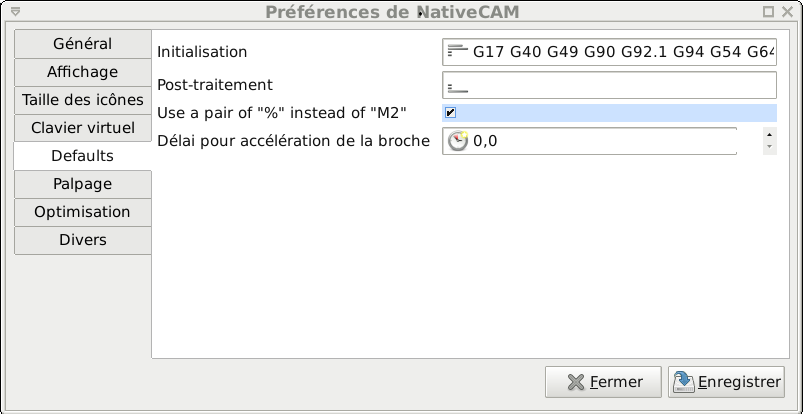

28 Jun 2017 19:09 #95138
by FernV
I will add an option in the preferences that would either end the file with M2 or "%"
If using "%", you would have to be sure the pre-amble is right.
If you can not wait for the update and simply want to remove M2, then
$ sudo gedit /usr/share/linuxcnc/aux_gladevcp/ncam.py
goto line 3540 and remove M2
save the file
If you mess, reinstalling the package would restore it
Fern

28 Jun 2017 20:14 - 28 Jun 2017 20:18 #95150
by eFalegname
def create_defaults(self):
self.default = _('%\n')
self.default += _('(*** GCode generated by NativeCAM for LinuxCNC ***)\n\n')
self.default += _('(*.ngc files are best viewed with Syntax Highlighting)\n')
self.default += '(visit forum.linuxcnc.org/forum/20-g-code/'
self.default += '30840-new-syntax-highlighting-for-gedit)\n'
self.default += '(or github.com/FernV/Gcode-highlight-for-Kate)\n\n'
return self.pref.default + gcode_def + \
_("(end sub definitions)\n\n") + gcode + self.pref.ngc_post_amble + '\n%\n'
I modified the 3540 line by replacing M2 for % and added the string % to the beginning of the g code file. Now I have the file wrapping by % and all runs ok. Good job Fern!

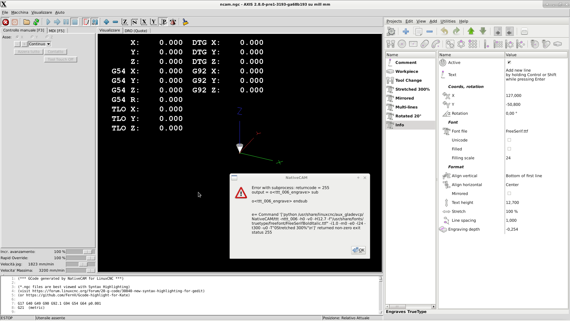

29 Jun 2017 13:06 #95170
by FernV
Replied by FernV on topic NativeCAM is Features renamed
HI Floris,
I can not find the meaning of this 255 code.
Check that truetype-tracer package is installed and also the font you want to use.
truetype-tracer should usually be installed with LinuxCNC
I checked the example and it seems it was not updated with the latest changes,
you could have an error because it can not do a G1 with a feed of 0. This is just for the example.
Fern

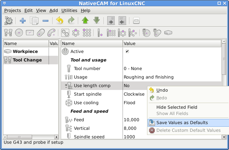

P.S. A simple reminder that if you always want "Tool length compensation " to be "No",
you can set and save all "Tool Change" values as custom default using

29 Jun 2017 15:46 - 29 Jun 2017 16:42 #95178
by eFalegname
Replied by eFalegname on topic NativeCAM is Features renamed
Thanks Fern for your tip, I have saved my defaults values and then hid coolant compensation and tool length functions.
The installation of true-type tracer solved my problem with the engraving fonts, but in the example of the project the error of G1 without Feedrate persists.

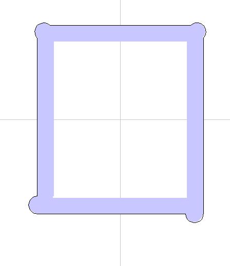

It would be nice to add a 45 and 90 degree hatch option to the engraving function.
Are you planning to implement tool wear compensation, maybe G41.1 D#; G42.1 D# for simplicity? I could not live without dynamic compensation.
Imho a calculator is more useful than a simple virtual keyboard.
In the rectangle function, you should increase the corner options as in the image bellow please, cnc router's users will be very grateful.
