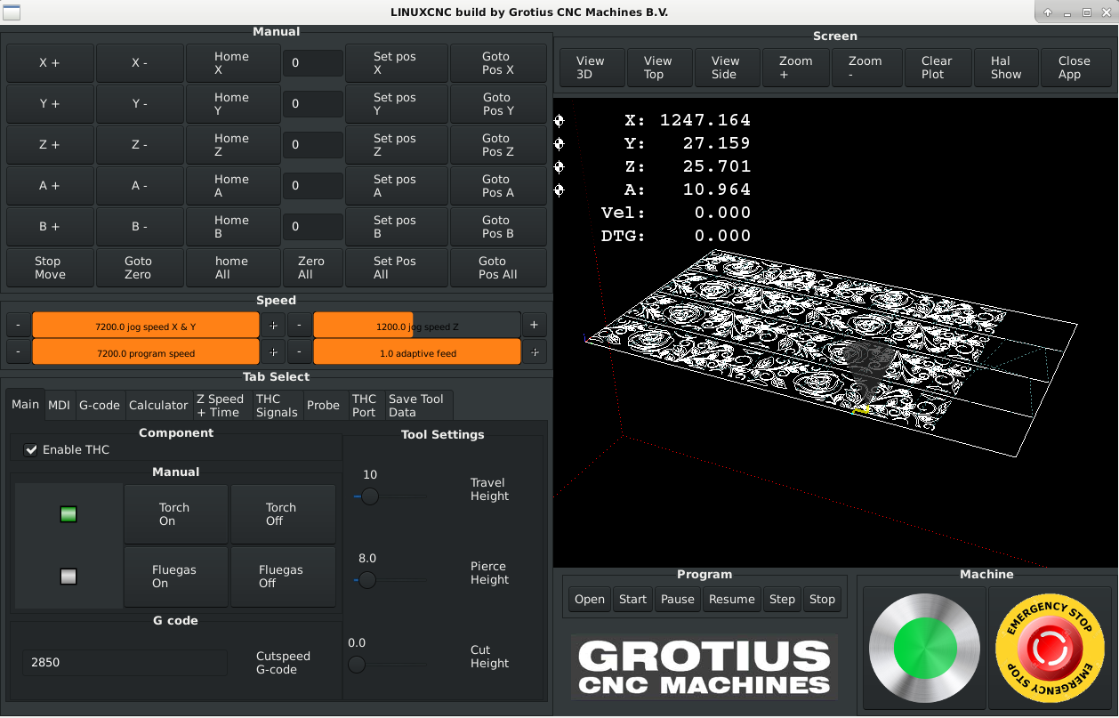

@Scuba,
The standard parport configuration when loading the Grotius gui is standard for double motor's on x axis. Homing procedure is commented (home) and outcommented (no_home needed) in the ini file. So it's easy to switch. You can look
at the file's how the homing is done. The homing procedure took me i think 1 or 2 day's at that time to make.
Maybe start your test config without homing procedure. And enable this later on.
Not sure if you want these types of things here or private messages.
Here please.
When your Mesa config is working save your ini and hal files.
Provide them here please with your type of Mesa Card's. I can upload then the config to the git channel, so next time you can compile the linuxcnc version and select your own Mesa configuration directly from startup panel.
I will call this config the mesa card + your scuba reference name. B)
I have modified the glade screen to fit for : 1280*1024 / 1680*1050 / 1600*1200 / 1920*1200 resolution's
Yesterday i made some update's to the git channel.
I have made own widget's and keybinding's files, simplyfied the widget file a little bit.
github.com/michelwijnja/external_offsets...r/lib/python/grotius

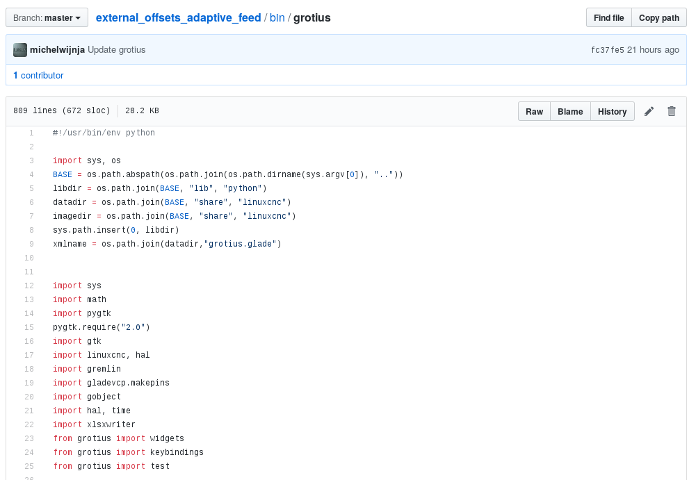

Now we are separeted from gscreen and gmocappy update's.

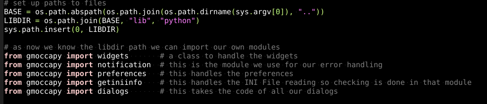

I have seen some coding in Gmocappy who is strange :
If you don't use the Libdir it is also working.
In the code there is a comment :
# as now we know the libdir path we can import our own modules
This is not True so far i tested. So maybe Norbert has used existing code that he thinks was needed.

Great to see ongoing progress. I had a bit of a play at the Python command line and it seems you need to import the sys and os libraries before defining BASE (tested in WIndows). Maybe Norbert imports those libraries elsewhere.
>>> import sys
>>> import os
>>> BASE = os.path.abspath(os.path.join(os.path.dirname(sys.argv[0]), ".."))
>>> BASE
'C:\\Users'
Make has its own syntax and there are many tutorials on how to use it. The documentation is here
www.gnu.org/software/make/manual/make.html
