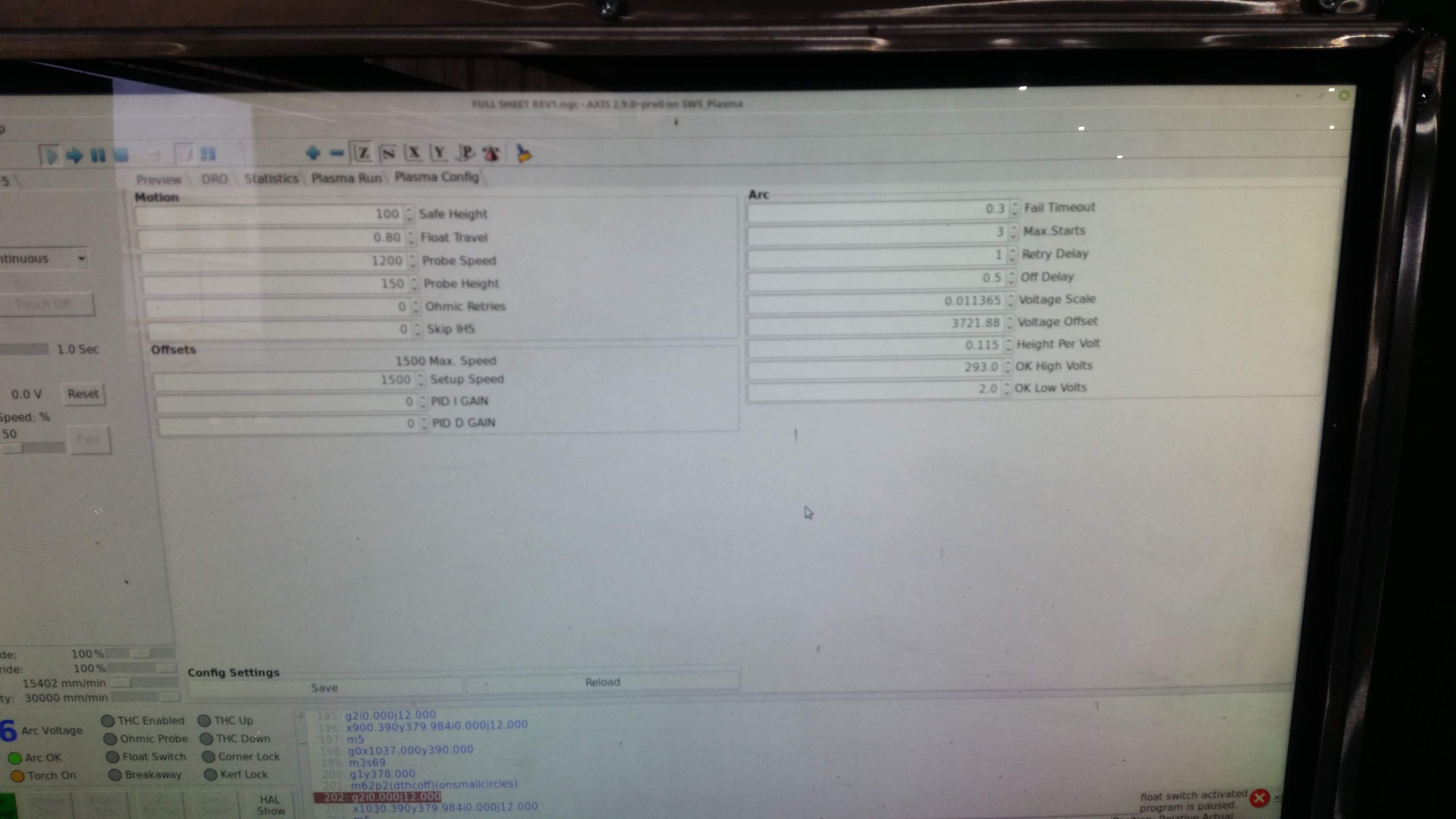

Phill,
Please see this video,
Its hard to see because the arc is so bright but basically at the end of the hole the arc goes brighter as it raises up while it is still cutting.

26 Jul 2019 07:11 #140622 by thefabricator03
Replied by thefabricator03 on topic Another plasma component...
Also this is my config settings,

26 Jul 2019 07:30 #140628 by phillc54
The Off Delay means the torch stays on for 0.5 seconds after the cut is finished. I think that is what you are seeing.
Can you post your GCode. If you don't want it made public you can get my email address off Rod and send it direct if you want.

26 Jul 2019 08:13 #140635 by Franklin
Replied by Franklin on topic Another plasma component...
Hi Phill, can you explain how the off delay should work?
I thought that should be a delay after the cut is finished before Z lifting up.
But the torch is stays on when the z axis is lifting up. It's right?

26 Jul 2019 08:26 #140636 by phillc54
Can you try decreasing the feed rate while you are cutting a hole

26 Jul 2019 08:30 #140637 by phillc54
It possibly should be this is my any inexperience showing.
Some input on this would be appreciated.
