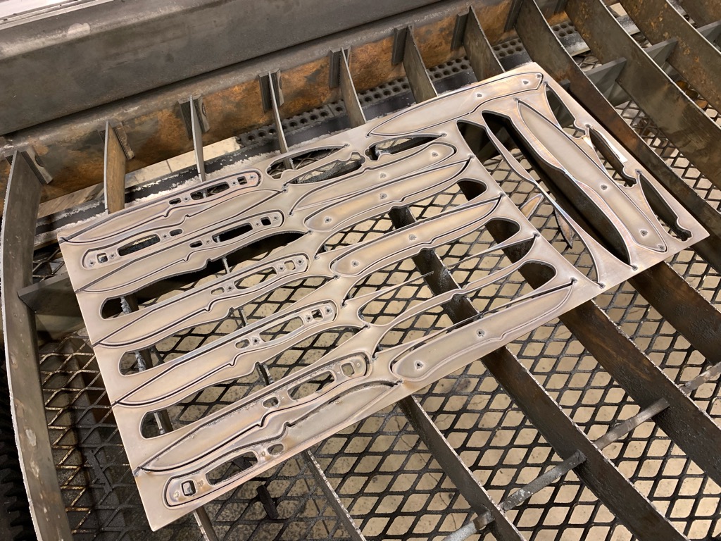

Im not a Linux programming genius, hell I could barely manage getting it installed. I don’t know if what I’m wanting can be added to the plasmaC or would need to be its own thing. The steel I cut is all high dollar stuff. Yesterday I cut up a 11”x23” sheet of stainless that cost me $100. So a mess up can be really costly and go down hill fast. Now I can’t cut it real fast as I’m running a 30xp and sitting at around 20”/min. I’m using sheetcam to nest and save it as a number attached to that sheet so I can load it back up and add more parts later and know what’s already been cut out. My issue is finding the exact starting corner. I have been using a square to get it square to the table and then bringing the torch down and moving over till I just barely touch the edge. Then set this as -.375 in g54 for x and y. This gives my just enough to clear the edge of the sheet. I do this because I set the edge of the parts at the edge of the sheet in sheet cam. This has eliminated the fudge factor guessing for me.
Yesterday I was wondering why could I not have a touch off button. The torch has ohmic so it could use that. Back when I ran cnc machines the new hass mills would load up a touch off tool. You would manually eyeball it over the corner and hit the touch off button. It would come down in the Z and find the top. Then move over in the X any Y a programmed amount and then come down a set amount and move over till it touches the side. It would set that as X and then retract and do the same for Y. It would then enter these numbers into the G54 offset.
If I could somehow build this function into my machine I would be tickled pink. We won’t bring up the other feature that would put it over the top. Well why not just mention it at least. Another machine I ran would touch off in 2 places on an edge and rotate the axis in the machine so the x and y would like up parallel to the sheet/part.

@JTknives
Probe screen ??? You already have the sensor, so a bit of editing and it should work.
The only problem is the torch need some empty space around the corner of the material to go below material and does your nozzle/shield extend enough outside to touch the sides of the material.

29 Jul 2019 22:00 #140924
by JTknives
Replied by JTknives on topic Another plasma component...
Yeah my shield I use is the standard shield that I have lathed off the nibs on the end. The shield sits about .01+ below the nozzle. I was using it with fine cut and with the fine cut shield but the touch off was damaging the nozzle so switched back to standard cut. I think the nozzle part is .625 diameter and sticks down about a 1/4”. I always hang the edge of the sheet over the slat edge.
- Posts: 21985
- Thank you received: 7485
29 Jul 2019 23:04 #140930
Replied by tommylight on topic Another plasma component...
That should do just fine, use the lower part for sensing as it looks not to be tapered, that way you get consistent results.
