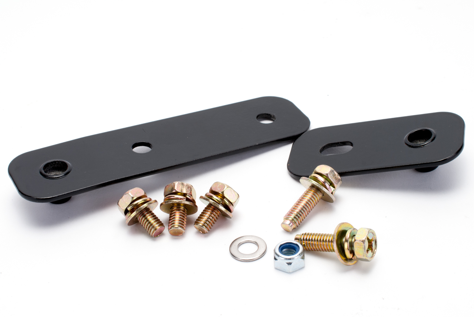

Tommy, apology accepted. I kinda agree, Plasmac is not quite ready for prime time for customers but its getting close I think. I really am very grateful that Phill has taken up the challenge to roll up all of the developments and experiments that have been undertaken in this open source group. I think John has made some valuable contributions over the last few years and really it was his decision to adopt it was what pushed so many people to try it. On the subject of holes, in 2mm mild steel, I've been able to get acceptable quality clearance holes down to M6 but drilled out 200 slightly undersize 10 mm holes for nutserts today. I have been getting these laser cut assembled and powder coated, partly becasue I was lazy and one part has a slight bend in it.
but with Plasmac's help, Ive got a set of 100 going out to powder coating in the morning. I bought one of these coll little vice brakes and it worked a treat to bend it/

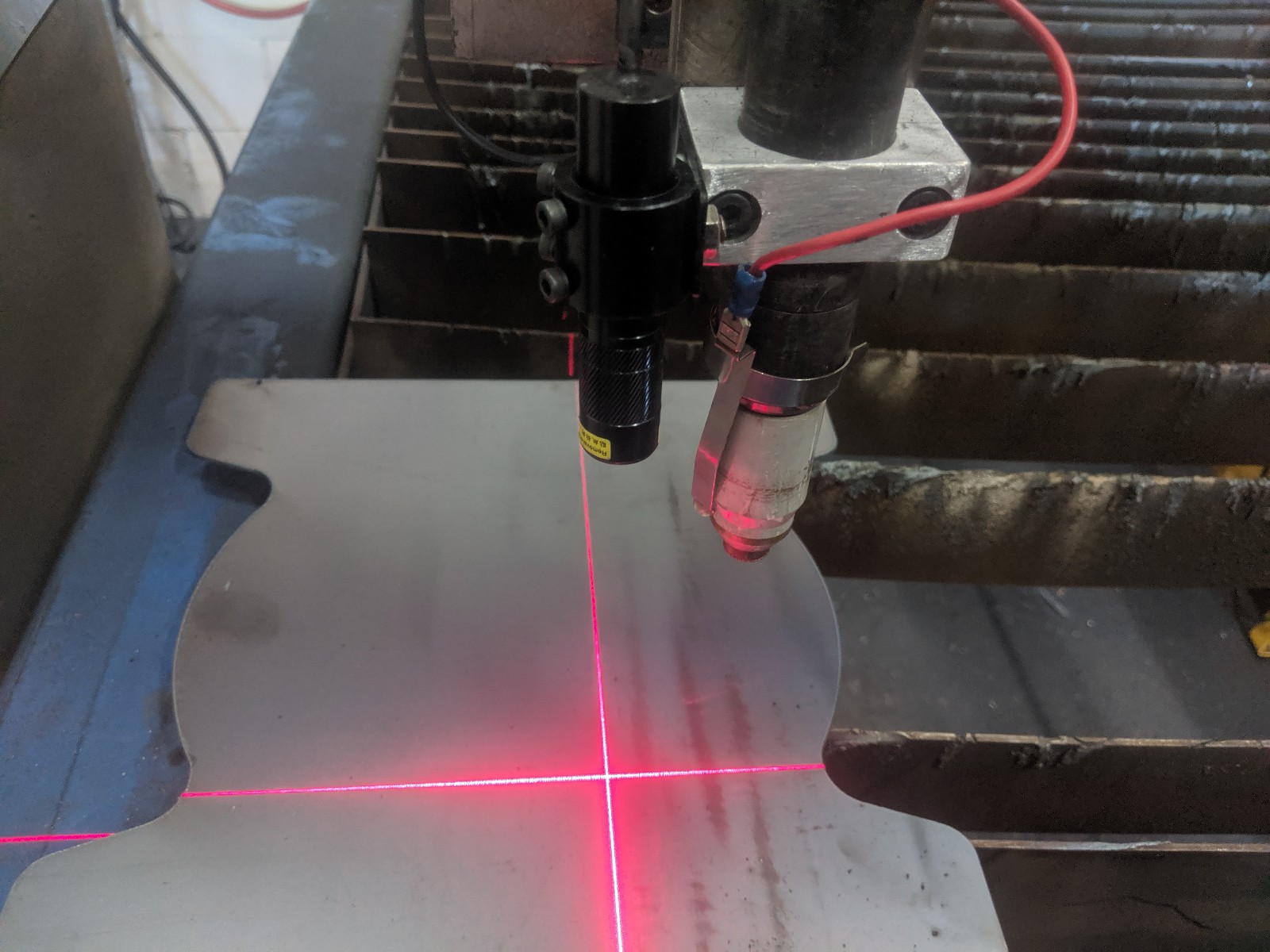

Anyway, in amongst a bit of business related Python programming, I managed to get this half installed on my table today.
I thought this laser pointer was a pretty good buy for $40. I had a tiny little one here that I had thought of fitting up but it was only a single dot and this one already had a mounting ring so it was real easy to fit using plasma cut plate screwed to the torch holder. I still have to wire this in to power. Unfortunately, the cables going up onto my gantry are all used, so I'm going to add a manual switch to turn this on. This is a 5 volt device and I purchased a small 24 volt to 5 v power supply which should fit into the existing metal box on the gantry.
I know its mounted fairly low but I found it had to be mounted well away from the torch if it was any higher so I hope it works out OK over time..
It is pretty square, just the material I put down isn't! I found just tightening the 4 grubscrews that hold the laser tube twisted it off square.
So if anybody has any ideas on how to handle the offsets to use this, I would appreciate some pointers. I know what I have to do to calculate the offset and square it. but its the software stuff I'd like to know a bit more about.

17 Jun 2019 13:53 #137126 by islander261
Replied by islander261 on topic Rods "Spaceship" Scratch built Plasma Cutter build
Rod
Several years ago on PS there was a guy that installed a switch on a pneumatic cylinder for probing. As I recall he had a couple of Gcode subroutines that he used for probing.
I would be inclined to just write a small MDI macro to do it since you are not probing. Move material or crosshairs to desired location then make an offset move to put the torch there.
I actually built mine with two laser line generators mounted 90 degree apart that cross under the torch. I use clear packing tape for a window to protect the lasers, it lasts about a month and then I put on a new piece.
