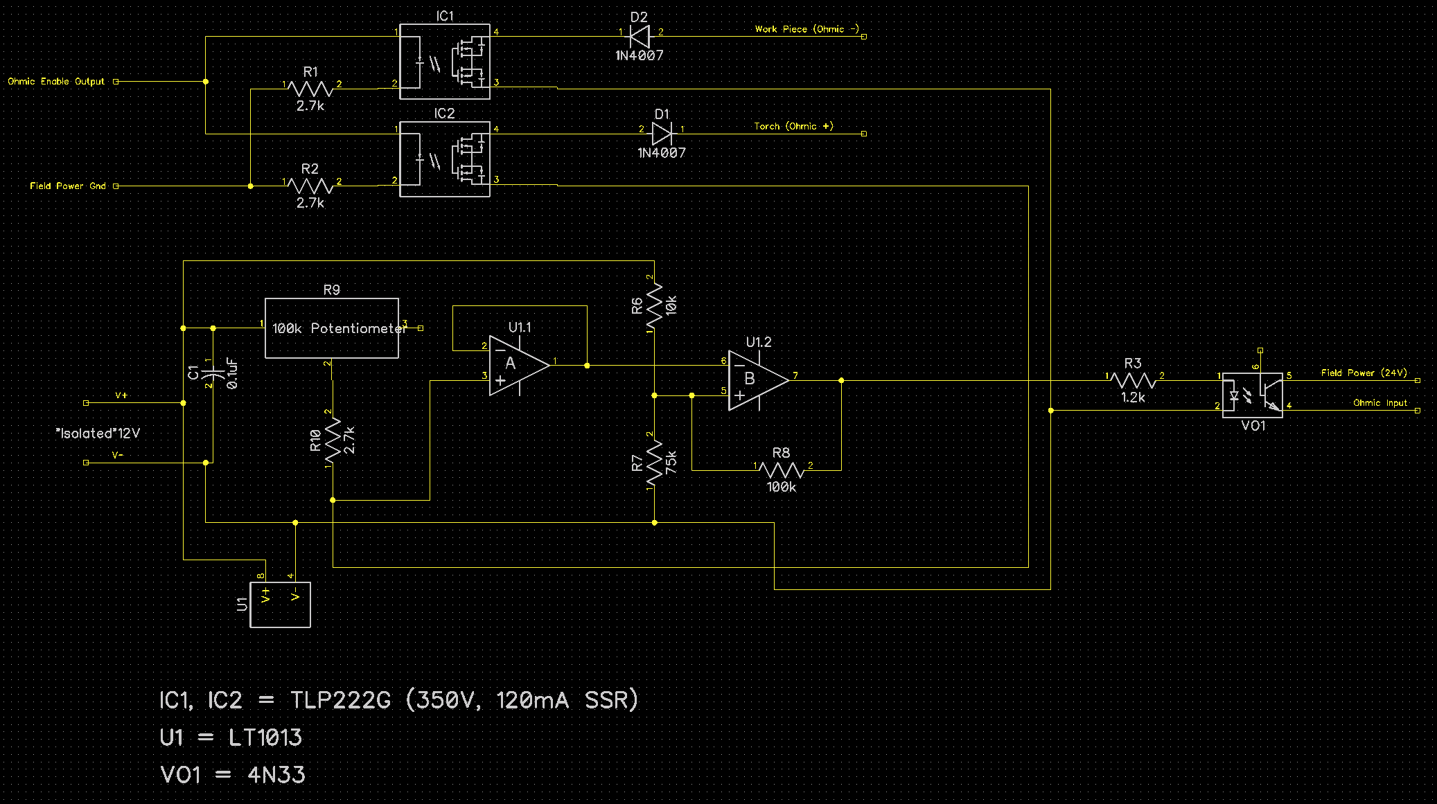

Steven, I'm not sure about John's ideas but I keep all my limit sensors powered up. My understanding is an estop should drop all motive power so my estop cuts mains power to the stepper motor power supply and also drops mains power to the ohmic sensing circuit as it is connected direct to the table frame. When I get there, it will also drop power to the downdraft fan.
I've attached the ohmic sensing circuit I use. It differs from John's as it only has one diode (the second one caused an induced voltage between the table frame and ohmic clip somehow. I also only have single pole relays so use two where John used one to isolate the ohmic sensor.
Over time, I ended up with 3 estops and it was not possible to wire them all into a mains powered circuit so I joined them in Hal using the estop-chain which fires a relay that disables the stepper motors on an estop (which is handy if you are on a limit and want to manually move off it.)

The estop interlock relay is how my commercial mill is wired. Now that I have used actually used LinuxCNC on a working machine for a bit over a year I don't think it is necessary but it does make for a nice check because until you come out of estop all the indicators are active.
Rod
I know you don't want to hear this again. If just removing the protection diode fixes your probing indicator you have a ground fault in your "floating" power supply circuit some place. This isn't ideal but just goes to show how good the 7i76E is.
To find the ground fault:
1. Disconnect all output connections on the "floating" power supply.
2. Connect a volt meter between the floating power supply +output and your table frame/slats (or the safety ground in your electronics cabinet).
3. Turn on your electronics cabinet and read voltage on meter. it should be very near zero.
4. Move the meter lead from "floating" power supply +output to "floating" power supply -output. It should be very near zero.
5. Intermediate results. If 3 and 4 both read near zero fault is most likely not in power supply. If 3 or 4 reads voltage near power supply output in absolute value there is a problem in the power supply.
6. Turn off electronics cabinet and wait for power supply output caps to discharge (have a coffee).
7. Set meter to ohms reading. Connect one lead to floating power supply -output and the other to table frame/slats (or the safety ground in your electronics cabinet). Read meter. Reverse leads and read meter.
8. Same as 7 but connect meter lead to floating power supply +output. You may see meter go from low ohms to high ohms here and that is ok.
9. Any reading below 100k ohms ( in industrial work we would be looking for over 1meg at 100v here) on either 7 or 8 indicates a fault in the power supply.
10. If none of the above yields a fault indication then the problem is in your wiring or other component. With the power still off and the external circuitry disconnected from the power supply use your meter on the ohms setting to check each node in your wiring until you find the fault.
The most likely problem is the the -output on the power supply is connected to safety ground (DIN rail clamp) internally in the power supply. The manufactures do this with cheap switch mode power supplies so they can meet EMI codes without adding more expensive filters. A less likely problem is that the ac neutral connection is connected to safety ground for the same reason.
Good Luck
John

docwelch
Rod
Good Luck
John

The isolated power supply for probing is only used for the probing circuit it is not the same as your field power for the rest of your I/O. When used with good galvanic isolation, opto module, relay(s), you never have conductive connection between your control electronics and the table chassis or work piece.
John
