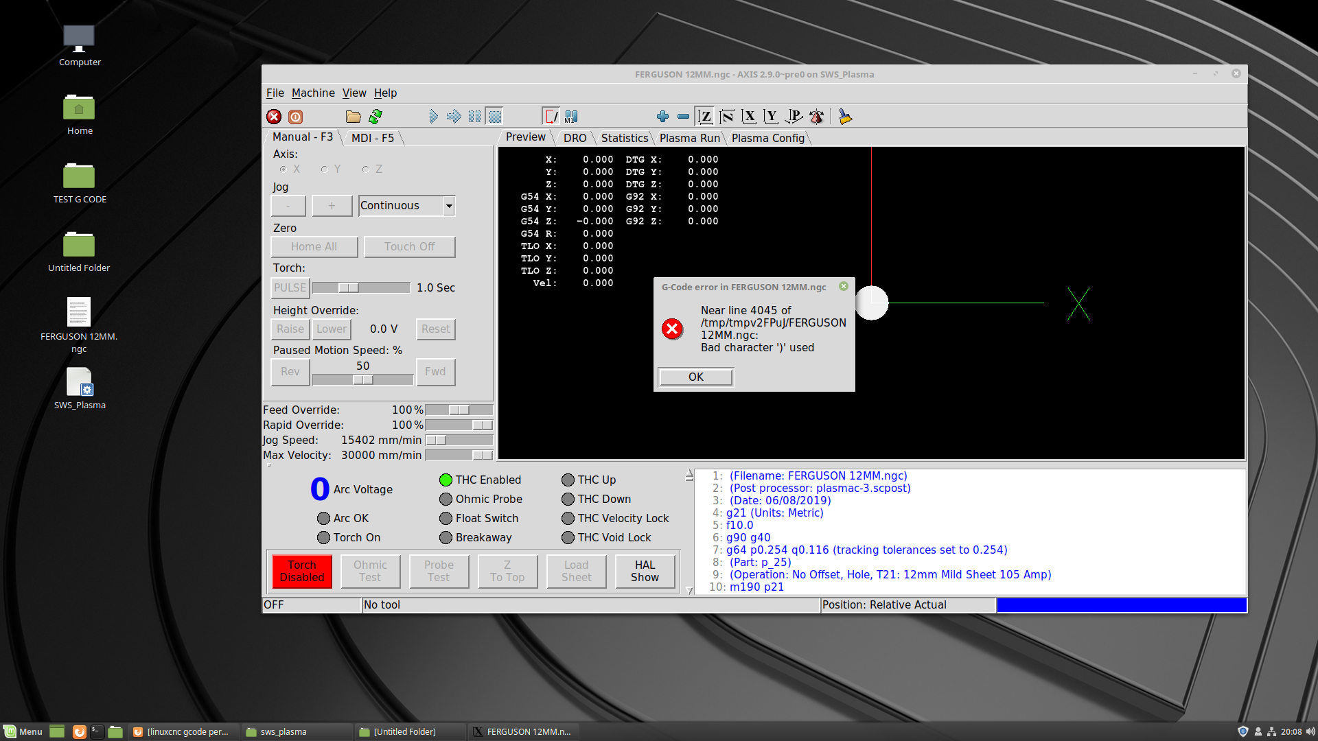

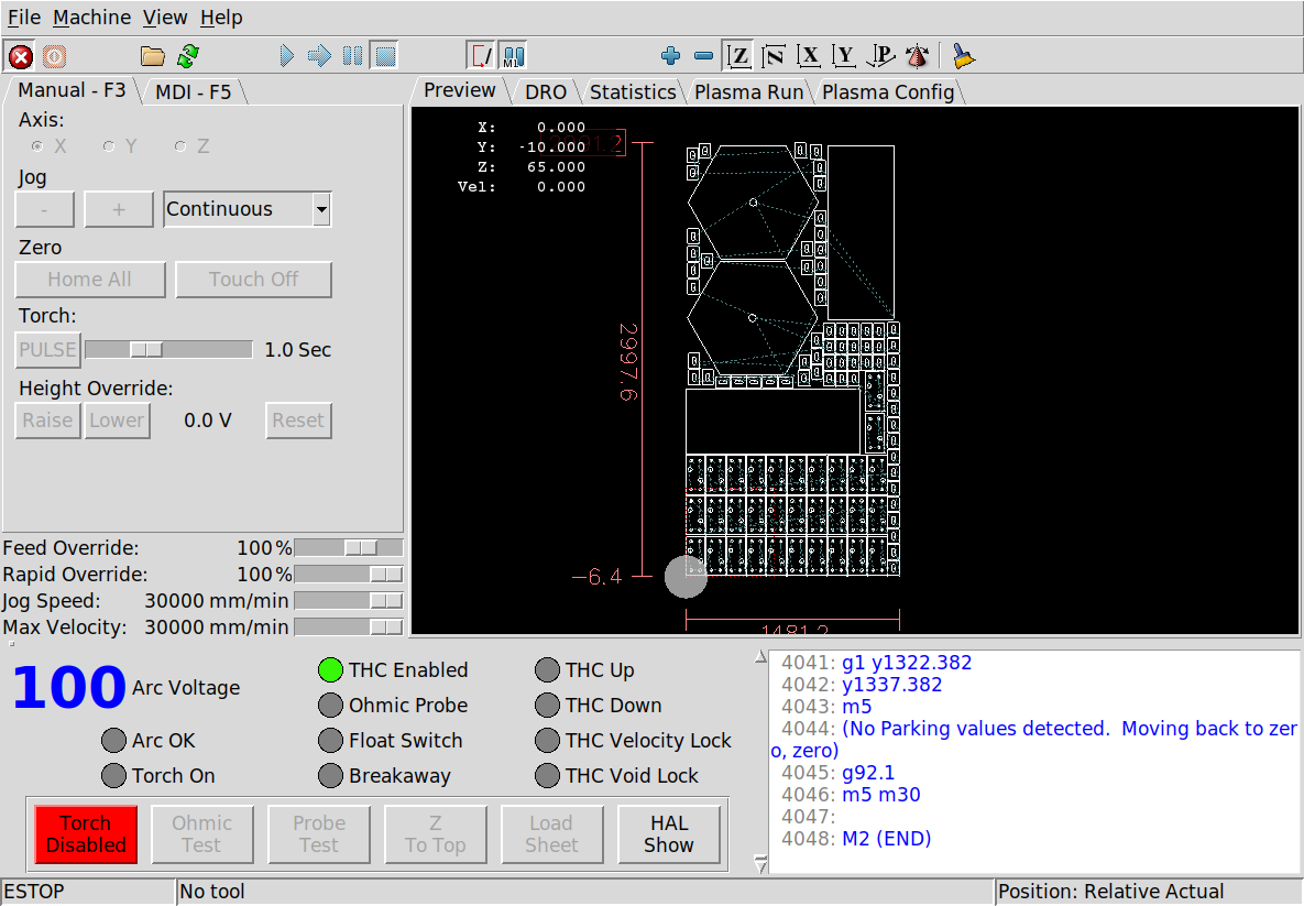

New problem Phill,
I tried that file you posted but no luck,
And I tried the fix above but get this error message, I had this Gcode file working previously on the un-updated config,
Last edit: 06 Aug 2019 10:10 by thefabricator03.
- phillc54
- Posts: 5711
- Thank you received: 2100
06 Aug 2019 10:45 #141507
by phillc54
Do the fix and the file I sent give the same error?
Can you post the ngc file
- thefabricator03
- Visitor
06 Aug 2019 10:47 #141508
by thefabricator03
Replied by thefabricator03 on topic Another plasma component...
Managed to get the G-code file to work after manually deleting the parking comment,

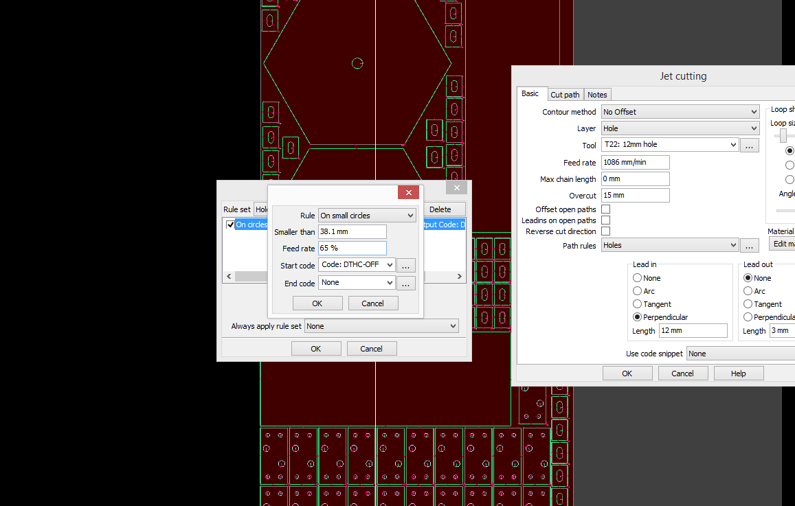

Another thing I have noticed is that my sheetcam hole rule is being ignored, I have it set that the holes will be cut at 65% of the outside contour setting. I check the speed when the holes are being cut and its the same as the outside contour even though I have the sheetcam rules set.
I have attached the G-code to this post.

- phillc54
- Posts: 5711
06 Aug 2019 11:33 #141512
by phillc54
I don't know what happened here but I can't see the attachment after I submitted the post yet it is there when I edit it so I will attache it here...
- thefabricator03
- Visitor
06 Aug 2019 11:43 #141515
by thefabricator03
I am using a post processor posted by John in this thread a while ago,
I have the sheetcam rules set as per this picture,
I will check that file out tomorrow as the machine is cutting at the moment.
I don't see any M67 codes in the file to reduce the feed rate.
- phillc54
- Posts: 5711
06 Aug 2019 11:50 - 06 Aug 2019 11:52 #141516
by phillc54
OK, I also ran that ngc file with #<pierce-only = 1 and it seemed to work as well, 364 pierces...
EDIT: I just noticed your code says DHTC-OFF, should that be something else? I know nothing about SheetCam
Last edit: 06 Aug 2019 11:52 by phillc54.
- thefabricator03
- Visitor
06 Aug 2019 12:03 #141517
by thefabricator03
No, DTHC-OFF is telling the controller to turn off the digital torch height control for the hole.
So it must be something in the Post processor that is causing it to not output M67 feed-rate code? Or could it be that it was never set up to do that in the first place. Just thinking about it and all of the parts I have cut up until this point I did not need decent holes so I must not of noticed it.
- phillc54
- Posts: 5711
06 Aug 2019 12:18 #141518
by phillc54
Sorry I can't help with that, but it may have had something to do with the problem you mentioned about some holes earlier on.
Hopefully Rod or John will chime in.
