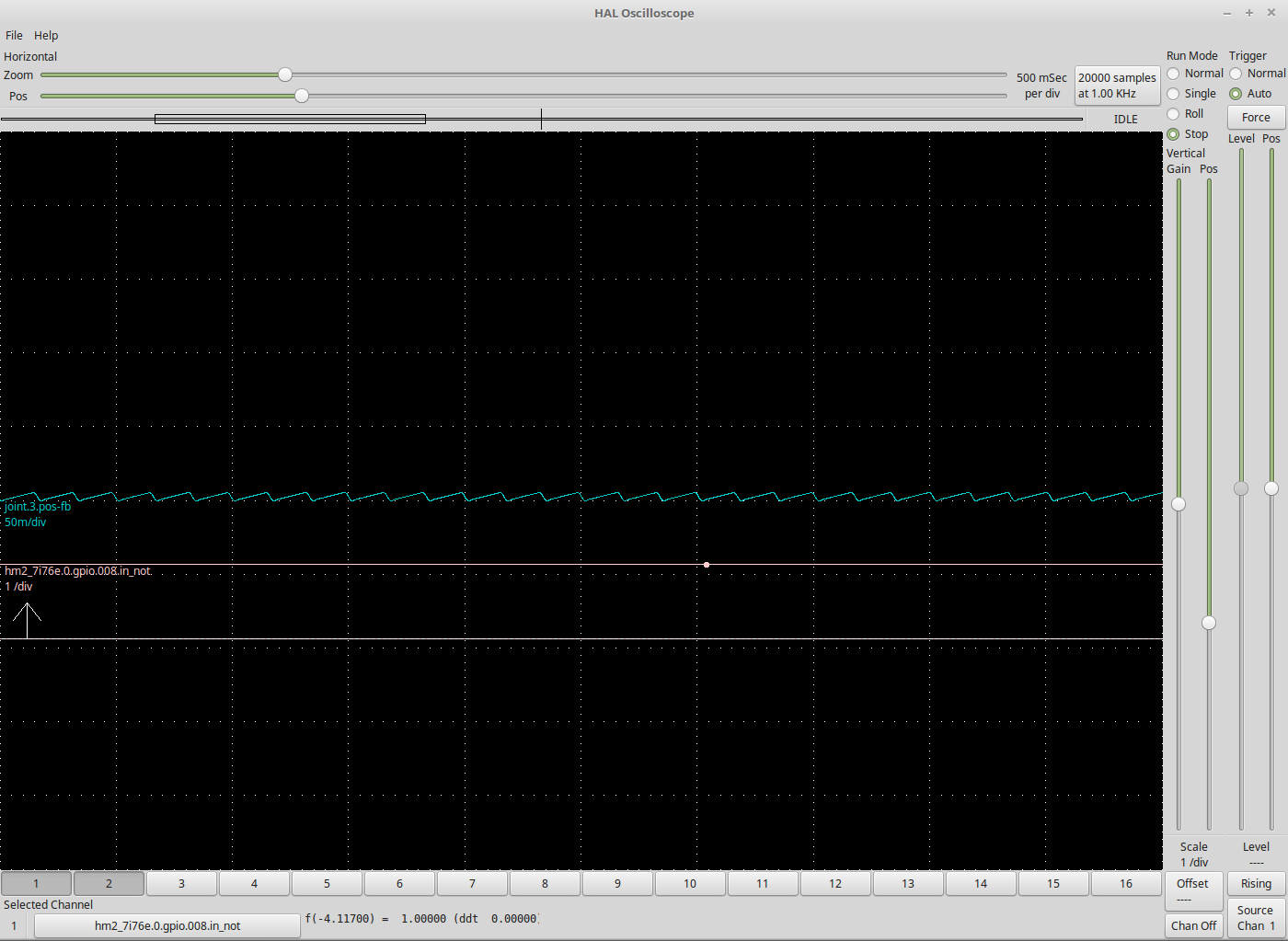

03 Apr 2019 22:34 #130240
by islander261
Replied by islander261 on topic Another plasma component...
Phill
I had a try at using the probing test pin without much joy.
In my .ini file:
In the machanics.hal file:
The macro:
What happens when the macro is called is that the torch lowers to Z1.0 and then starts probing down until it contacts the plate. The Ohmic Probe LED on the GUI becomes active. The torch then moves .005" one way and then back .005" the other way. The Ohmic Probe LED sometimes briefly changes state back and forth. This happens at about 7hz by halscope. At the end of the 30 second delay the torch then raises to Z1.0.
The Z axis FERRORing is a major problem that I have got to find out what is happening. I now have the FERRORr and MIN-FERROR at rather large values compared to my working configuration. I have also changed MAX_VELOCITY and MAX_ACCELERATION to values much less than my working configuration while leaving OFFSET_AV_RATIO at .5. So someplace the Z is being asked to move fast than the hardware step gen can change values. This is a stepper system so the actual physical movement is not known to the controller. Even jogging faster than the slowest rates seems to have problem on the Z axis, again my other configuration doesn't do this.
John
In my .ini file:
[MACROS]
MACRO = probe_testIn the machanics.hal file:
net plasmac:probe-test motion.digital-out-00 => plasmac.probe-testThe macro:
O<probe_test> sub
G01 Z1 F10
M64 P0
G04 P30
M65 P0
O<probe_test> endsub
M2What happens when the macro is called is that the torch lowers to Z1.0 and then starts probing down until it contacts the plate. The Ohmic Probe LED on the GUI becomes active. The torch then moves .005" one way and then back .005" the other way. The Ohmic Probe LED sometimes briefly changes state back and forth. This happens at about 7hz by halscope. At the end of the 30 second delay the torch then raises to Z1.0.
John

03 Apr 2019 22:46 #130241
by islander261
Phill
Here is a better halscope screen shot.
John
John

04 Apr 2019 00:50 #130249
by islander261
Phill
I found another boneheaded error in my mechanics.hal file. This fixed the Z axis FERROR problems but did not fix the probing-test. What halscope data do you need?
John
