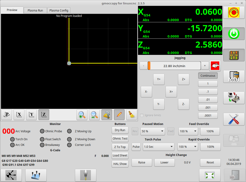

I fetched this mornings update for the branch. Thanks for moving the tabs. Please see attached screen shoot on my new screen.
Problem. I went to cut a sheet of parts and make video and no joy. Back to same old probing problem, torch goes down and touchs sheet, Ohmic Probe LED comes on, Torch just bounces up and down +/-.005" while Ohmic-Probe LED intermittently changes state. Same response when trying to run a program and when doing a test probe. What do I need to check for? I think the last plasmac.comp I was using yesterday was dated 03 April.
John
John

I see you show the arc voltage as an integer. Is this normal practice for plasma?
Cheers, Phill

I just want a display that isn't jumping around too much.
I am different than most users in that I mostly cut one material and thickness. So if we use the HT rule that you need to hold your cut distance to better than +/-.005" for good cut quality. This is about +/- 6 arcvolts on my system (.070"/74v=.000810811in/v). If you are using standard Duramax consumables you are closer to +/-11v. I find on my system using a THCad card for arc voltage measurement that I get about .1 to .2 scaled volts noise whether I am cutting or not. So for me not seeing any fractions is ok. On the system I built I can only set the arcvoltage to a 1v resolution.
John
John
