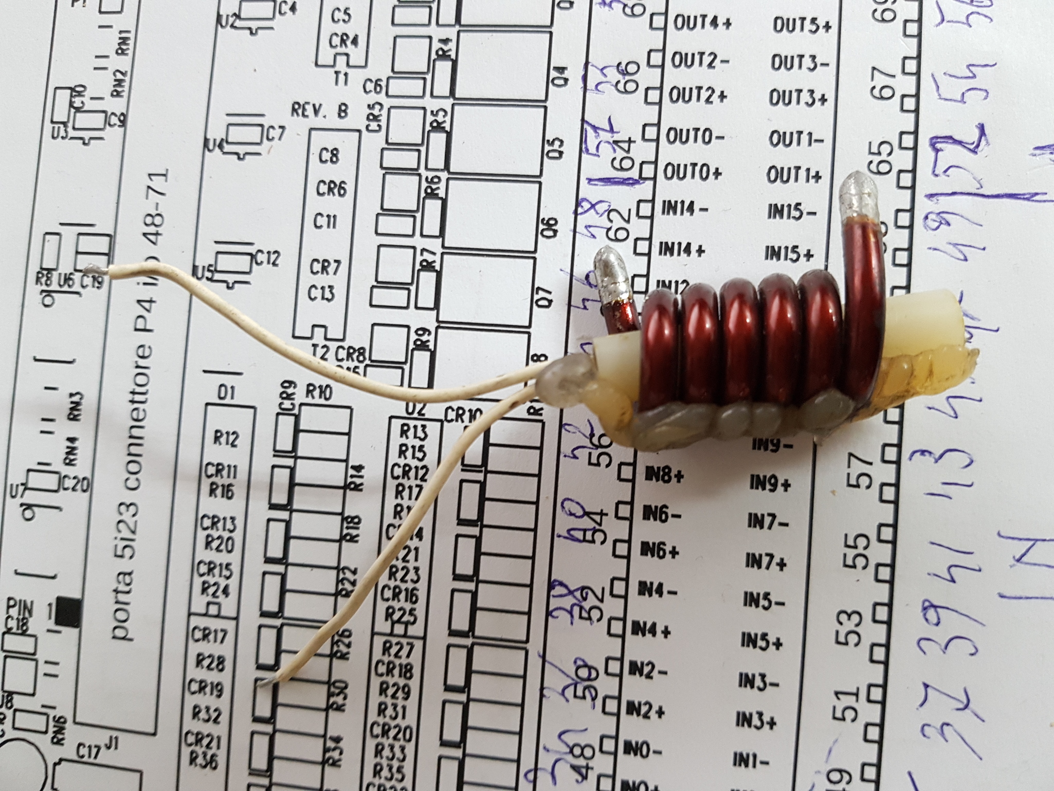

for arc-ok I used one of these, recovered from a broken plasma.
in practice it is a contact in a glass bulb that closes with the magnetic field that flows in the coil, it is inserted in series to the positive and generally closes already with 5 amps.
for information inside the machine it is used for the transferred arc signal
