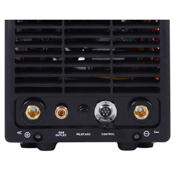

Replied by tecno on topic Low budget plasma setup, what do I need?
How do I connect a torch like AG60 / SG55 to my THCAD300?
- Posts: 12159
- Thank you received: 4151
21 May 2019 09:09 #134456
Its nothing to do with the torch, just connect it to the raw arc voltage
Replied by rodw on topic Low budget plasma setup, what do I need?

21 May 2019 09:20 #134457
by tecno
Is this at the tip or outgoing connector in chassis?
- Posts: 12159
21 May 2019 09:42 #134460
I think I would try and mount it inside your plasma cutter. That way there are no lethal voltages leaving... BUu I think the 5v power supply needs to come from the control box.

23 May 2019 02:08 #134645
Replied by tommylight on topic Low budget plasma setup, what do I need?
That connection should be made as close as possible to the rectifier inside the plasma cutter, if it has no connector already.

- pl7i92
- Posts: 1872
- Thank you received: 358
26 May 2019 15:57 #135014
by pl7i92
Replied by pl7i92 on topic Low budget plasma setup, what do I need?
Use real tiny Cables you only need the Voltige so no Amps are going over
and keep clear isolated to any other lines
- tecno
- Posts: 1850
- Thank you received: 127
26 May 2019 16:14 #135017
by tecno
Yes that I understand, but does this high-voltage input have sensitivity for for the pilot-arc voltage? I assume the Pilot-arc is already divided down?
