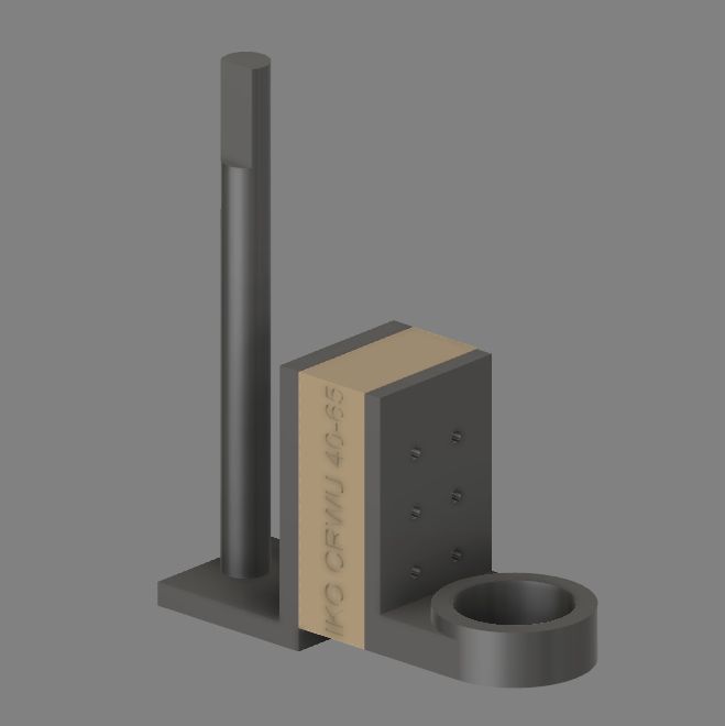

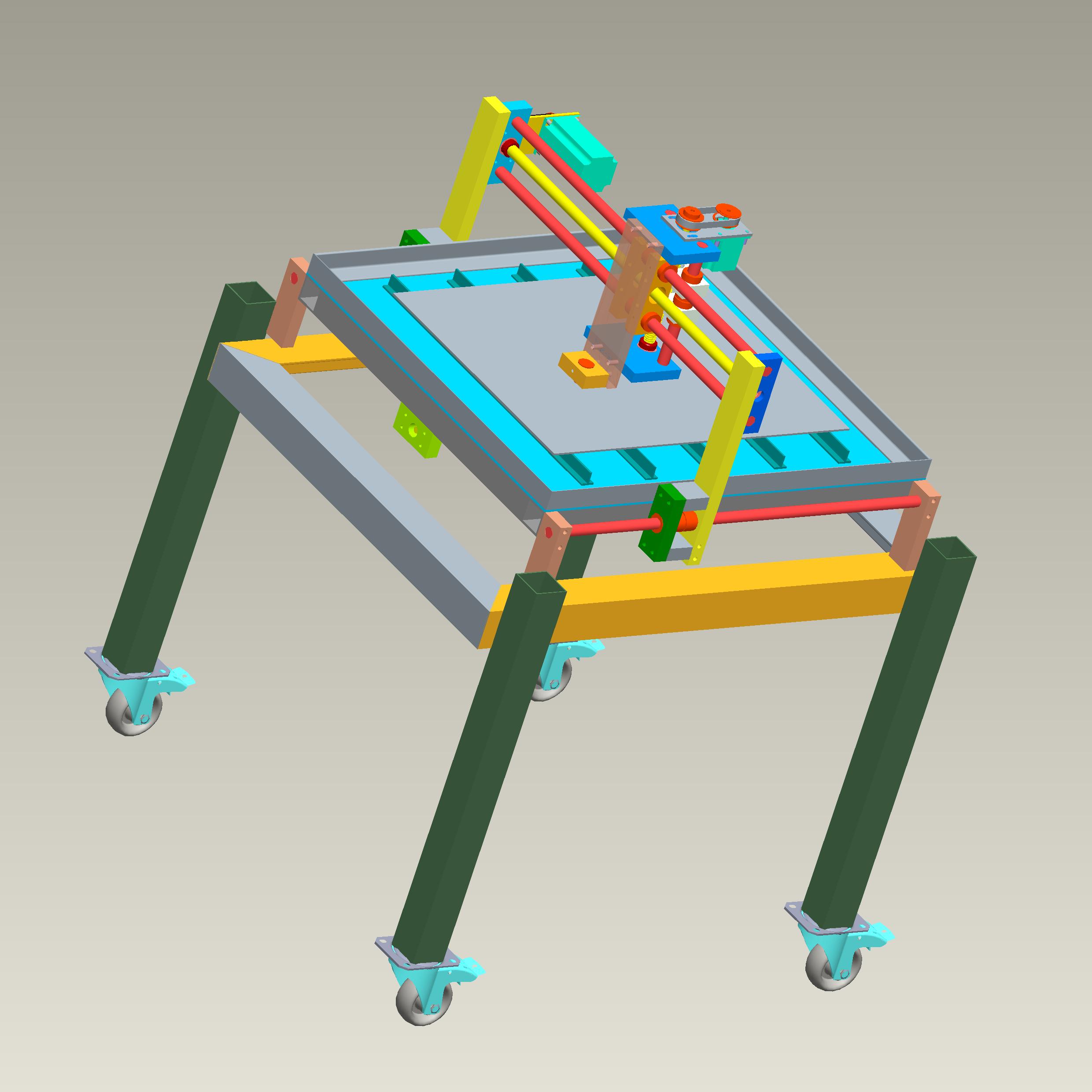

28 Apr 2019 08:33 - 28 Apr 2019 08:43 #132175
by tecno
Replied by tecno on topic Low budget plasma setup, what do I need?
Last edit: 28 Apr 2019 08:43 by tecno. Reason: added picture

28 Apr 2019 11:28 #132186
by tecno

28 Apr 2019 20:40 #132227
Replied by tommylight on topic Low budget plasma setup, what do I need?
One rail on each axis, linear rails, mind you. Nice!
That should work nicely for that size.

- pl7i92
- Posts: 1872
- Thank you received: 359
29 Apr 2019 01:38 #132246
by pl7i92
Replied by pl7i92 on topic Low budget plasma setup, what do I need?
im not going with toms suggestion one rail at a 800mm Span
you need to go double rail even if you use SBR12 better then leave it with dirt running on aluminium
and on that size it is a posible middle Ballscrew drive
as special as he gots very stiff framing
he also planing to use a water plate you need no more then 2inches of water table hight pool seeling clue is enoff to hold the metal together
at that length and width hight
if you use L-profile it will give you even more stiffness
