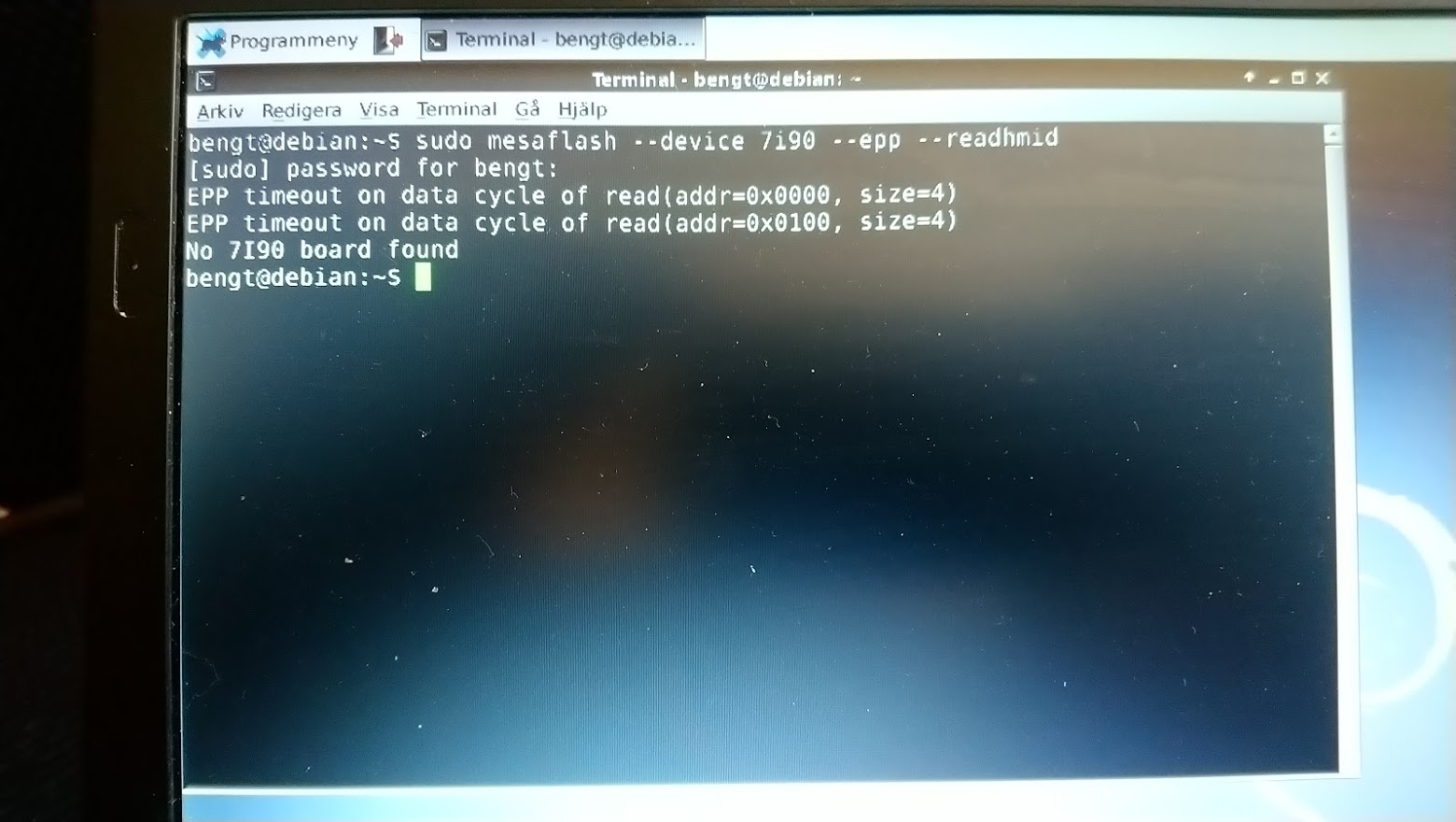

This Shuttle box is not working OK, hardware errors running latency-histogram with or without GLX.
So I will have to find another candidate.

Which LinuxCNC version / realtime system?

I would definitely suggest trying the Stretch ISO then.

Have to check first that my 7i90HD is ok, did not get mesaflash to find anything on --epp
Is Stretch OK with PPort?

Yes.

It appears be something wrong with my 7i90HD so I think I will try something else for my simple plasma setup.

Did you make sure that your parallel port is set to EPP mode in the BIOS?

You typically need to go in to the BIOS to enable EPP for motherboard parallel ports.
I am not sure how you do it for PCI cards.
