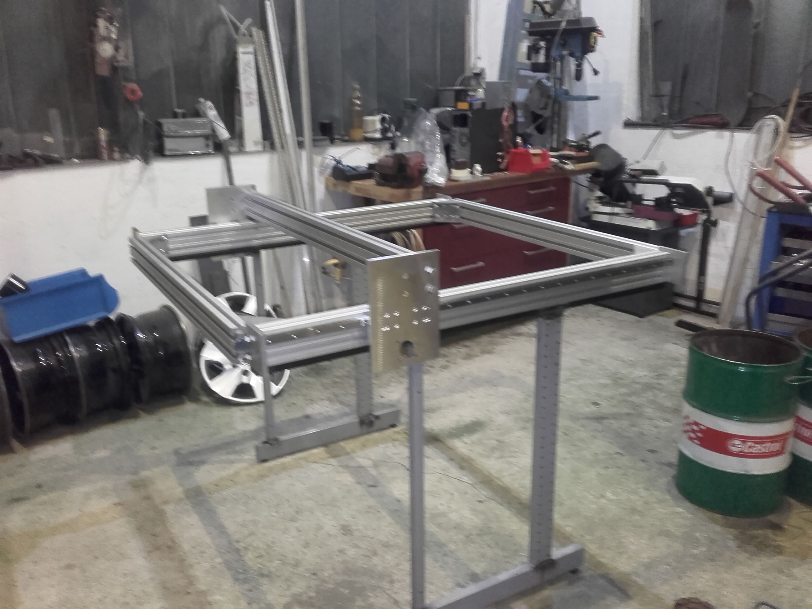

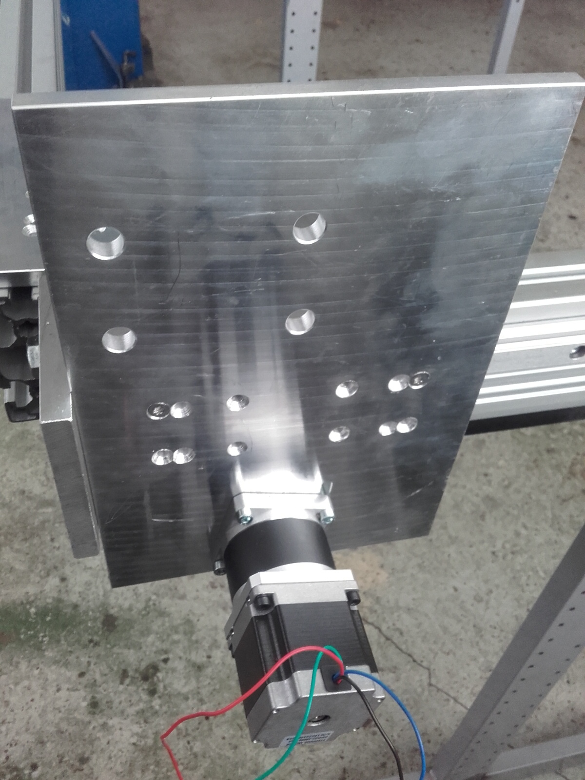

Hello after so long.....some updates for you....

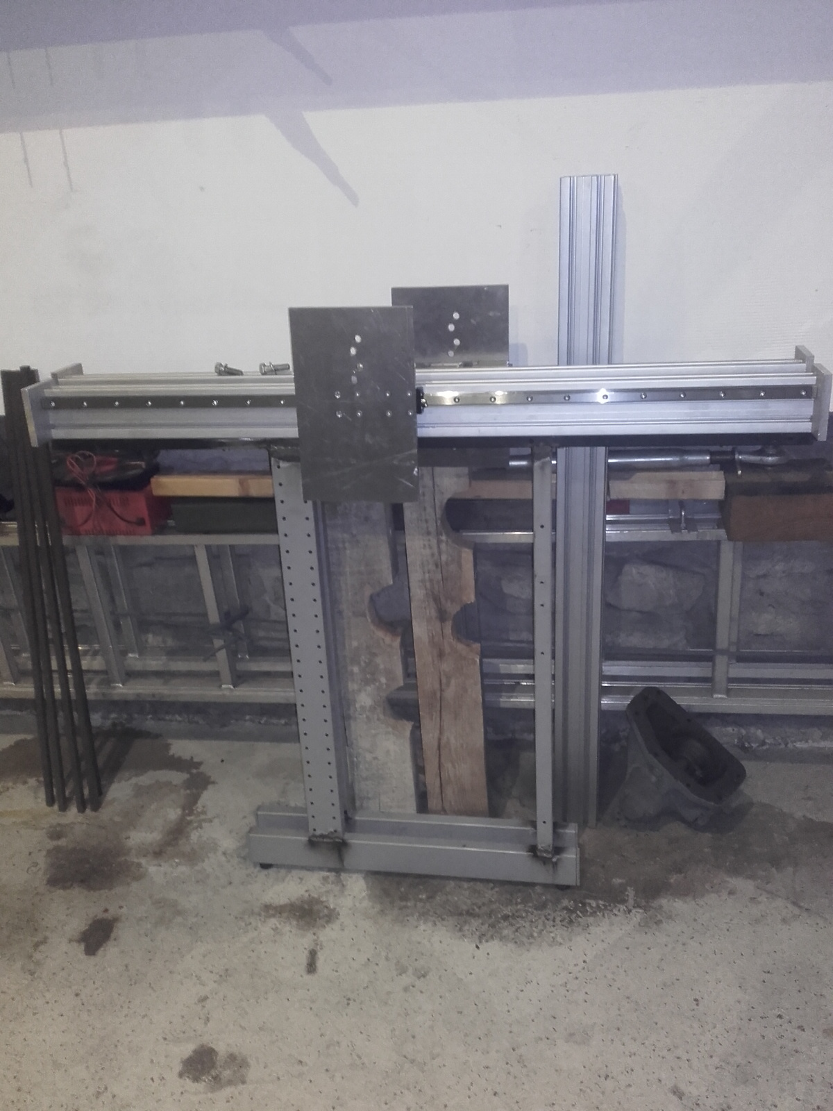

I am making progress... Finally found time to start building after collecting all the parts.
Lucky I was that the motors with the precision reduction gears 5:1 made the gantry design easy.
racks are leaning on the left side
An old table was used and shortened. Not knowing what the actual size will be(width) ... I wanted to make the top ready to use it to straighten and set it perpendicular ... Means starting from top to bottom ... Now I am more experienced and can calculate it.

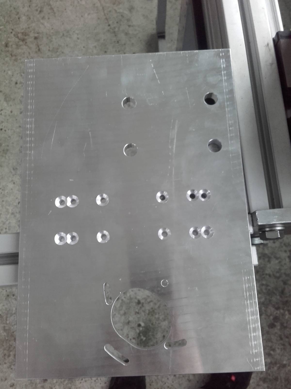

Had to learn fusion 360 and design a view things... Gantry plate...

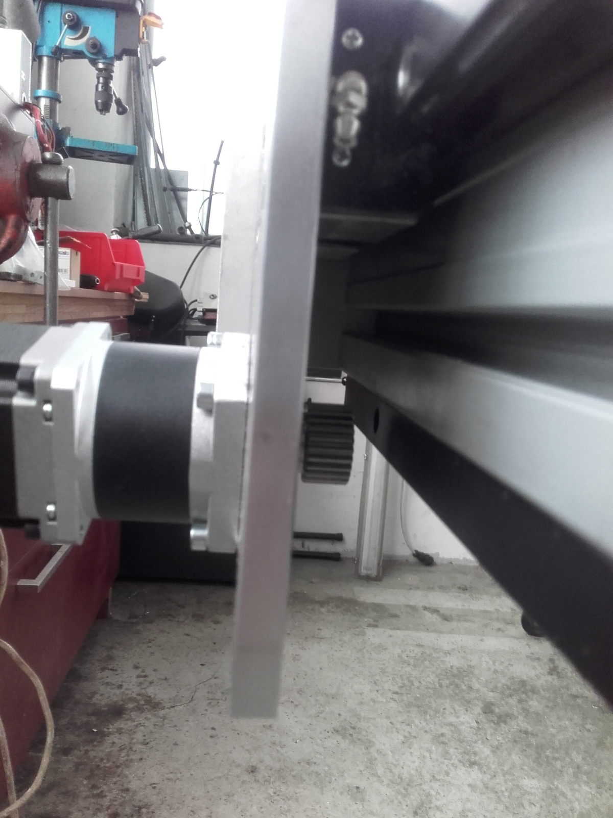

The rack will be mounted underneath with iron angles which will funktion like spring-loaded. The motor can be turned on the gantry and pressed against it.... Let's see... If it works..
Racks will come here...
3dprinter is great..

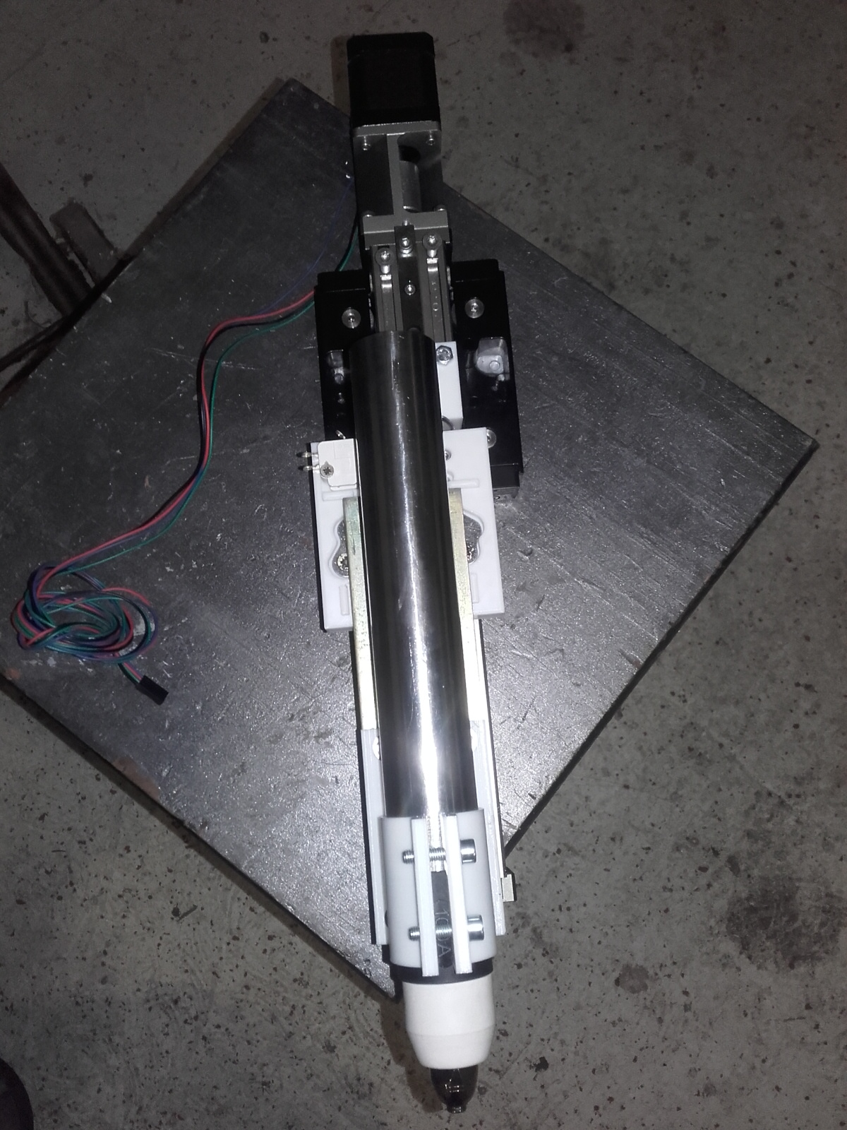

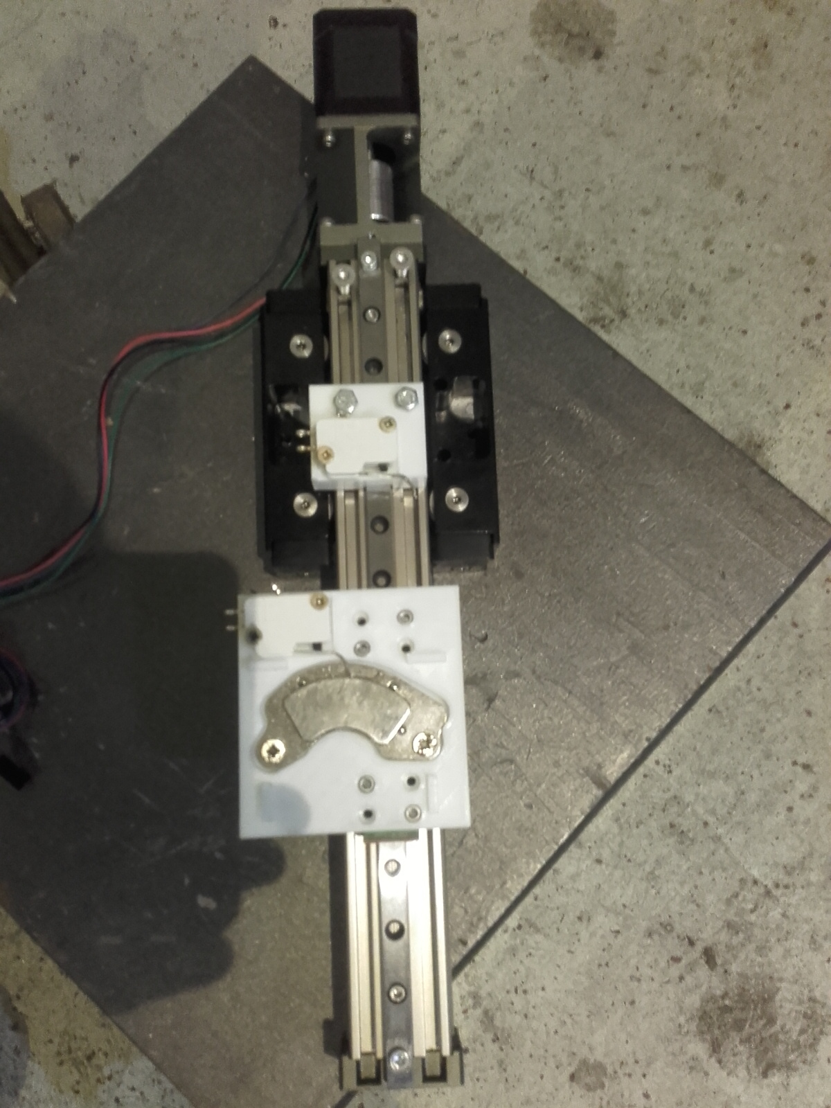

Magnet from old Hard disk.. Breakaway protection... Torch holder...limit switch...
Mounted linear rail on Z axis.. Hope gravity is enough to bring the torch down.
Needs shortening...

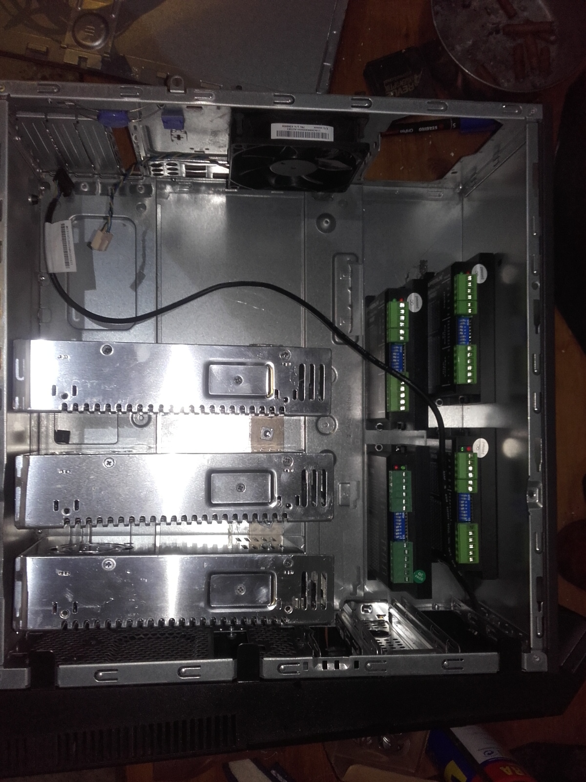

Started electrical setup...
I still have lots of questions... But wanted to let you know there is an outcome eventually!
