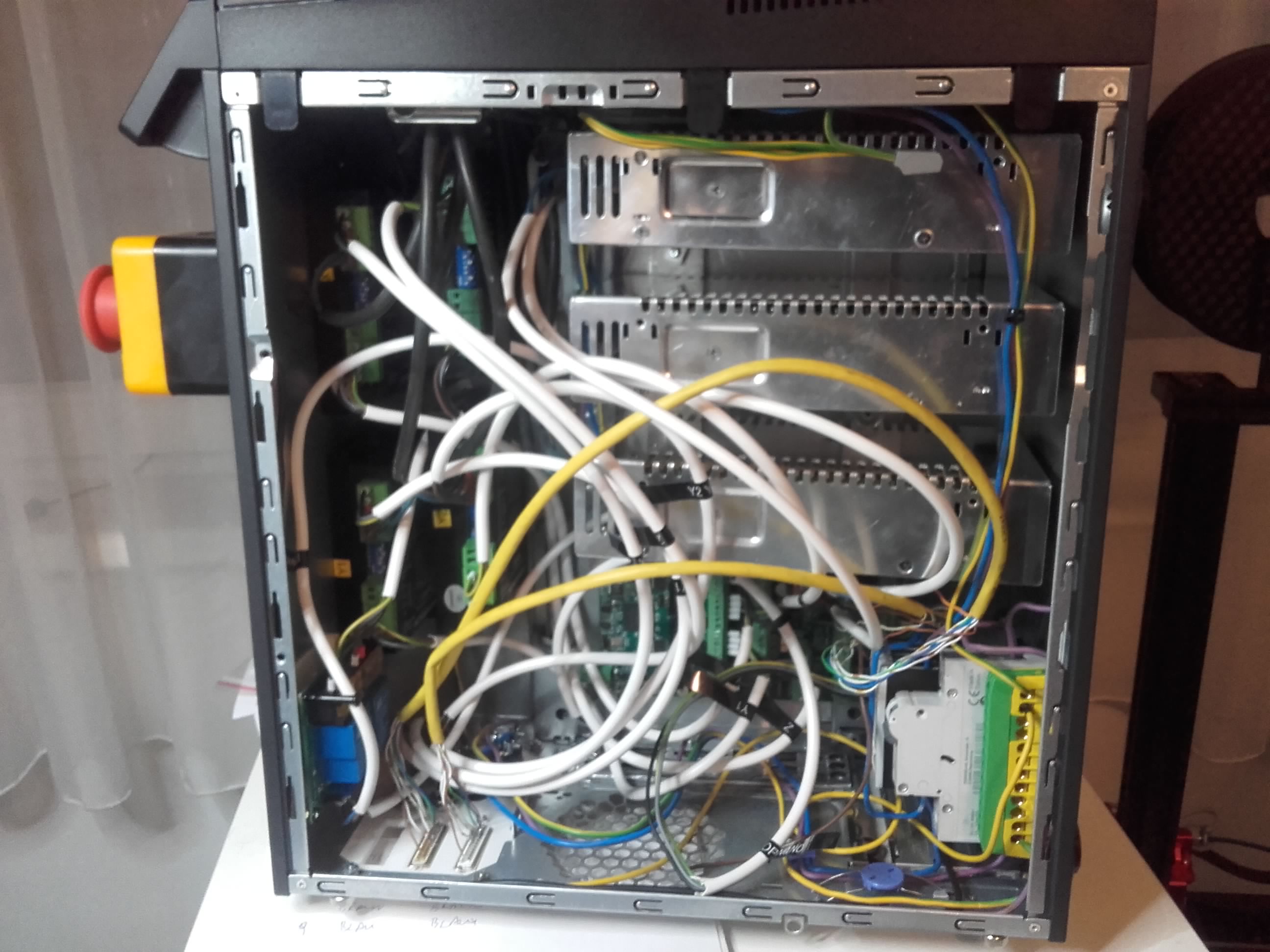

Replied by PCW on topic Plasma Torch, first try and lots of questions
Yes, you can contact Mesa directly,
I asked specifically about switching the DC side of the field power because
if the card is repaired/replaced, if you switch the DC Field power, the
repaired/replaced card will be damaged as well.
(BTW do not apply fieldpower to the damaged 7I76E avoid further damage)

Mr. Wallace from mesanet old me tomorrow an rma? But didn't mention repair on warranty.?
- Posts: 18104
- Thank you received: 5328
01 Jan 2020 16:28 #153726
Yes, we will do a warranty repair/replacement

Me too. I ended up buying 10 of them to keep up with the smoke signals!
With the 7i76e, there was no way it was powered up until it was fully mounted though
Replied by rodw on topic Plasma Torch, first try and lots of questions
I smoked my 7i76e today
I have destroyed a few arduinos because I did not have spacers under the boards and I put them down on something metal bridging contacts.

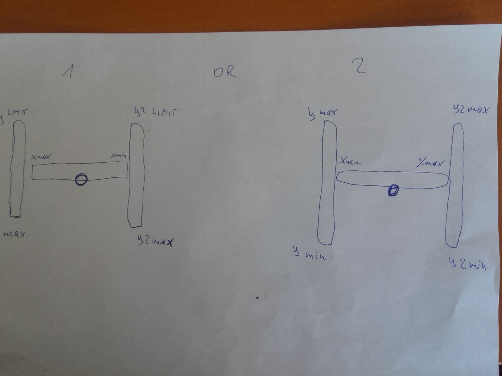

I have mine set up as per #2.

does the tool coordinate system differ when you setup 1 or 2 ??
I have a problem understanding machine coordinates and tool coordinates..
I thought tool coordinates change from + to - and Gcodes then as well ...
