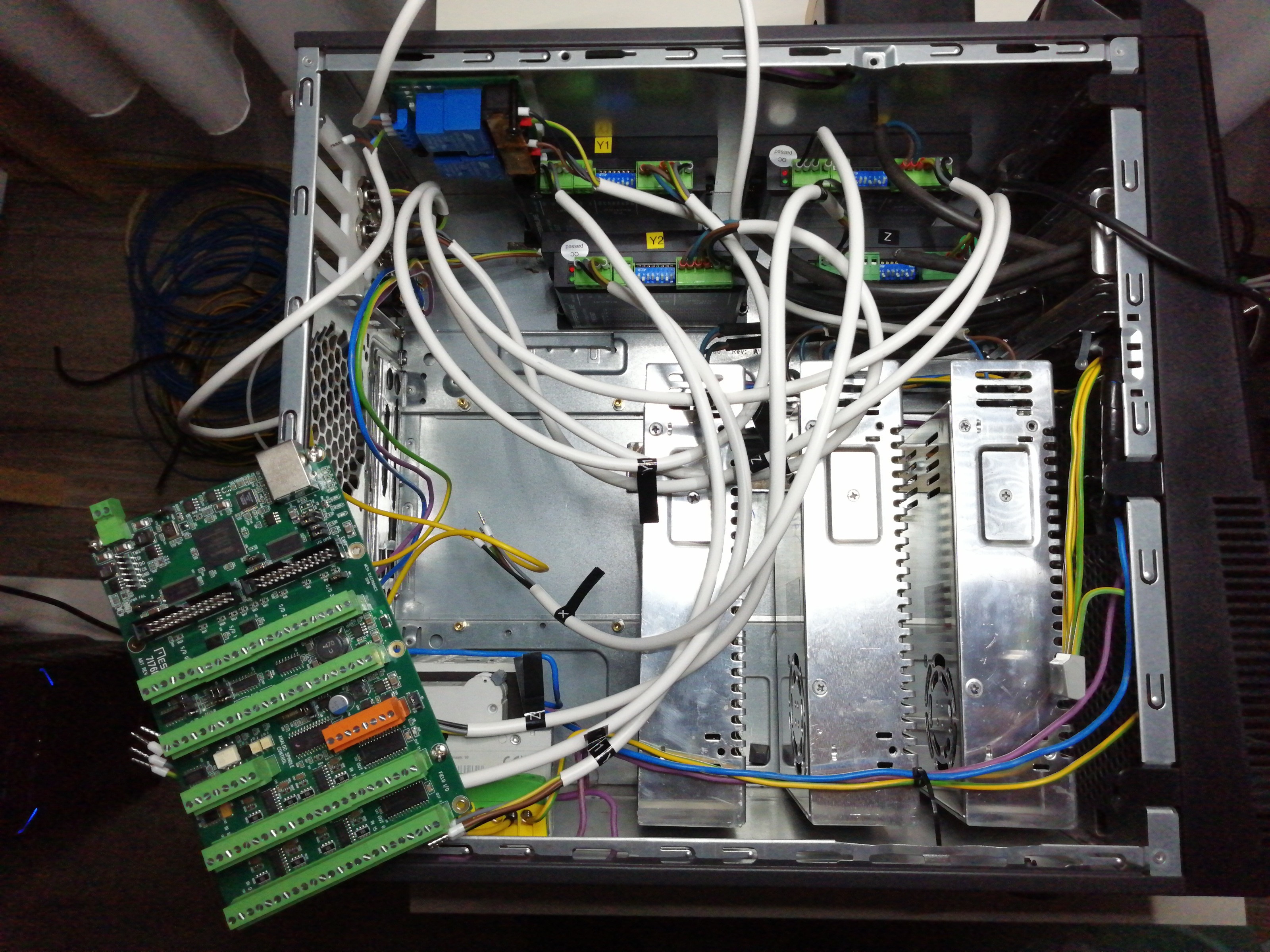

Was struggling with finding my 7i76e....nema17 DM542 working nema23 dm556t only noise not turning with microstepping doing funny things... ..
Reason: the power supplies.. When connected power of drivers and 7i76e when power supplies were on already NO PROBLEM!
just leaving this hint here when somebody has same problems.
  • CNCFred
  • CNCFred's Avatar Topic Author
  • Offline
  • Elite Member
  • Elite Member
01 Jan 2020 09:34 #153718 by CNCFred
Replied by CNCFred on topic Plasma Torch, first try and lots of questions
Changed the setup.. So all power is on separated switch...
I smoked my 7i76e today was maybe not a good idea... To turn motors on first then 7i76e....
So there will be no messages from me for the time being.....
In case somebody can repair that thing... The chip close to power in burned off....

01 Jan 2020 09:44 - 01 Jan 2020 09:45 #153721 by PCW
You will damage a 7I76e if you switch the DC field power...
We have also had a high failure rate of our last lot of cards
so we will repair/replace the card under warranty, but make sure you
do not switch the DC field power (switch the AC side of the supply)
We expect to have a more rugged ( more tolerant of transients from switching DC side)
7I76e version out in 1-2 months
