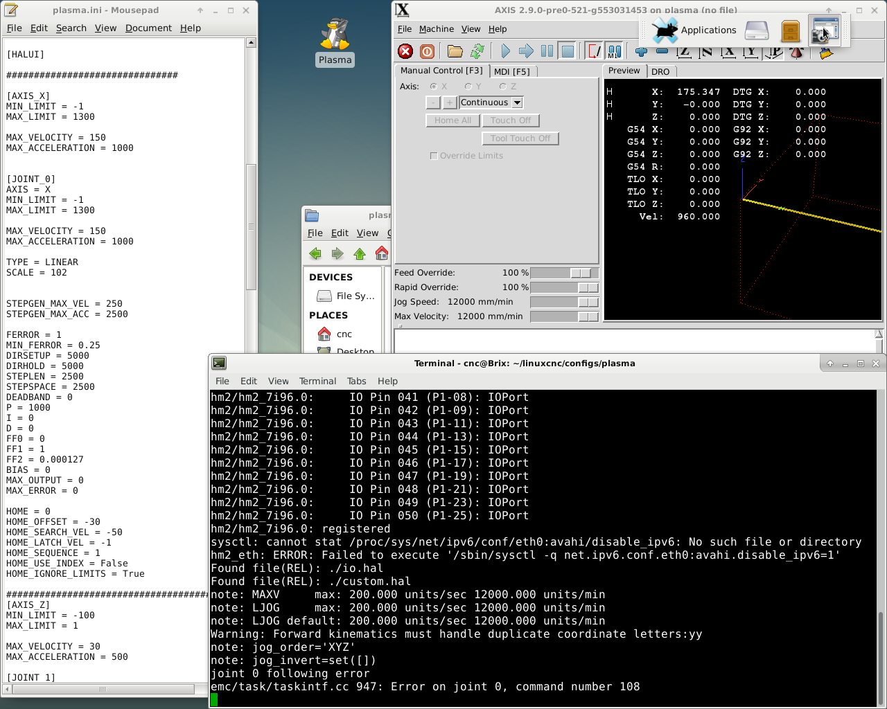

Ok had a go at settings as you suggested. Can we just concentrate on the X axis first
The machine homes ok on all axis but I still get a following error on joint_0 if I try and increase the MAX_ACC to 2000 (it is ok at 500)
This is with a nema 34 on a 3:1 so about 1 rev of the motor is about 75mm travel about 9 mtr/min
It errors when I try and do a reverse of the motor at speed.
[AXIS_X]
MIN_LIMIT = -1
MAX_LIMIT = 1300
MAX_VELOCITY = 150
MAX_ACCELERATION = 1000
[JOINT_0]
AXIS = X
MIN_LIMIT = -1
MAX_LIMIT = 1300
MAX_VELOCITY = 150
TYPE = LINEAR
SCALE = 102
STEPGEN_MAX_VEL = 250
STEPGEN_MAX_ACC = 2500
FERROR = 1
MIN_FERROR = 0.25
DIRSETUP = 5000
DIRHOLD = 5000
STEPLEN = 2500
STEPSPACE = 2500
DEADBAND = 0
P = 1000
I = 0
D = 0
FF0 = 0
FF1 = 1
FF2 = 0.000127
BIAS = 0
MAX_OUTPUT = 0
MAX_ERROR = 0

Can you post the complete hal and ini files (with no changes) that have the following error

I don't see anything obvious wrong (and I allready ran your config here with 2000 Accel)
I suspect you will have to plot the commanded joint position and ferror with halscope
to see what going on

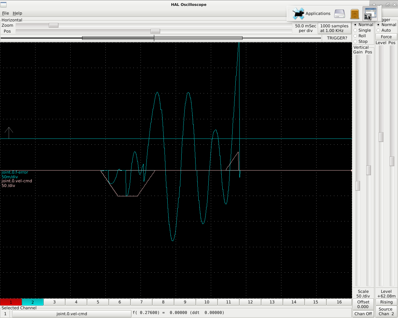

That shows something very basic wrong with the feedback
can you post the results of
uname -a
and
halcmd show all *tmax*
( run the last command when LinuxCNC has been running for at least a few minutes )
