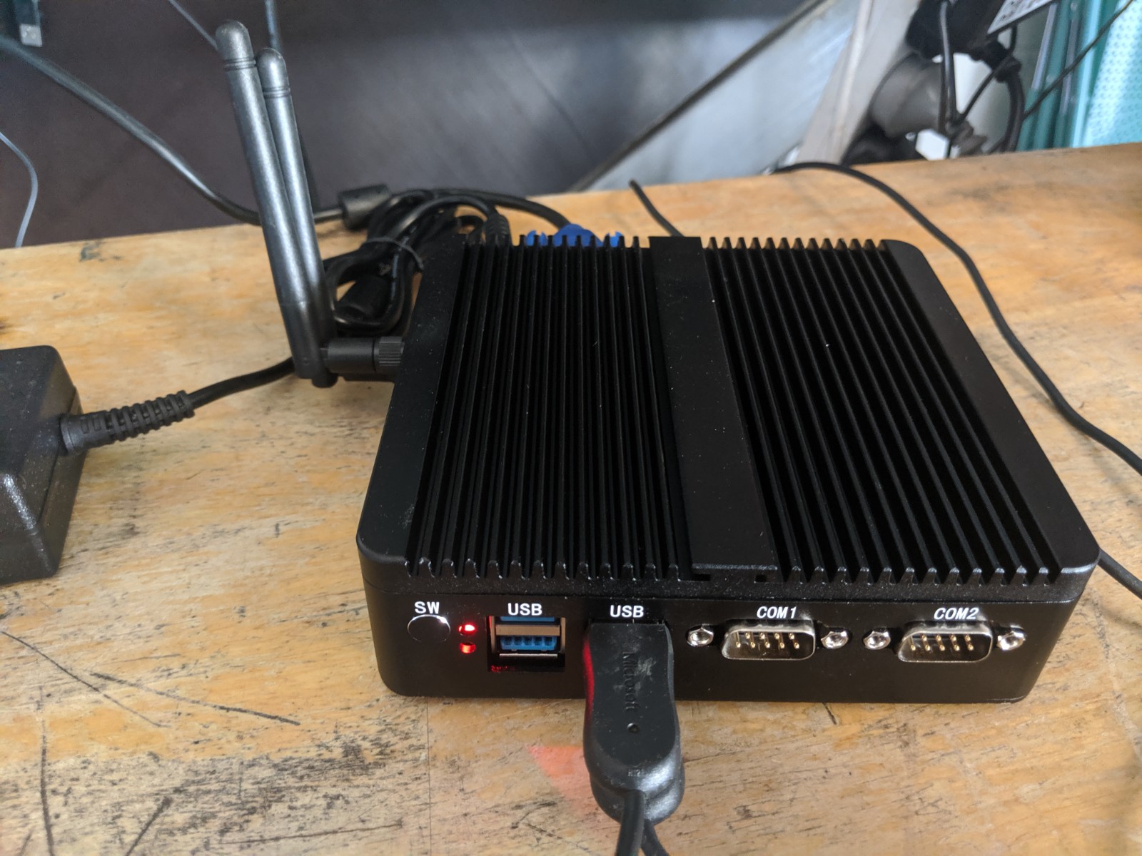

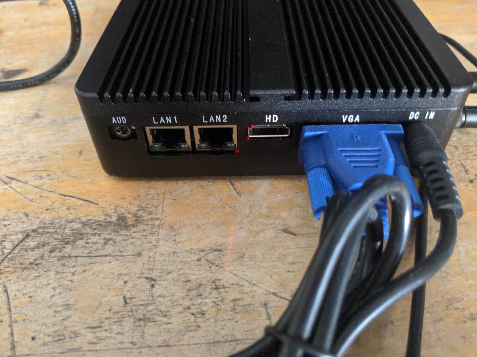

If you think the Brix has a convoluted BIOS, you should see the BIOS in the Baytrail Chipset J1900 and J1850's I have here now. They won't even boot until you spend half an hour tweaking the settings!
But the good thing is they are quite OK with latency with the inbuilt Wifi and the one that turned up this week has 2 LAN ports and 2 RS232 serial ports. So everything you need for a Mesa card and Hypertherm RS485 control.

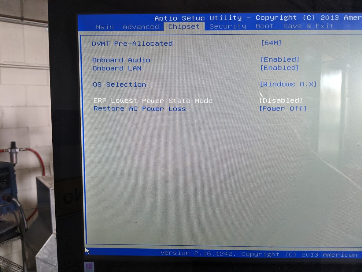

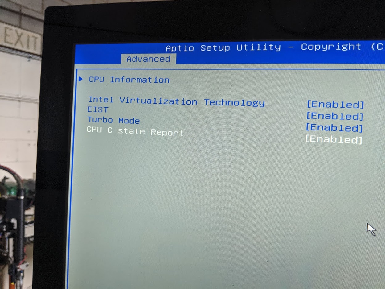

Clive, This is what I've got set
I suspect that this next setting might be worth trying as disabled but it may be affected by the previous setting. Mine is working, so I don't want to play....
25 Sep 2019 08:06 #146136 by tommylight
Replied by tommylight on topic New Plasma build question
In the first screen there is "restore AC power loss" and it is off ! Why?
I leave that ON always as i do not want to open the cabinet and push the power button, so i just turn on the machine power and the PC starts automagically !
