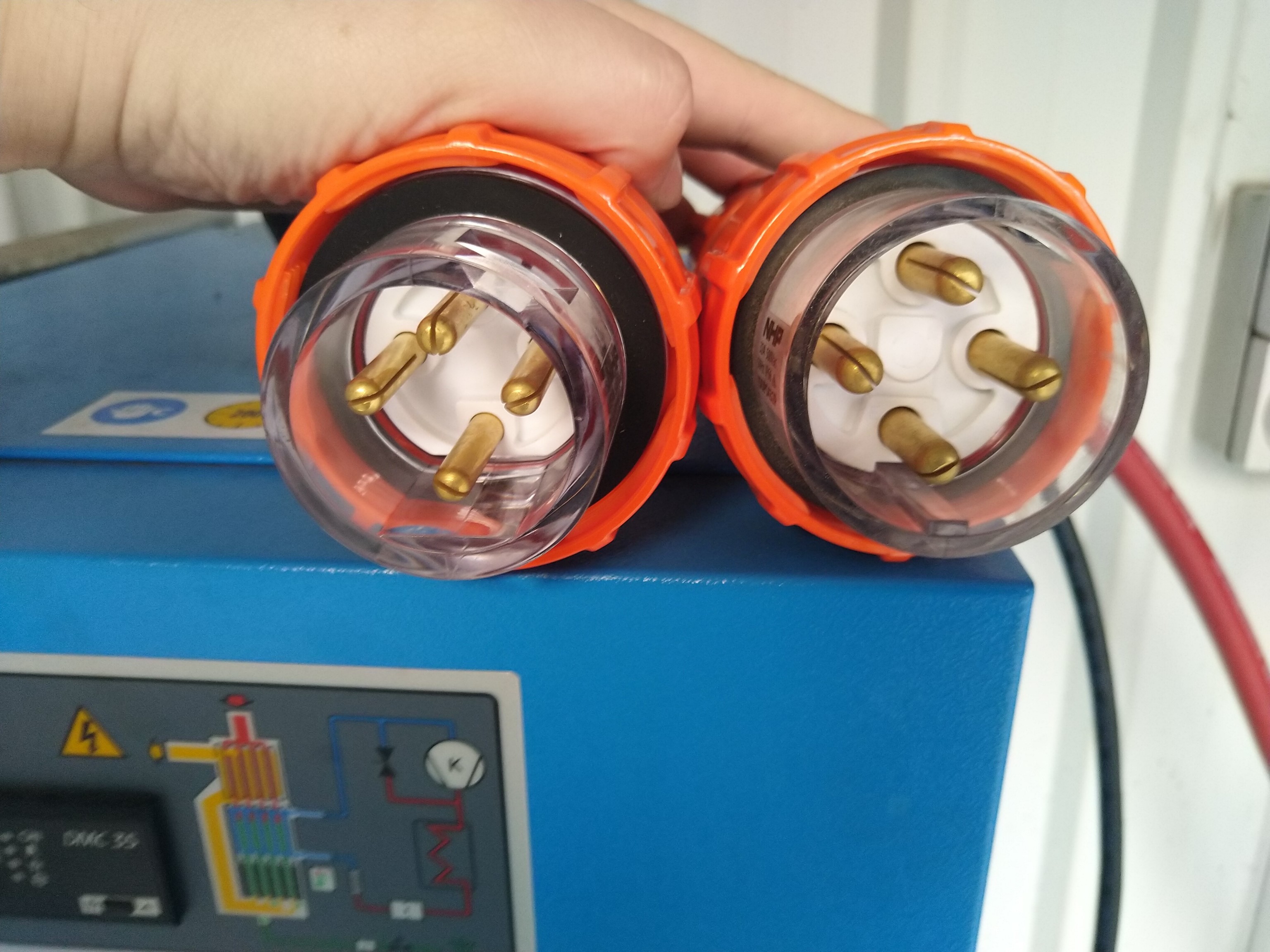

23 Nov 2020 20:59 #190144
by thefabricator03
Replied by thefabricator03 on topic Tumbler Build - For cleaning plasma cut parts.
But Tom, we are having so much fun!
Left is 20amp, Right is 32amp.

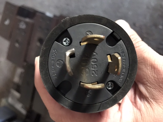

- Himarc3D
- Posts: 120
- Thank you received: 49
23 Nov 2020 22:39 #190158
by Himarc3D
The 20A dont have the pin like the 32A?
If not how you dont mistake when insert it?
In Japan follow this layout
Replied by Himarc3D on topic Tumbler Build - For cleaning plasma cut parts.
Attachment not found
- thefabricator03
- Visitor
23 Nov 2020 22:46 #190159
by thefabricator03
On the bottom of the round circular housing that plugs into the socket, there is different locators. On the right 32amp is a slot, on the left 20amp is a flat bottom. They cannot go into the wrong power point socket.
