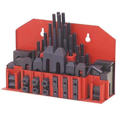

With the T Slot table that the parts to be machined sit on, can I buy them or do I need to make one? What are they called?

t slot tables can be bought but they can get expensive going that direction. as far as work holding goes you can do that may ways. most common way is vises but like i said it can be done many ways based on the type of work you are doing.
the t slot tables just act as the attaching point for your work holding. they sell basic clamping sets for the size of t slot that is on the machine.the picture below is about as common as they get. this is what is used to hold the vises to the t slot table often.

Would you recommend buying a table to suit my machine from China or should I buy some colded rolled flat bar and make my own? I do have access to a manual milling machine.
