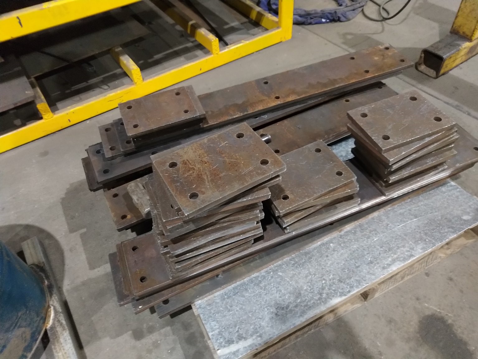

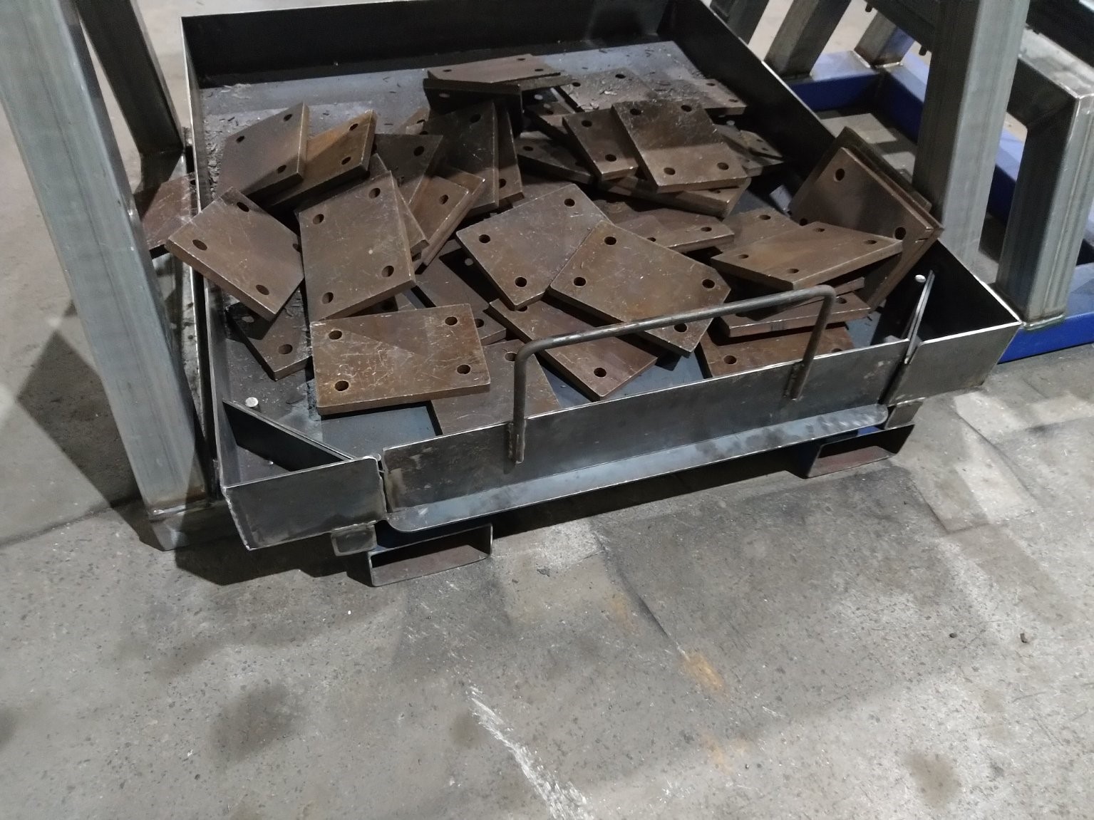

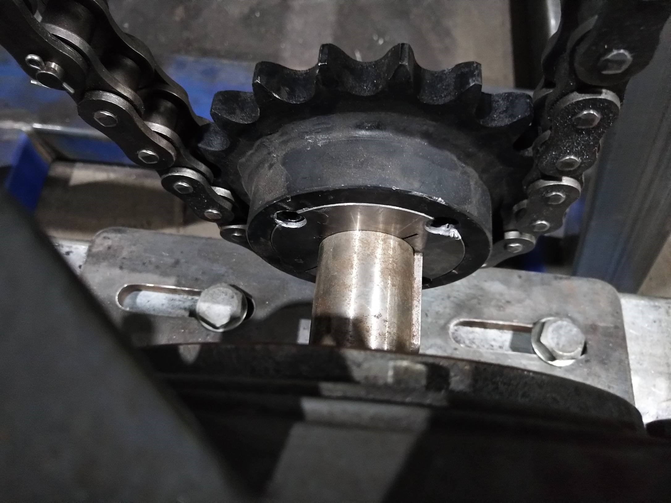

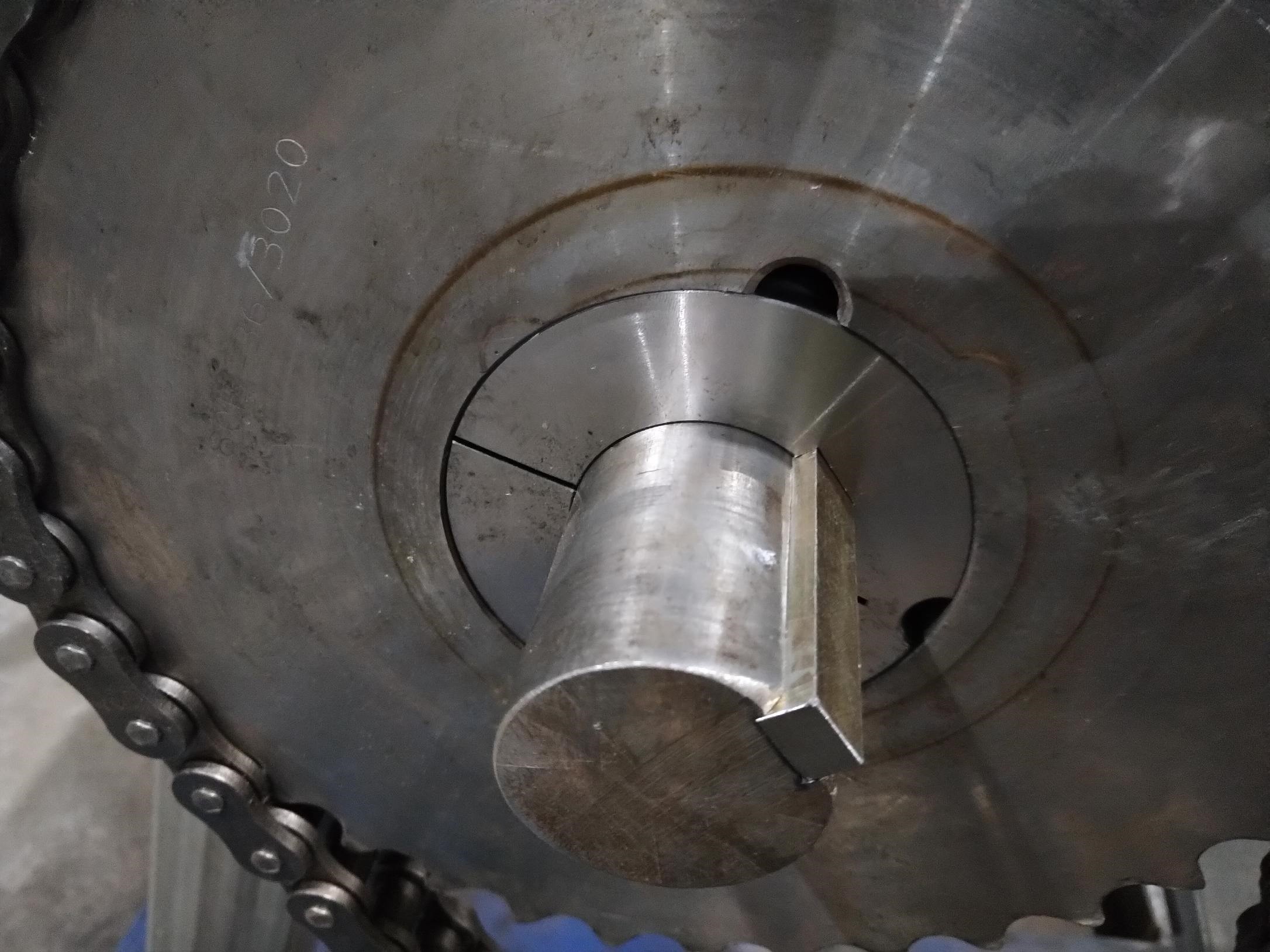

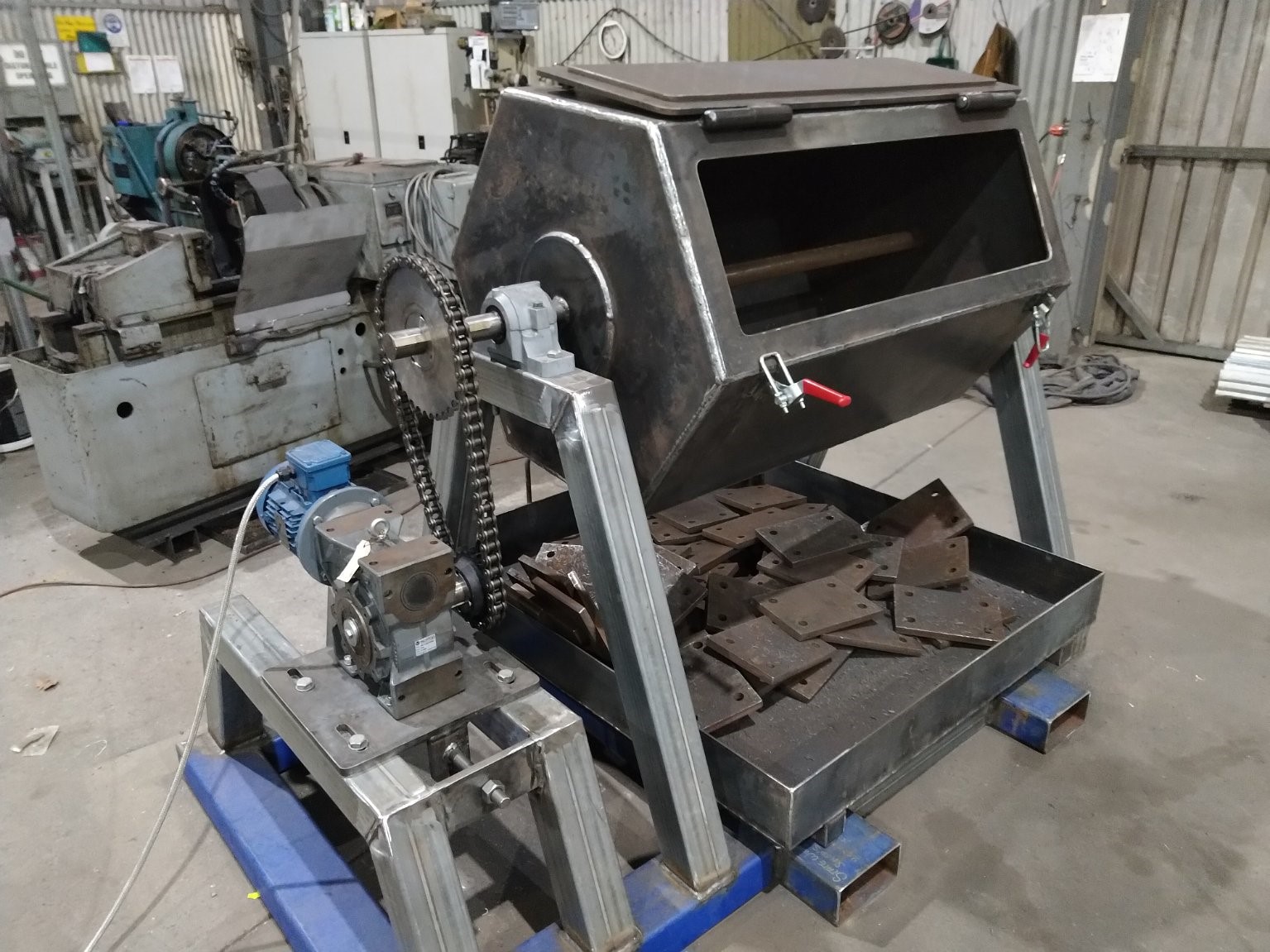

Another small update,
I had some advice that the cast iron taper lock bushes I was going to use would be prone to shattering under the impact loads the tumbler will impose. So I replaced them with tempered steel bushes. Took a while for my local bearing shop to get my parts in but they seem to work well.
Once I had my new steel bushes installed I finished off the plates I was planing on tumbling a month ago.
All tumbled without any issues. Now to finalize the enclosure design. Also the VFD makes this a breeze. I would hate to try to do this with a normal on/off motor. The Jog function alone is worth the cost of the VFD let alone the speed control.

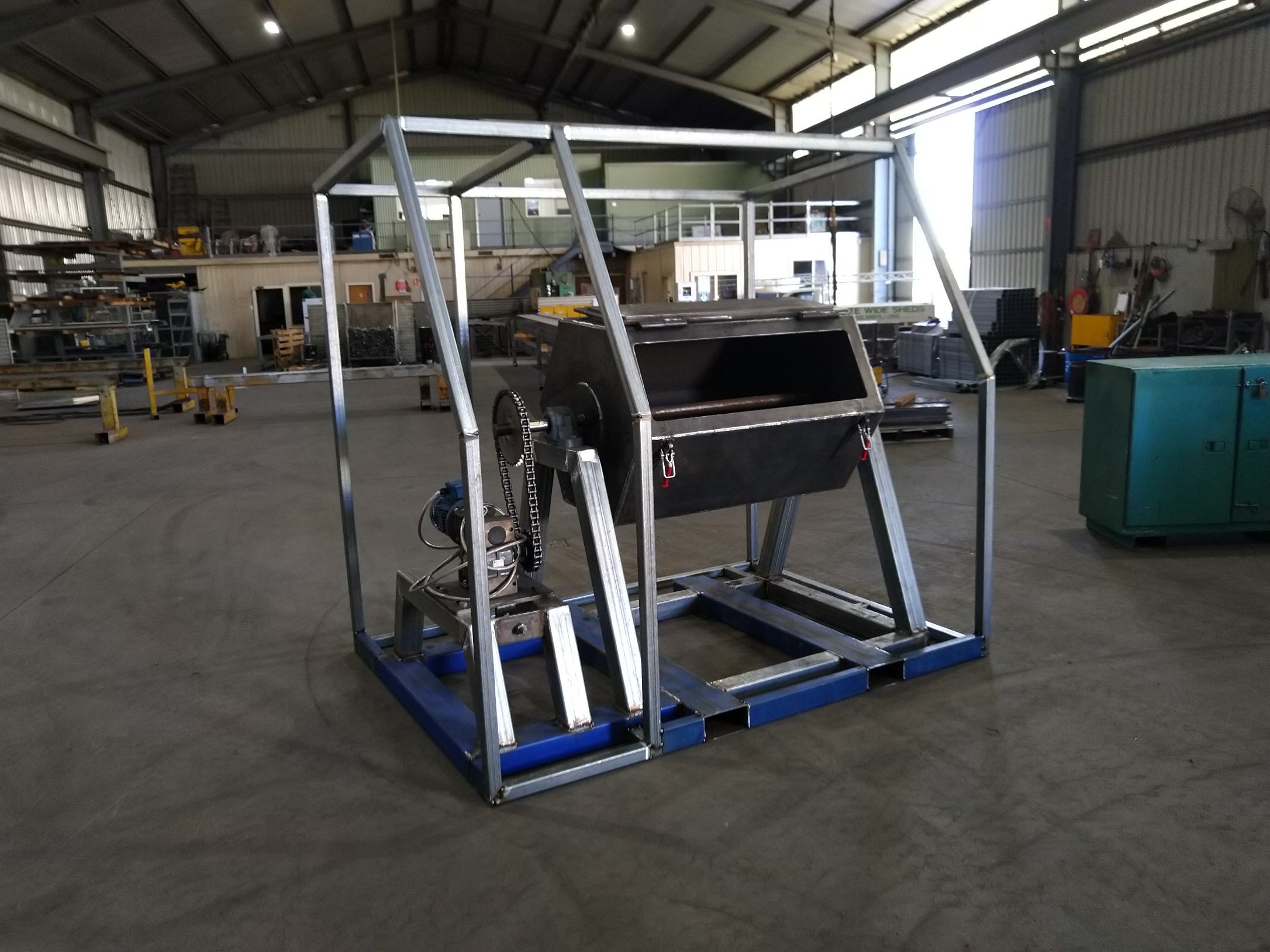

04 Jul 2020 04:10 #173581
by thefabricator03
Replied by thefabricator03 on topic Tumbler Build - For cleaning plasma cut parts.

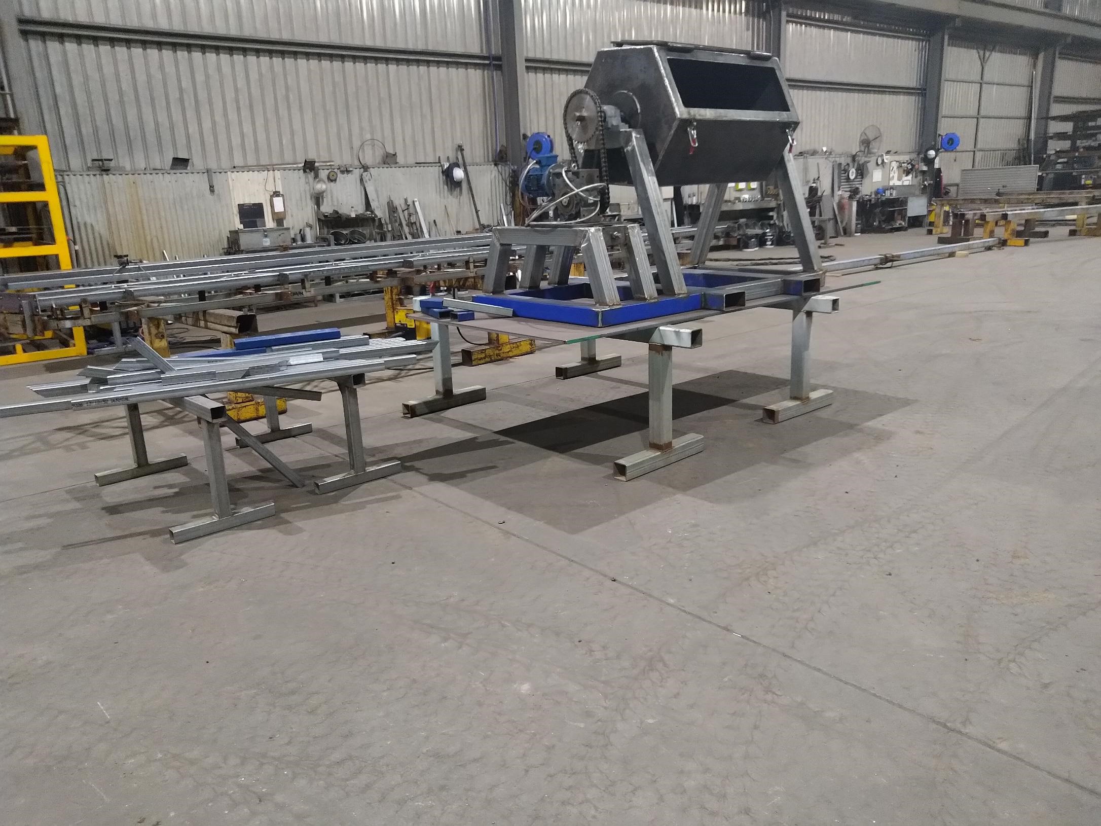

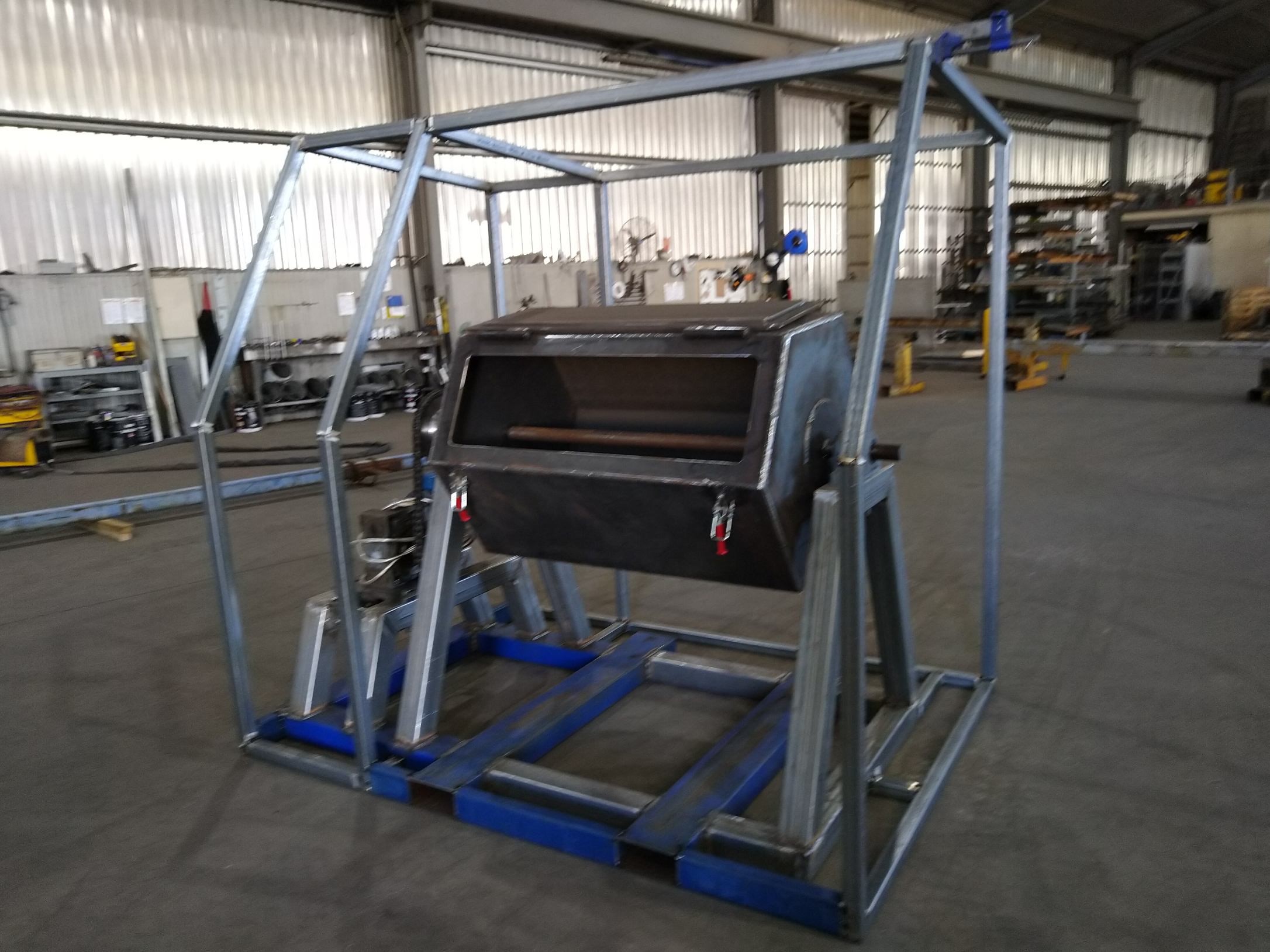

Frame coming together,

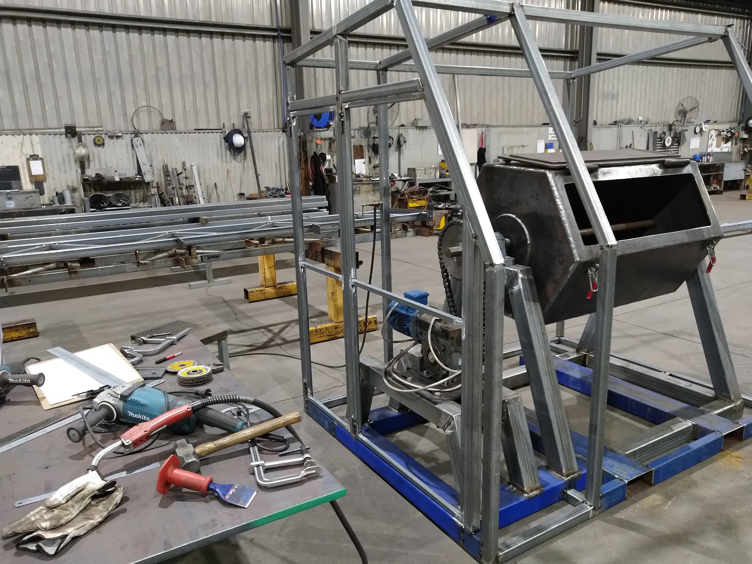

04 Jul 2020 08:00 #173588
by thefabricator03

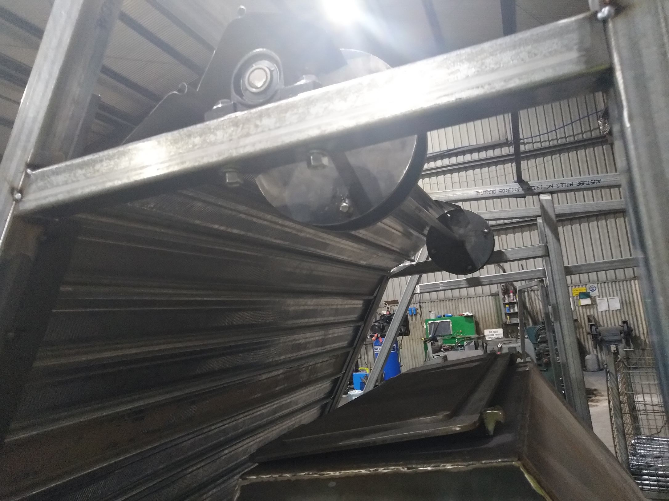

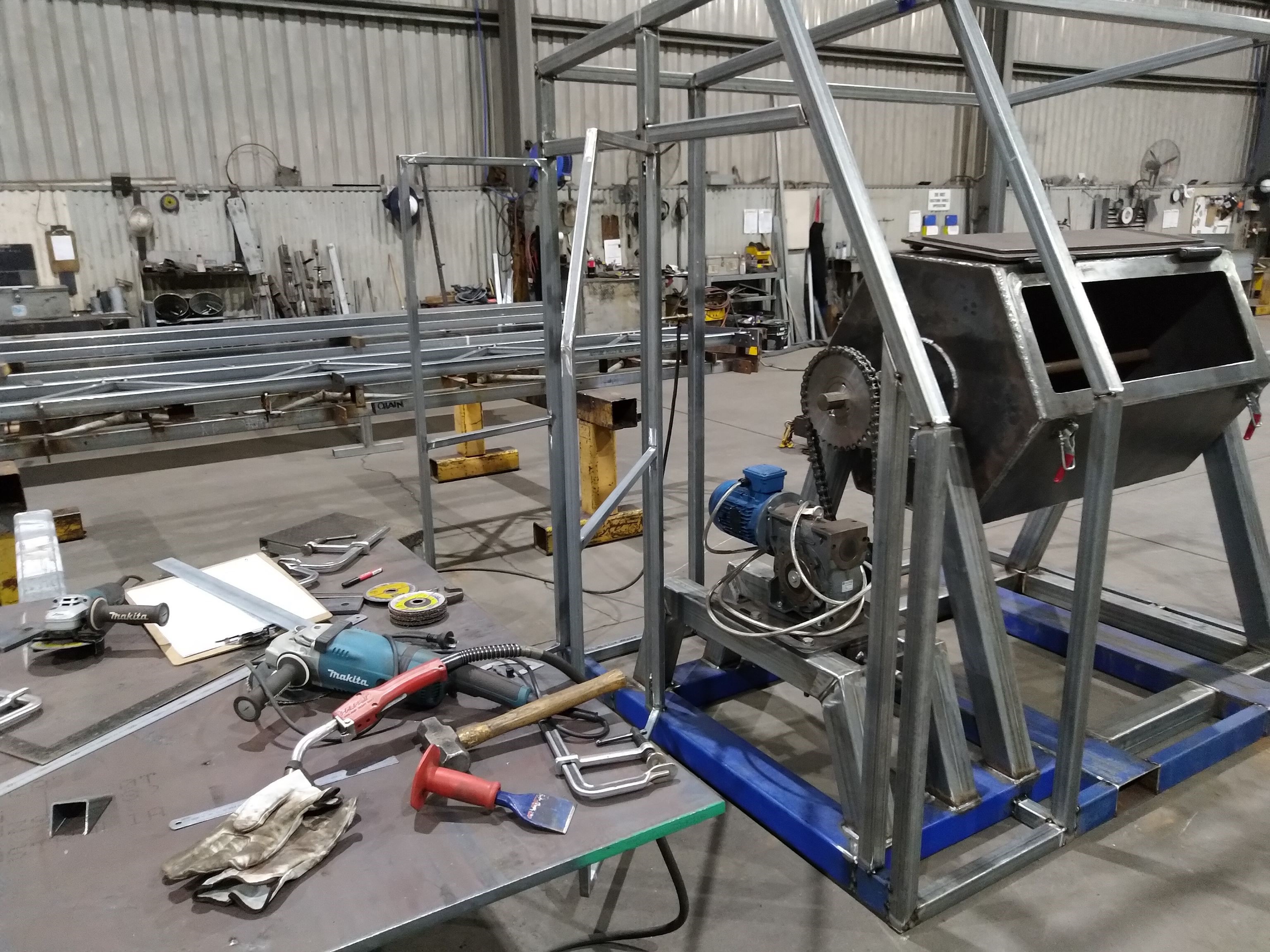

Motor compartment access doors,
- machinedude
- Posts: 715
- Thank you received: 312
04 Jul 2020 10:39 #173593
by machinedude
Replied by machinedude on topic Tumbler Build - For cleaning plasma cut parts.
so what's the plan with outer frame? are looking to add sound dampening material to keep noise levels down? or protection to put the whole thing outside? or is this just to act as a guard to keep people safe
i would imagine with employee's you need some kind of guarding in place to keep safety police happy.
- thefabricator03
- Visitor
04 Jul 2020 11:51 - 04 Jul 2020 11:52 #173600
by thefabricator03
Yeah I will sheet the frame and put it outside up the back of the yard. And yeah it has to be safe so I need to limit the area that is exposed to safety hazards. The plan is to tumble parts only when the door is closed.
Last edit: 04 Jul 2020 11:52 by thefabricator03.
- machinedude
- Posts: 715
04 Jul 2020 13:51 #173605
by machinedude
probably need a safety interlock on the doors so the motor disables if the doors open up i would think too. safety concerns when you have employee's is probably going to take the build to higher safety standards.
- thefabricator03
- Visitor
05 Jul 2020 01:53 #173643
by thefabricator03
Yeah I have some limit switches I plan to use a safety interlocks on all the doors.

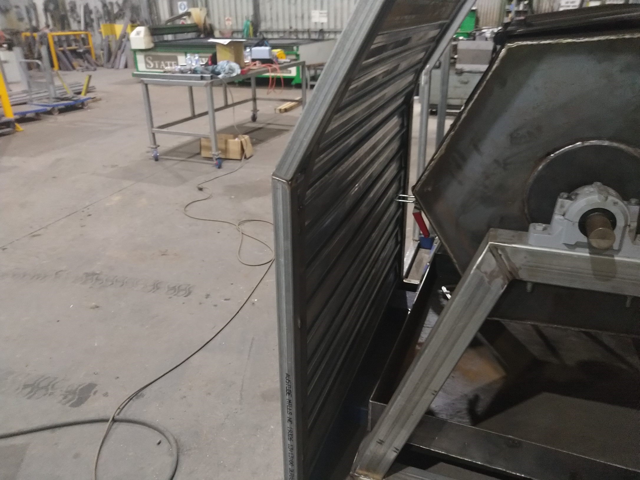

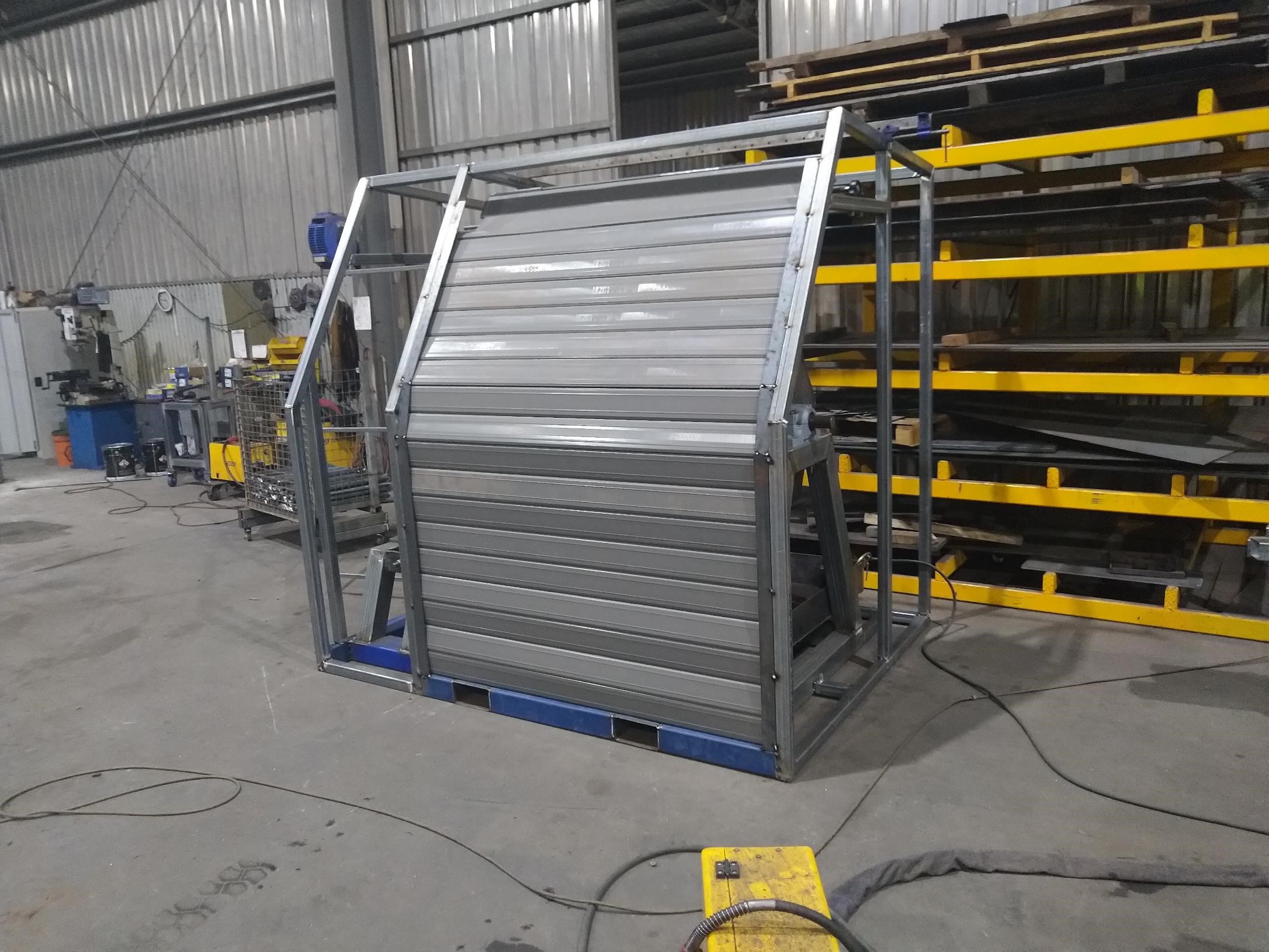

12 Jul 2020 09:44 - 12 Jul 2020 09:46 #174369
by thefabricator03

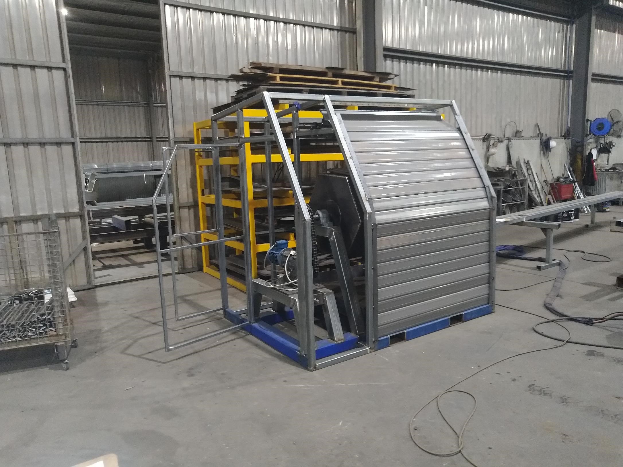

Todays work,
Installed roller door.

12 Jul 2020 10:04 #174372
Replied by tommylight on topic Tumbler Build - For cleaning plasma cut parts.
I have to say it, you do some magnificent work that deserves utmost respect.
