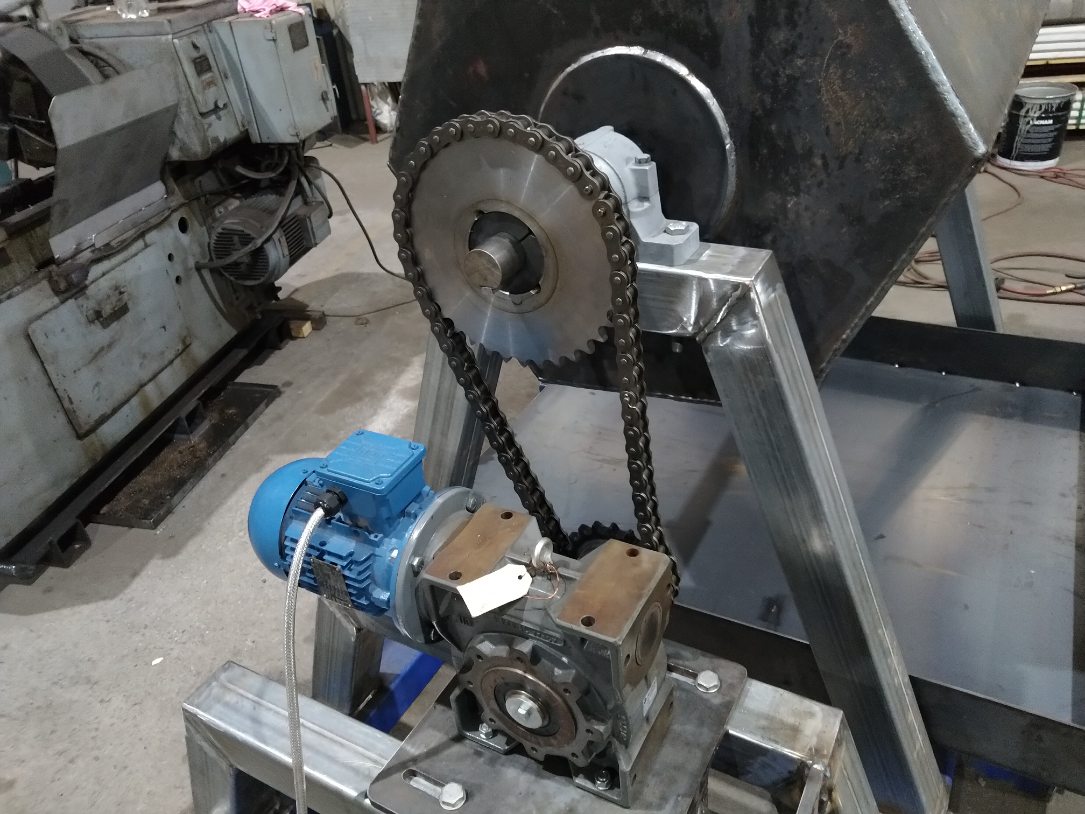

by thefabricator03
Replied by thefabricator03 on topic Tumbler Build - For cleaning plasma cut parts.
If I add a chain guard it will take away the excitement of getting caught up in the chain
Next step is to finish the design of the enclosure and the setup for adding and removing parts quickly.

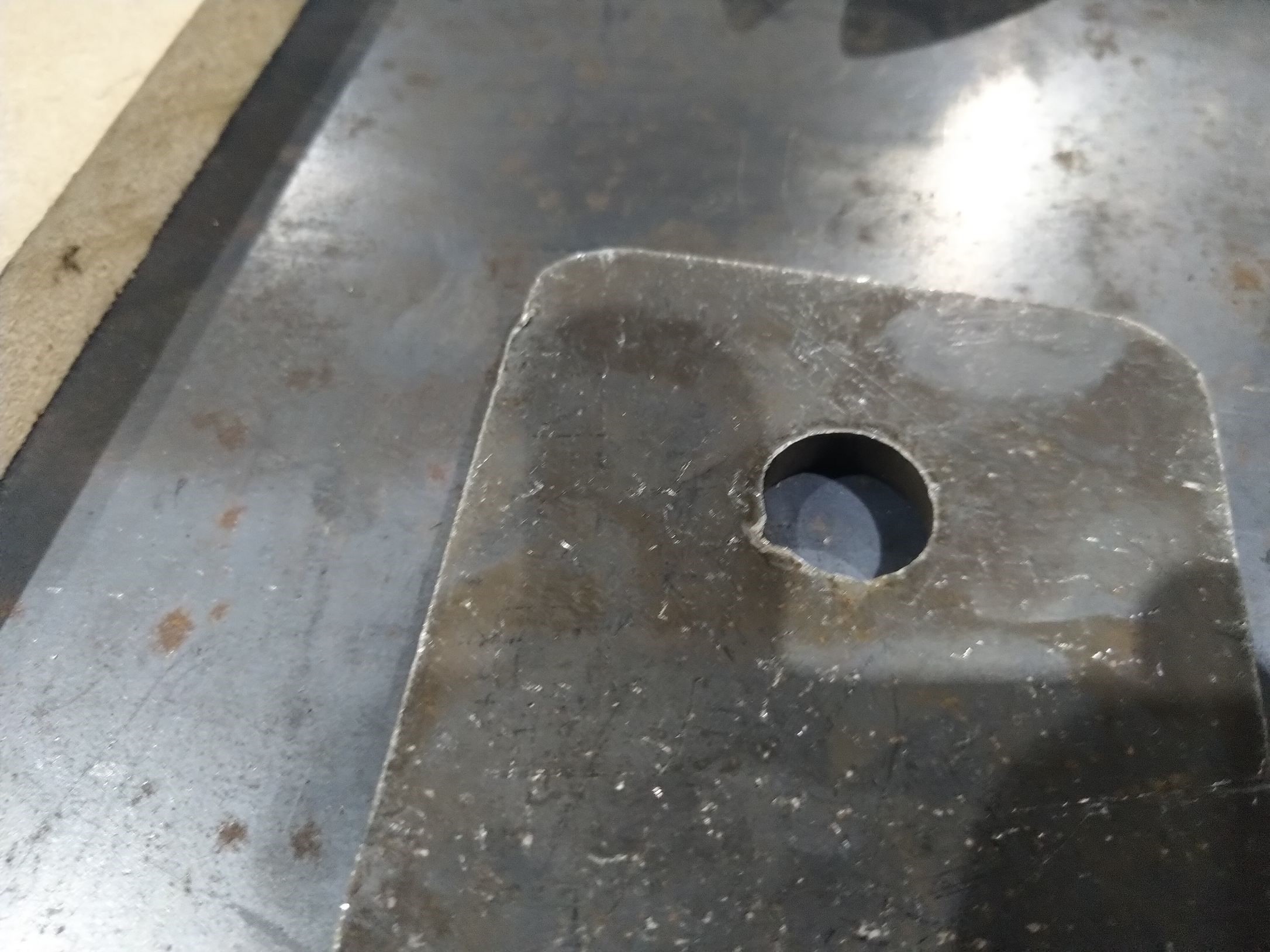

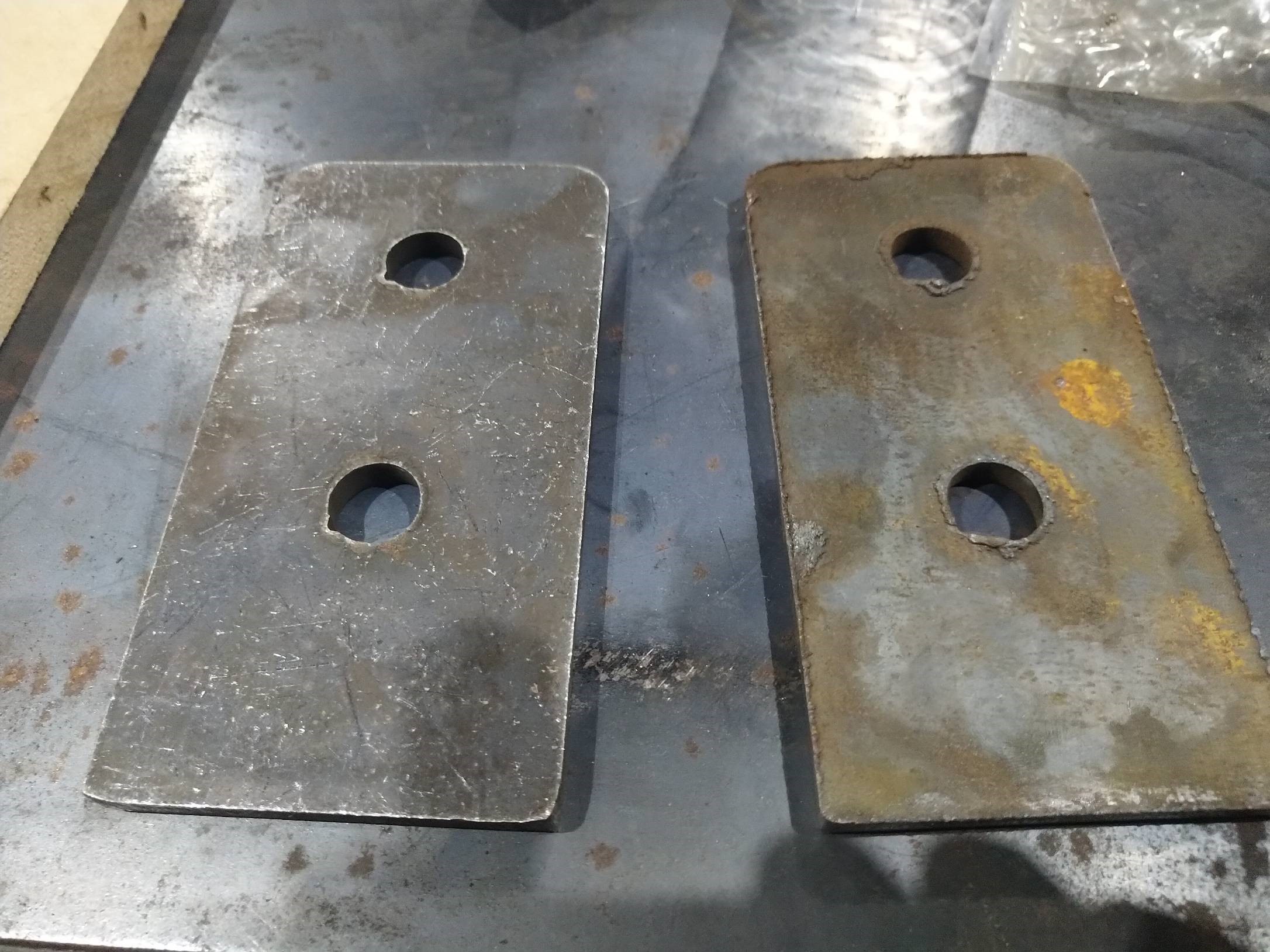

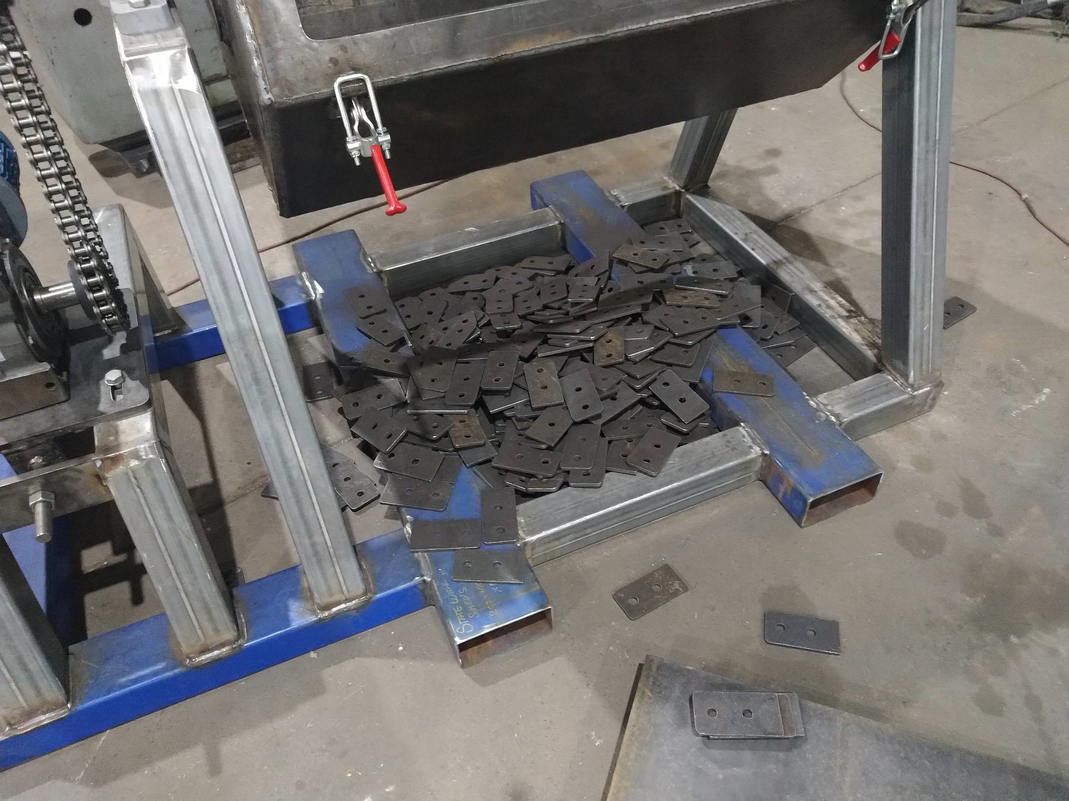

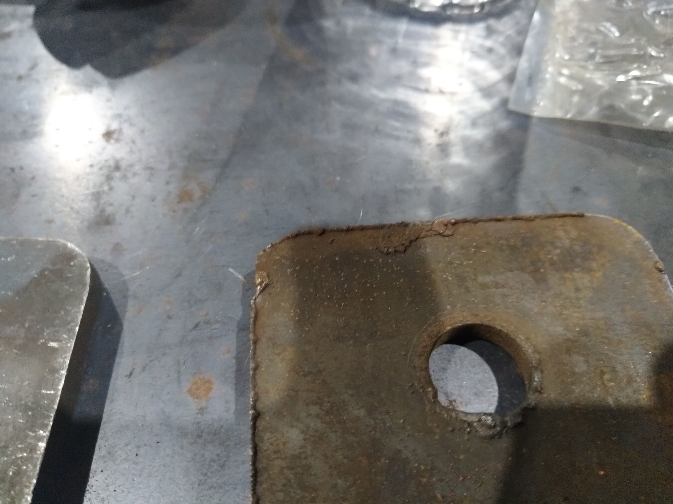

27 Apr 2020 07:55 #165762
by thefabricator03
Noise level was not what I was expecting. I tumbled the parts for about 1 minute inside the shed without ear protection and its not much louder than my guys working.
Not quiet but bearable.
Also was not expecting the parts to be ready after one minute. Ill play around with the next couple of batches and record my results.

27 Apr 2020 09:00 - 27 Apr 2020 09:01 #165768
by thefabricator03
Yeah my guys will be happy. Saves chipping the dross off with a chisel. I get nearly 400 of those cleats to a sheet. They all cleaned up so easily. Very Very Happy with the results.
That saves a lot of work, a lot ! Now you got me thinking i need one, and i do not cut, yet!

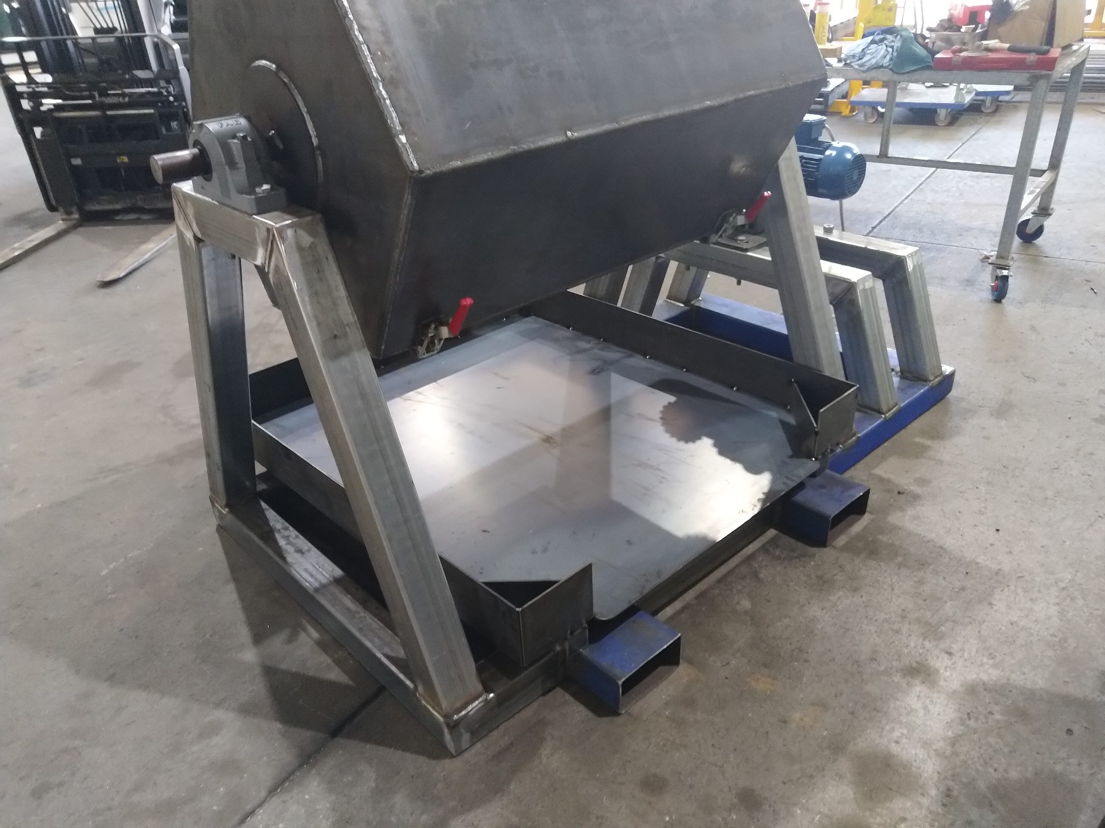

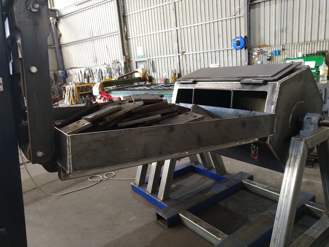

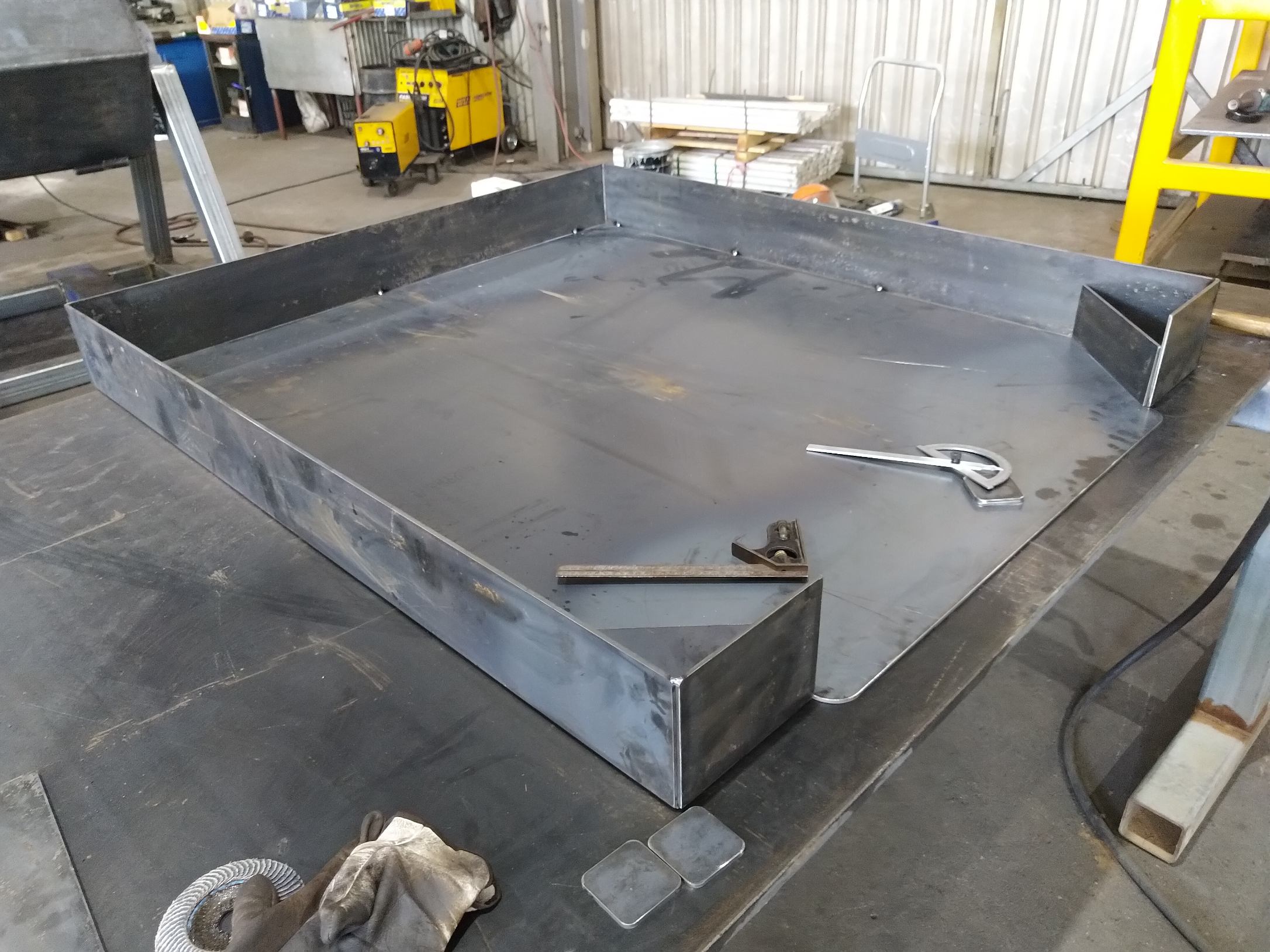

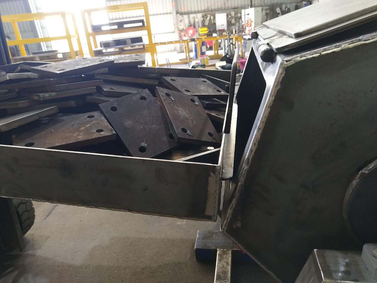

Update:
After some testing I decided that 25 RPM was too fast for the 900mm diameter drum. I have put on a 36 tooth sproket which will limit the top speed to 16 RPM. it also multiples the torque by 1.8 to give 1008Nm at the shaft.
Part tray with removable front gate. The plan is to butt the tray up to the drum and the lip of the tray will sit into the opening. I will then remove the gate and push the parts in. I have not tried it yet as I need another chain link.
