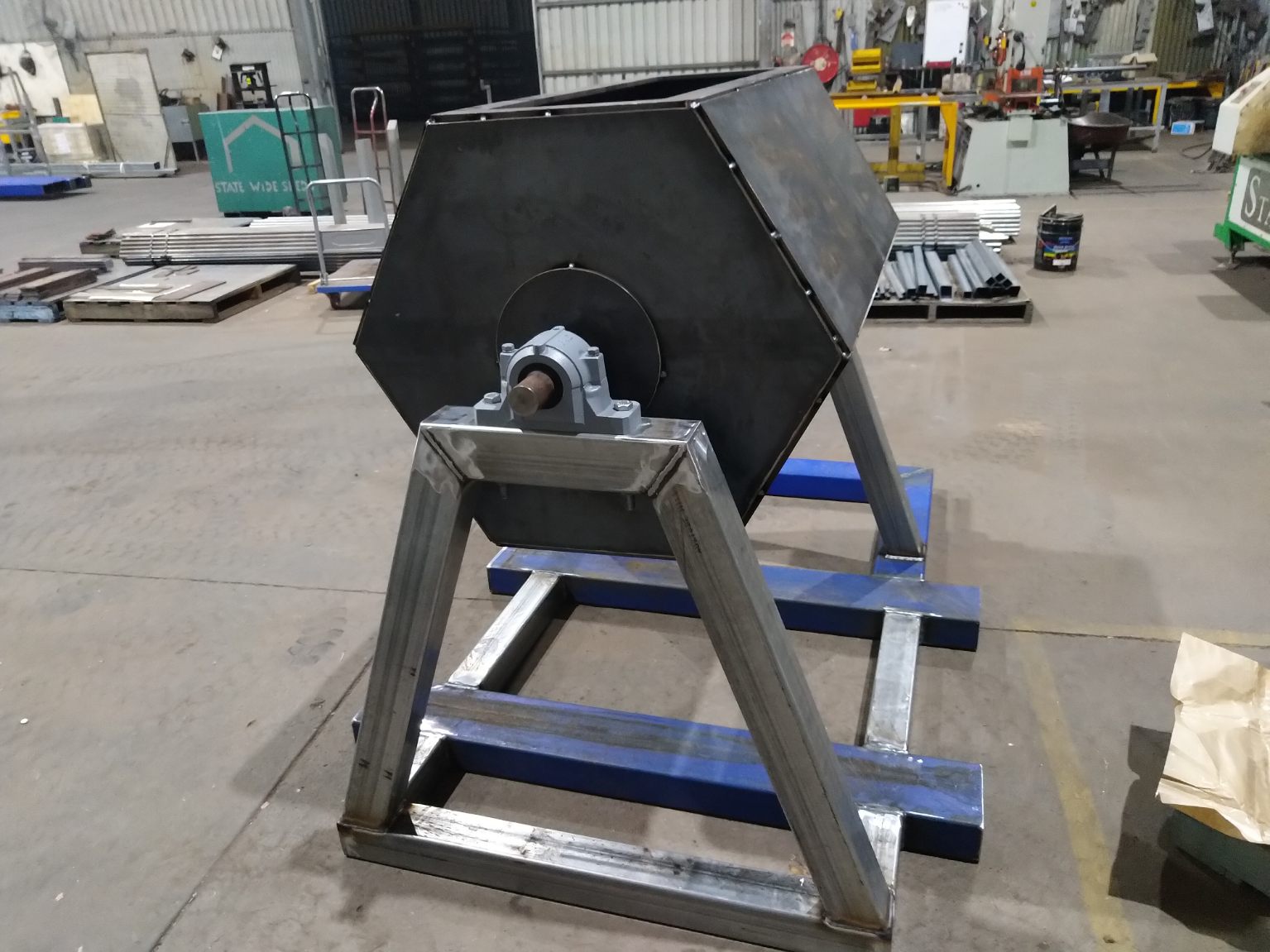

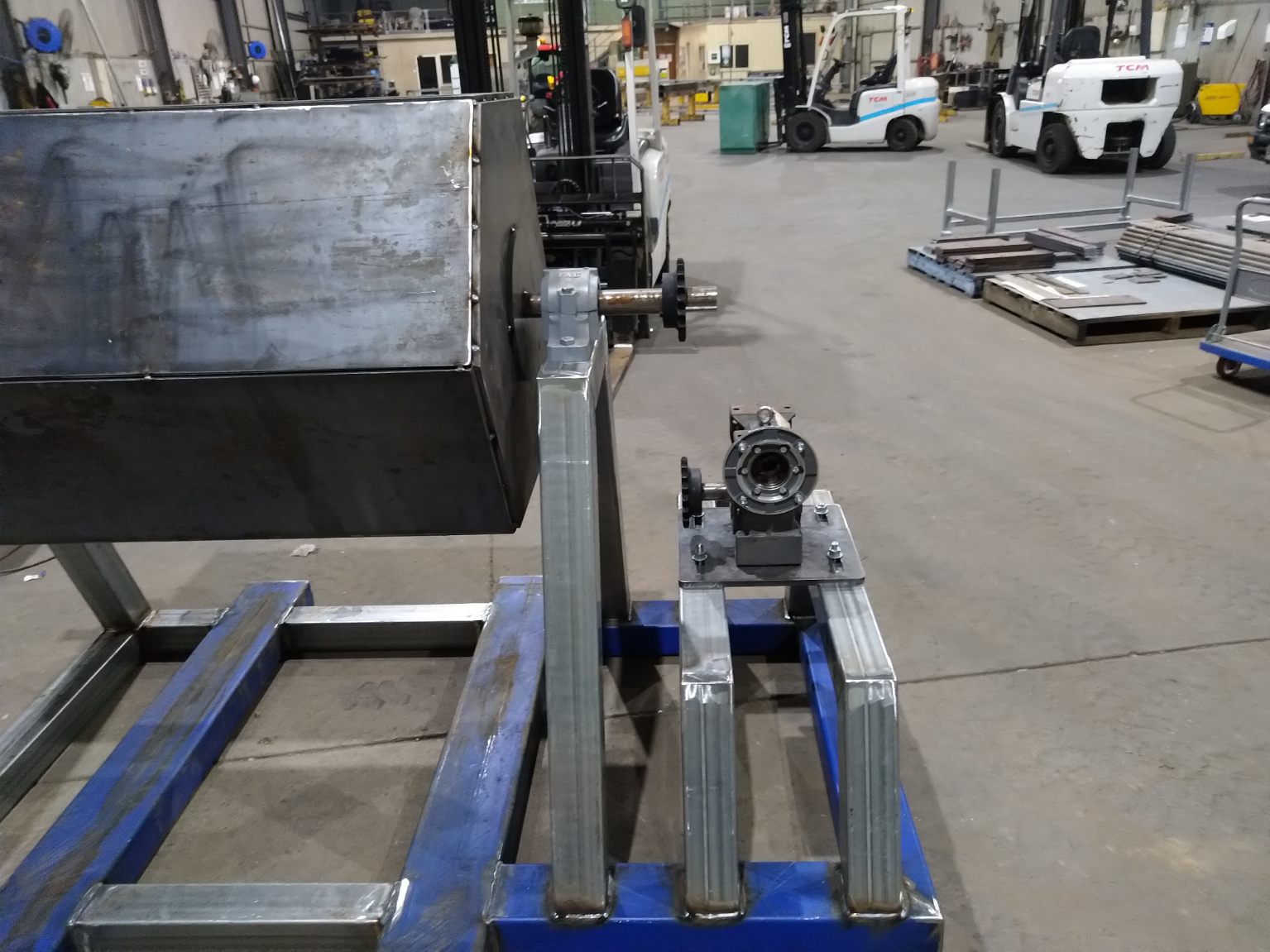

13 Apr 2020 09:15 #163858
by thefabricator03
Replied by thefabricator03 on topic Tumbler Build - For cleaning plasma cut parts.
Attachment not found
- Posts: 12161
- Thank you received: 4151
13 Apr 2020 09:29 #163859
Replied by rodw on topic Tumbler Build - For cleaning plasma cut parts.
Looking good Stefan!

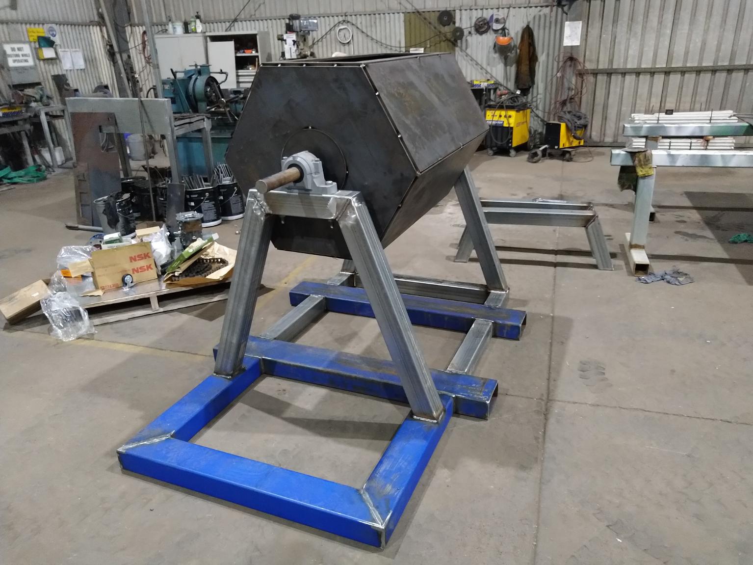

- thefabricator03
- Visitor

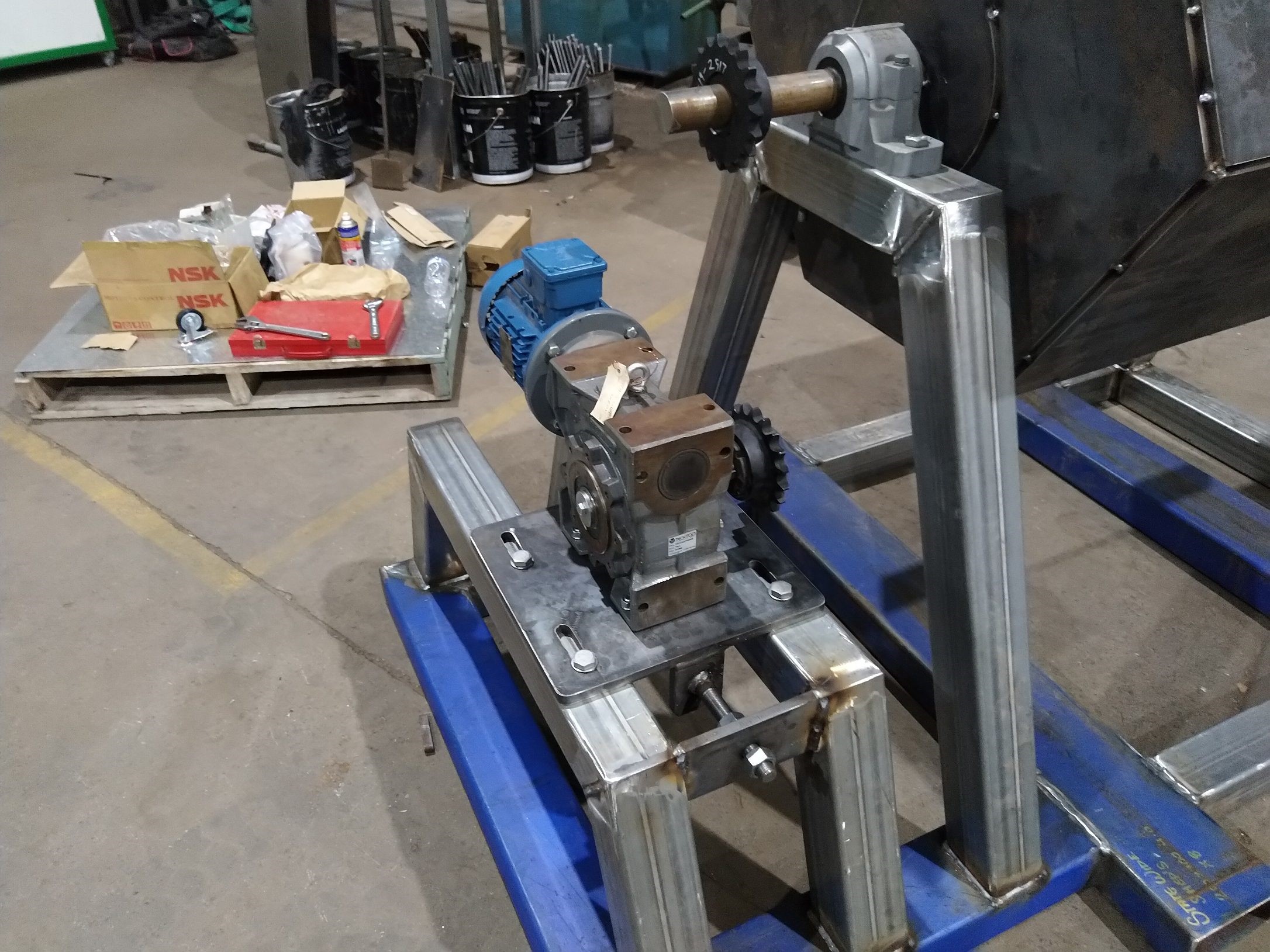

14 Apr 2020 13:13 #163947
by thefabricator03

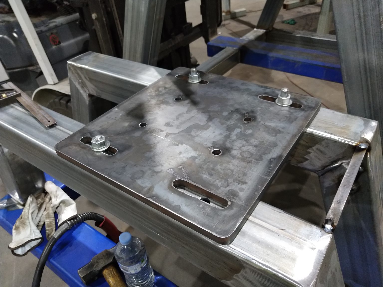

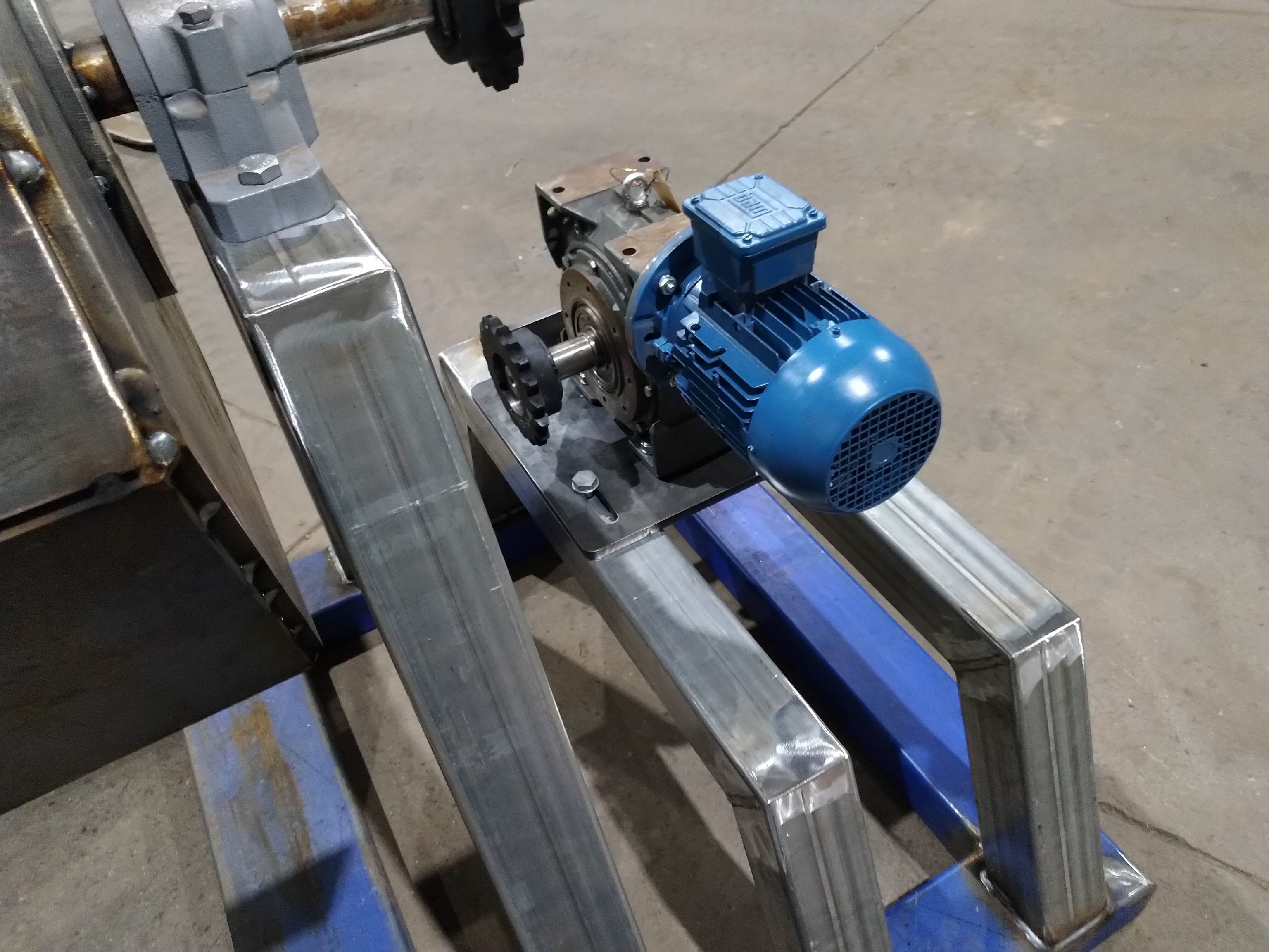

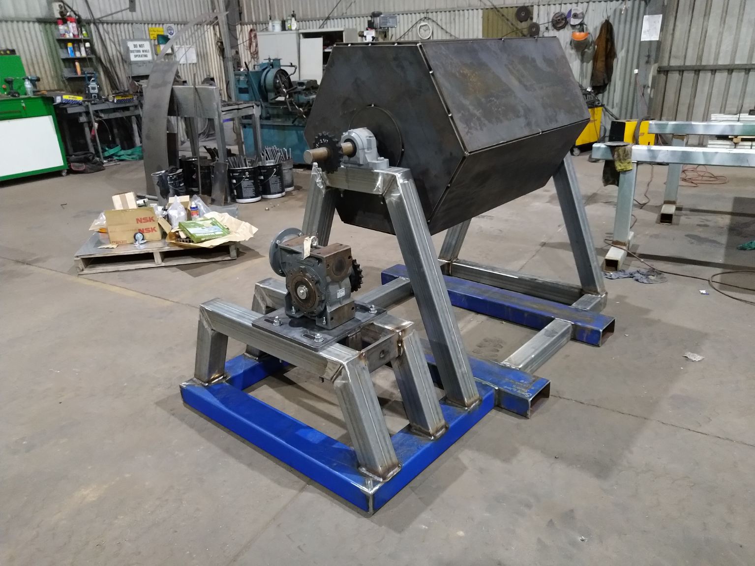

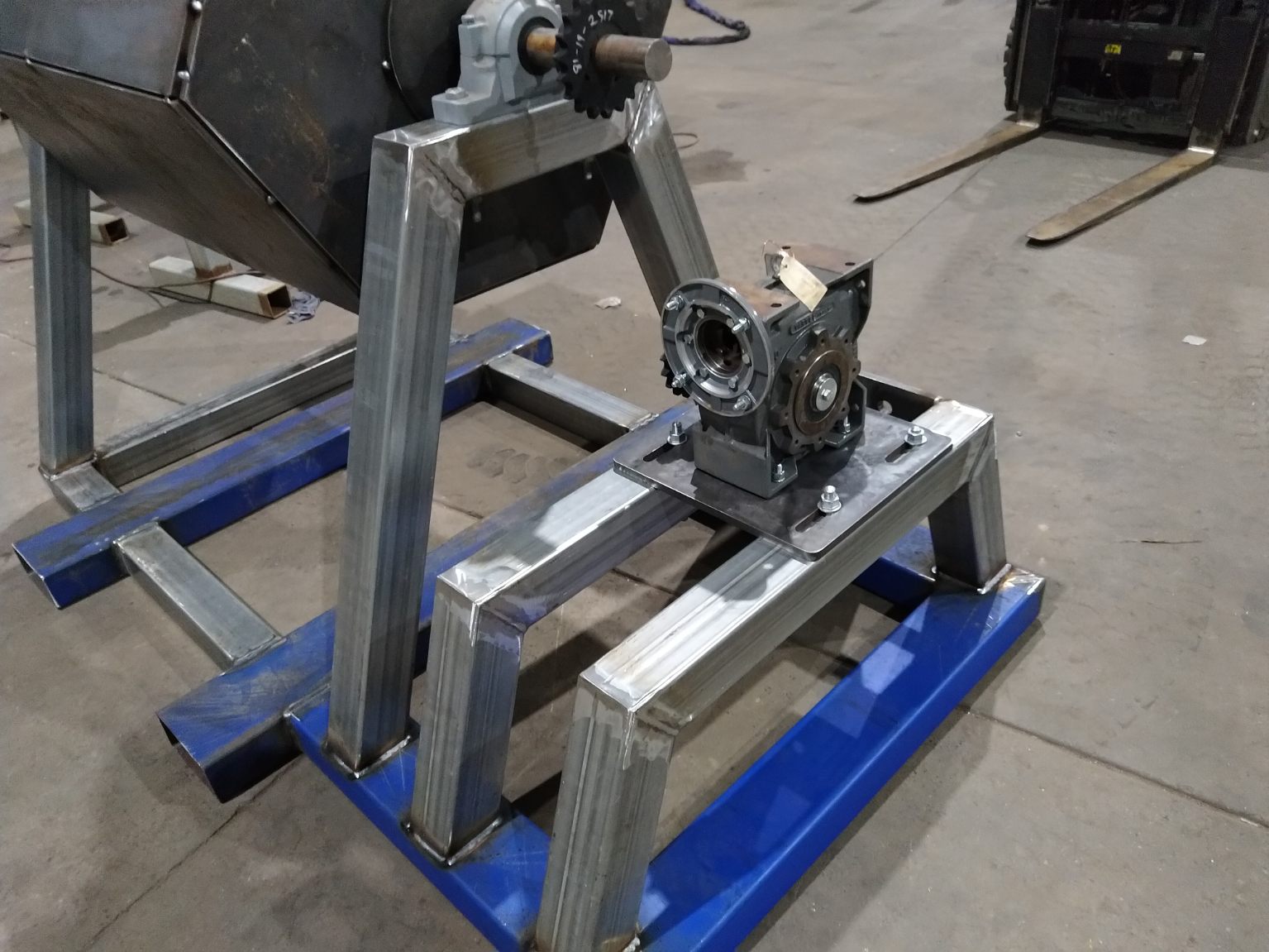

15 Apr 2020 08:29 #164032
by thefabricator03

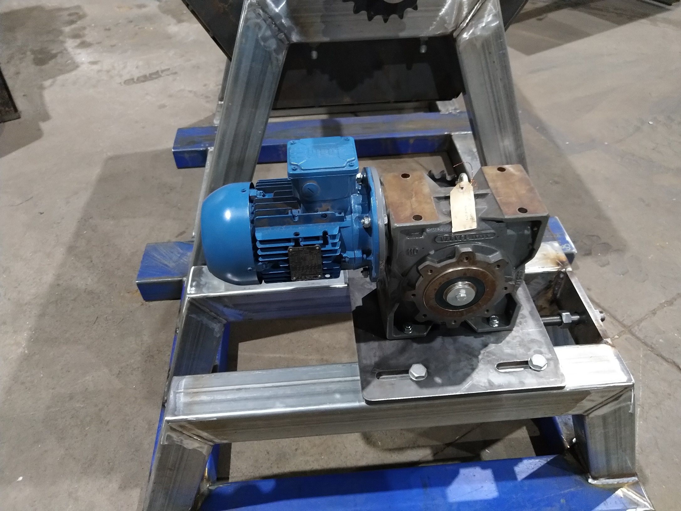

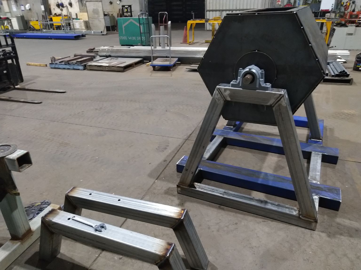

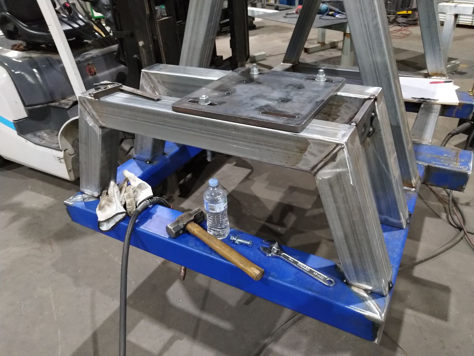

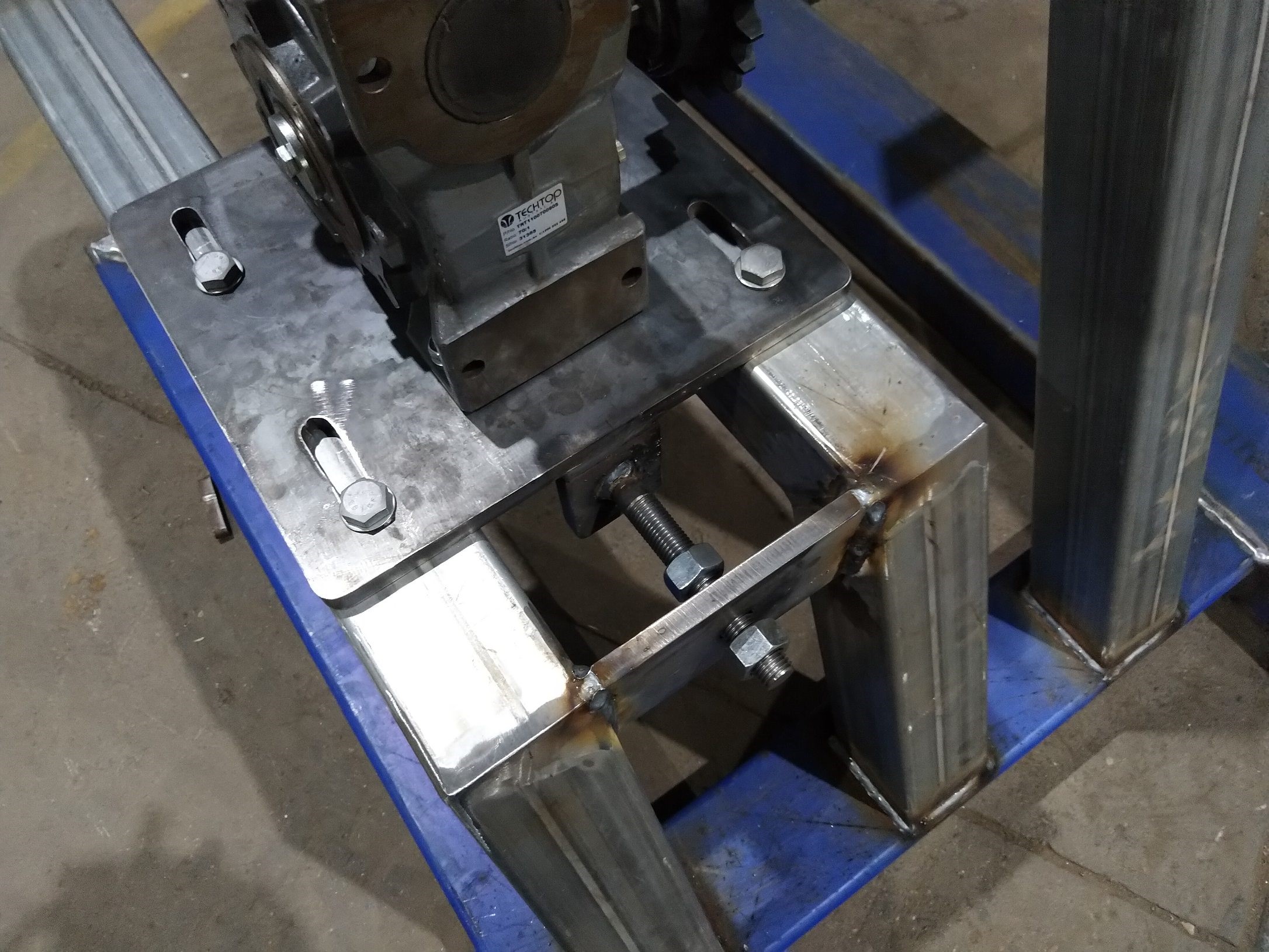

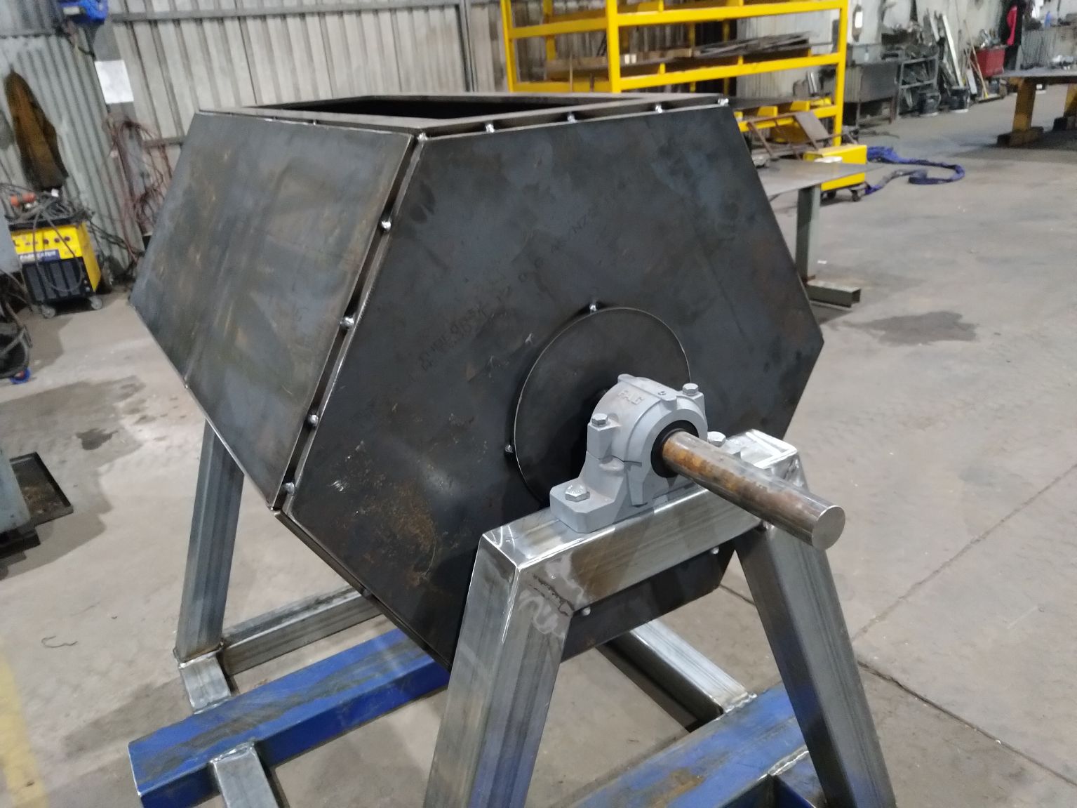

Small Update.

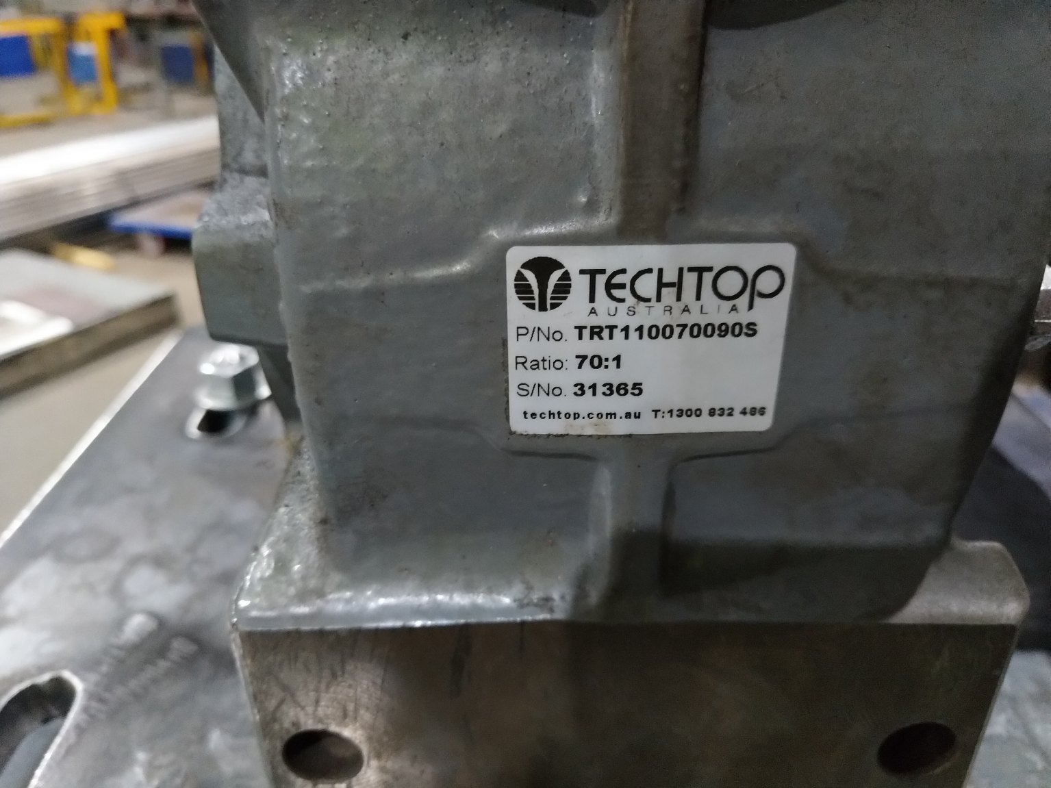

I do have 2 of them here collecting dust, as luck would have it, yesterday i was reading the manual for the Dinverter one (3X380-480V, 2.2KW) and it can do RS485 AND RS422 !!! Nice, will have to mess more with it later on.
Some general tips:
Since it is going to be moving heavy stuff, set the spin up delay to 1 or 2 seconds, and spin down to 2 or 3 seconds.
Try to keep it around 50 or 60 Hz as normal motors will not like faster rotation and will eventually wear the bearings.
Some new VFD's have an Auto Tuning feature, use it if you can, it can greatly improve efficiency, hence less heat and strain on the motor.
Worm gear is the best choice for use in this case as it does not allow the constantly changing load to impact the motor, making it slip while rotating.
Get a simple adjustable timer, so you do not have to wait for it to finish, thank me later.
Almost all VFD's have inputs for a motor thermistor, find one and strap it to the motor, in case something gets stuck inside of the tumbler causing more load, it will save the motor from going up in smoke.

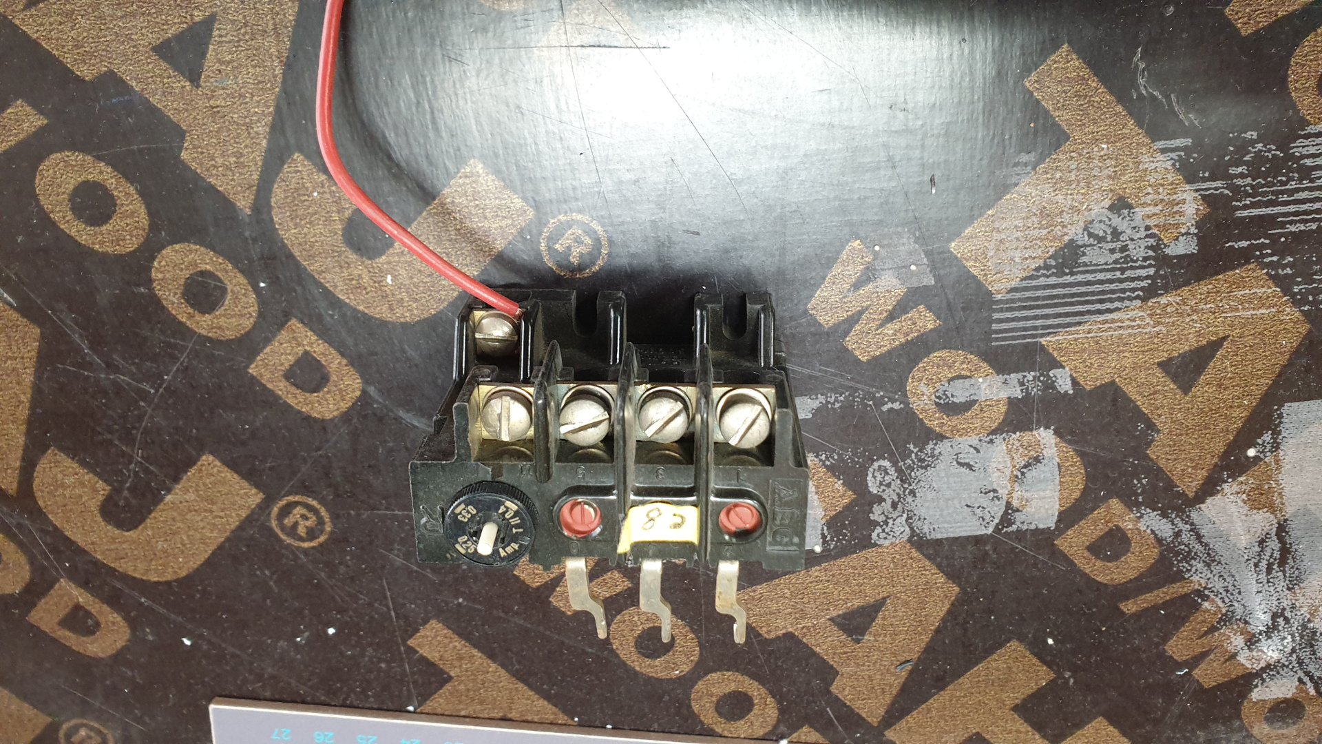

15 Apr 2020 12:01 #164055
Replied by tommylight on topic Tumbler Build - For cleaning plasma cut parts.
It can also be done without a VFD, just find a thermal fuse, 3 phase. It will work, but you loose the ability to adjust the speed ( although some motors can do 2 speeds depending on if wired as star or triangle ).
I do have some of the those thermal fuses here, they are made to be attached to the relay directly and and can save the motor if any of the phases get loaded more than it should. They are all adjustable as to the current they will trip.
